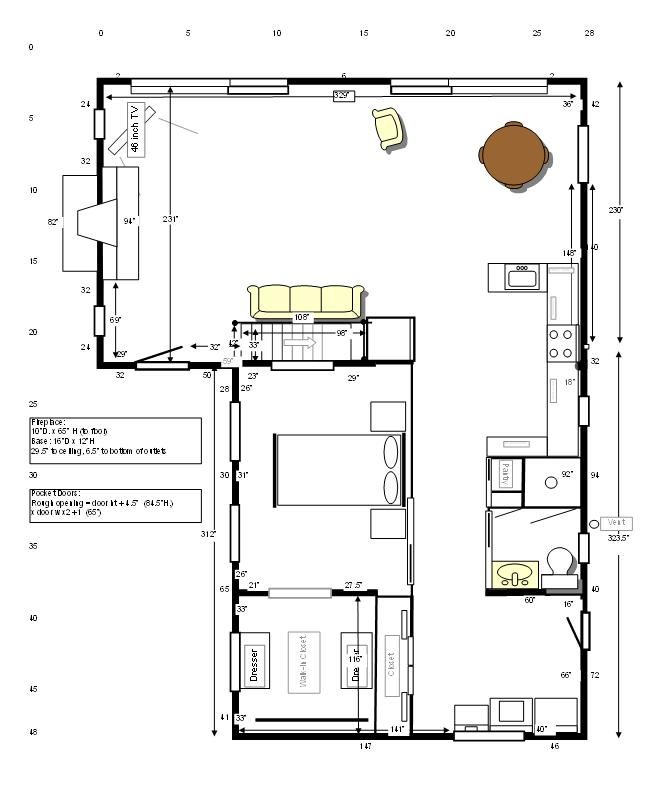

My wife wants radiant floor heat in our cottage so I'm going to humor her and pretend to consider it
I currently have a working standard cast iron boiler, copper fin tube baseboard system. The cottage is divided into 3 sections:
One end on a slab that will eventually be the laundry/mud room/closet space.
Center is over an unconditioned bare dirt crawl. Some excavation via buckets would be required to access the bottom of the floor boards.
Other end is over a basement.
New flooring is needed throughout so this opens up the possibility of installing the tubing above the existing floors. What are the cost/efficiency/comfort trade-offs of installing below using reflectors vs. above using those grooved panels?
Would such a retro-fit be a budget-breaker? We only go to the cottage a few weekends during the winter so heating efficiency isn't a big concern but keeping the existing boiler is important to keep costs reasonable.
Main reason I'm even considering doing this is I hate needing to design around/work around/decorate around baseboards.
