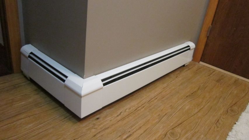

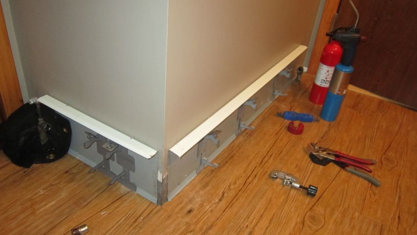

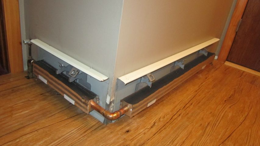

Here are some pics of my finished DIY. No more having to look at those nasty things messing up my nicely self-renovated full-bathroom.
I realized that after I cut off the cup end of the copper pipe in the element the fins pretty much slid off after pinching two or three at a time. The fins are almost razor sharp so good gloves should always be used when working with them.
I used a 3/4 close-quarters tube cutter from HF to remove the old elements while leaving a couple inch nub. I heated that puppy up to desolder it pull it apart, clean and then size/install the new elements.
I cut the steel baseboard and cover pieces with Weiss aviation snips and and smoothed them out with a small Dremel clone and fine sanding block.
[NOTE: In the middle picture the brackets and saddles were not all properly situated yet]
off to the next project
You just KNEW I was gonna 'call you out' on that, didn't ya?
Excellent... looks very nice!
