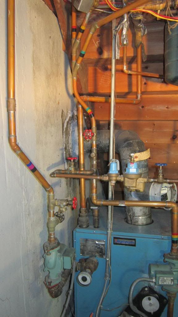

I have a bunch of pics that are in high-resolution posted in the album linked below of our 5 zone system. I would like to complete this job with my own hands if someone could offer me the proper steps for this process.
I am replacing a baseboard and heating element in the top level of a two story + unfinished basement level house. To do that I will need to drain the baseboard/zone of water.
The zone I am working at is connected to valve labeled R(red)#1 in my pics. It has a cap for a hose connection. I can provide any other relevant info or more pics when requested for the complete process of draining, refilling, and bleeding.
I'd like to get to it later this week one way or another, if I can. I'm prepping for it now.

First off... since you will be depressurizing the system it would be a fine time to perform some very likely needed maintenance tasks.
Read these two threads... the first has instructions for checking/charging the air in the expansion tank, which by the looks of it is at least 25 years old. The second is an easy way to verify the pressure gauge.
http://www.doityourself.com/forum/bo...sion-tank.html
http://www.doityourself.com/forum/bo...ure-gauge.html
You're going to want to know the gauge is accurate when you refill the system.
If you're doing the top floor, there is no reason whatsoever to completely drain anything. All you need to do is shut off the supply water to the boiler and drain the several gallons that are in the highest pipes.
What's with the two pumps? One is obviously on the return pipe to the boiler, but the other seems to be on the supply pipe out? Unless my seeing isn't good...

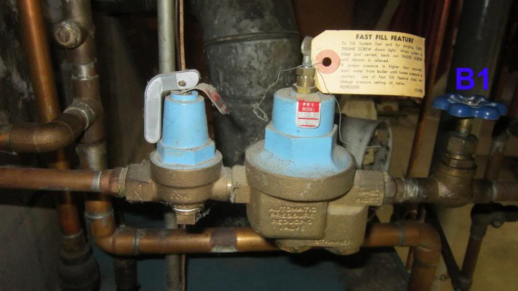

WARNING - DANGER WILL ROBINSON !
This photo:
shows a PLUGGED PRESSURE RELIEF VALVE! The device on the left side...
Marvin the Martian will be proud when there is an earth shattering kaboom as the boiler explodes into supersonic bits of shrapnel and steaming hot water.
That is... IF there is no other pressure relief valve mounted on the boiler itself.
One must NEVER, EVER PLUG A PRESSURE RELIEF VALVE!
I'll let you know after I look at the rest of the pics if I see another relief valve on the boiler so that you can sleep at night.

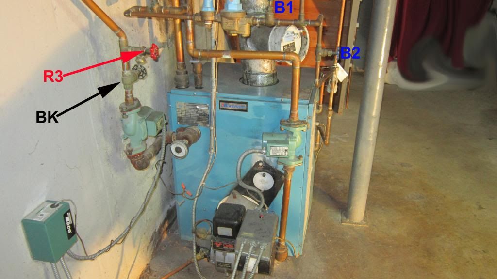

OK, in this picture:
We can see that there IS a pressure relief valve on the boiler itself. It's at the upper left above the gauge, on top of the boiler, on top of the right hand pipe.
What we can't really see in this photo is whether or not that one is plugged also.
Please check to be certain that there is a pipe coming off this valve and elbowed down to another pipe ending with NO PLUG OR CAP on the end to within 6" of the floor.
[edit] I do see a pipe off that relief valve in other pics, and it's probably OK... as long as there is no plug on the end of it. It MUST be open!

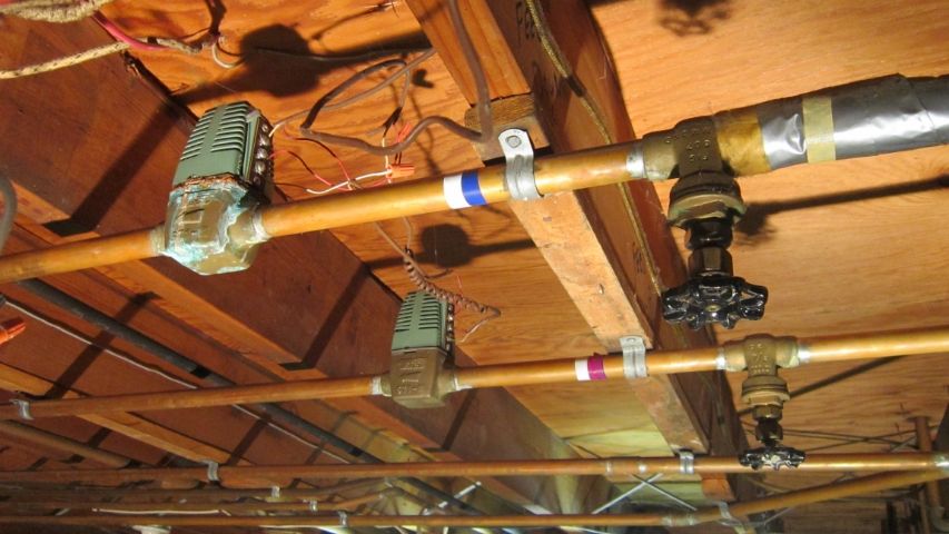

First,I updated my HZ diagram and color coded the individual heating zones
I then bought a pack of different color electrical tapes at HD and put bands along the pipes following the loops to where they converge or separate.
After each loop was assigned its own color I then added a white band or a black band on the front-end of the color. White denotes feed and black is for return.
[NOTE: That zone#4 Taco ZV just above is next on the list for this coming week. That will get it's own thread. It surprisingly functions fine but I have a replacement in hand. You can see Z4&5 return pipes in the back but they were not labeled yet in that pic.]
Now that I knew where the water comes from and goes to I concentrated on the external components. I found a lot of good basic info here:

Well, I'll tell you what I did and you can tell me if I did anything wrong or inefficiently. I know that I made an inefficient 'non-fatal' mistake that may have added a little extra bleeding-from-the-radiators time. There is some type of what I think is a shut-off valve without a handle that I did not utilize just below purge station 1(valve R1). I just didn't recognize it as one and it was never noted to me in my pictures. It looks like a perfect spot for a ball valve now that I understand the system much more. top_zpsb6cceb2f.jpg Photo by snowday133 | Photobucket
1. I flipped the boiler shut off switch
2. Shut off main water supply to boiler(valve B1)
3. Shut off feed valve (R2)
4. Uncapped purge station 1(R1) and attached hose in to bucket
5. Depressurized system using the purge valve watching the gauge go from 20 to 0
6. Once the needle hit 0 I went upstairs and opened the bleed valve on the radiator preceding the one that I was replacing. This was to break the water vacuum and let drain the minimal amount of water from the system as you recommended. Bleed valves were closed at the end of this step when the radiator was empty.
The radiator that was replaced was at the end of the upstairs HZ loop(HZ#3), just 16 feet or so above the purge station and boiler. So now the radiator was completely empty but the zone was still 80% full.
7. After the replacement was completed I opened up the main water feed valve(B1) then zone feed R2. The purge station was open with hose and bucket. Fast fill was used just enough to get a good flow going in to the bucket.
8. Once the main air pocket was pushed through I closed the purge valve and let the pressure raise to 12psi in the cold boiler.
9. I bled the air from the radiators in that zone. I even checked the air bleeds in the other zones connected to that purge station.
10. I flipped the switch to the boiler
Like I said at the beginning, there is a shut-off valve just below the purge station that was not utilized. It uses a flat head to open and close. It's somewhat frozen but I'm spraying it with liquid wrench for future use. This accounted for me not being able to completely purge all the air with the hose and having to bleed a little more than usual.
After doing research on the forum and webpages, and watching soooo many youtubes of people working on old systems, new systems, and systems that were updated throughout the years(like mine) I gained some insights:
An ideal system has shut off valves and purge stations for every loop. Some even use ball valves to isolate the loop from the rest of the system after it branches and before it converges. This makes tasks easier such as replacing a zone valve or shutting down a zone for maintenance or remodeling zone much easier.

I'm surprised you were able to purge the zone at all without having closed the screwdriver valve below R1.
Any water you fed into the system was not traveling up and through the zone at all, just up from where R2 connects to the zone through the open screwdriver valve, and out drain R1.
By closing that valve, water would have had to travel through the boiler, around the zone and finally out R1, pushing the air ahead of it.
Also, you would have needed to manually open any zone valves that are in the path of the water.
