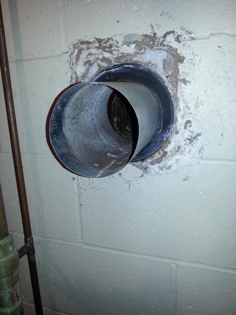

Old 06-09-14, 06:15 AM
G
Join Date: Nov 2007
Location: MI
Posts: 2,634
Received 1 Vote on 1 Post
I was at the cottage over the weekend and unboxed the water heater & set it where I want to install it. Is it too tall to join the existing boiler vent? Boiler is 5" and HWH is 3".
I think there's room for the elbow and correct pitch but I've read it's not good to drop an elbow right on top of the hood--some vertical rise is needed to keep the exhaust moving fast. I'm not clear whether that's a "must" or a recommendation, or how much is enough.
What do you guys think?

Old 06-09-14, 06:26 AM
lawrosa's Avatar
Super Moderator
Join Date: Dec 2010
Posts: 18,159
Received 69 Votes on 61 Posts
The HWH needs to be piped 4" per codes as I know it.. Unless it was stand alone,,,
Yes a short piece of straight pipe. I believe supposed to be 12"..
Last I dont think you can fit a Y on there and be able to reconnect boiler? Cant see really. Why is the chimney open like that where the flue goes through? Should be cemented..

Old 06-09-14, 06:56 PM
G
Join Date: Nov 2007
Location: MI
Posts: 2,634
I need to upsize the flue because it's going into a wye?Install manual makes no mention of that.
Or that.
Are you mistaking the thimble for a huge gap?
Sounds like I'm back to 2 holes in my chimney. ..

Old 06-09-14, 07:11 PM
lawrosa's Avatar
Super Moderator
Join Date: Dec 2010
Posts: 18,159
No you have to upsize the water heater to 4" because that is code as I know it here in NJ. If its here in NJ it will be everywhere else sooner or later. There is a whole story involved in that. The inspectors make us do it. Although the draft hoods from the manufacturer are still 3". ( We do install 4" aftermarket hoods)
Actually that draft hood is beveled and will fit 4" which we do...
And the code is stupid because the internal flue in the HWH with the baffle is only 3"...
I dont see a thimble. Is that still a tile chimney?
Just saying is all....
I may have my terms wrong. I thought the collar an appliance flue passed through is the thimble. Anyways the dark donut is metal sleeve and cap and cemented in place. Chimney is clay lined.

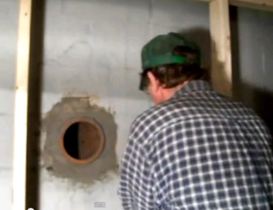

either do this and put 6" above boiler flue.. ( Use 4" pipe for HWH)
Or do this. Srry not better pics. But you see the two flues were seperate. I combined them with a 6x5x4 Y. See I have the HWH side of the tee rolled down for pitch..
http://www.doityourself.com/forum/bo...ue-issues.html
Last thing is get a powervent heater and pipe PVC to an outside wall. ( Or go electric)
Have you ever knocked a new hole in a clay-lined chimney? What's the process? Just use a bfh & bash away at the cinder block & whatever layers until you break through and then keep chipping away at it until it's more/less round?

Old 06-10-14, 06:09 PM
lawrosa's Avatar
Super Moderator
Join Date: Dec 2010
Posts: 18,159
Yes break the main block till you get to liner. Then I use a long flat blade for the tile in firm strokes to break cleanly...

Join Date: Dec 2010
Posts: 18,159
Cement around the pipe when done and make sure the pipe is not stuck in so far. maybe 1-2" or so into the clay liner..( I have seen guys stick it in so far that it hits the back of the liner and the appliance then does not draft)

Update:
I just got back from my cottage and while there I took apart the boiler flue to inspect and see how deep the chimney clay liner is from the wall surface. I found that my chimney thimble is badly rusted. I suspect the heat & moisture leaking into the block that surrounds the liner is why I have been seeing efflorescence on the exterior the past 2 winters. I've backed off from trying to do this myself and have made an appointment for next month with the only "chimney guy" within 50 miles.
I have a thimble question: I recently watched some Youtube videos to get a better understanding of chimney construction and watched a series from a guy that calls himself "chimneyking" where he makes a thimble from 6" round fireclay and muds that in tight through the block & into the clay liner. His definitely won't rust out over time. How common is that kind of masonry thimble vs. galvanized?
  #35
Old 06-25-14, 03:55 PM
G
Join Date: Oct 2008
Posts: 3,016
Received 13 Votes on 13 Posts
Not common around here.
Galvanized steel should be OK unless you are getting condensation in the flue - which evidently you have been. Even with the masonry thimble, it presumably will still need to transition to steel for fit-up to the boiler, right?
Yes. At the end of that video I was left wondering how the flue attaches? I assume the flue would be crimped to fit inside the tile thimble with a bit of high-temp sealer to secure it? He didn't leave the thimble proud to use a cap to fit over it so inside seems the only option. "Chimneyking" seems to be a bit of a nut but the final result looked very nice and much more professional and "right" than a sheetmetal plate with a hole in it (what I now have).
