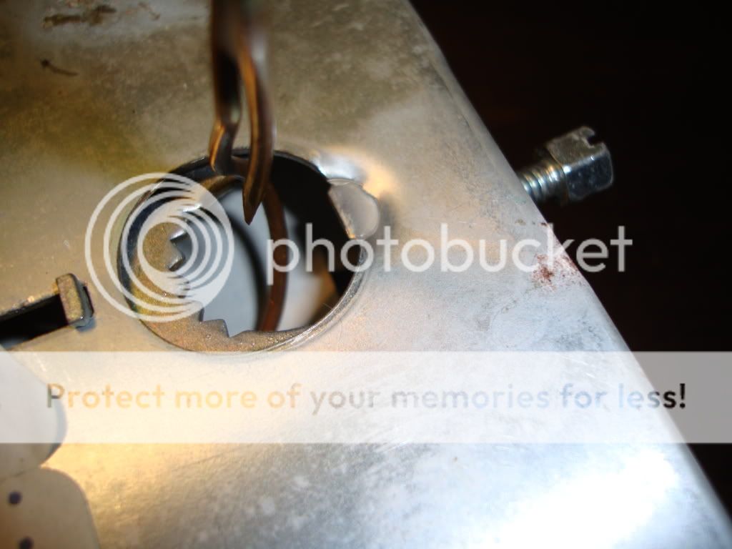

What should I watch out for when replacing Honeywell Aquastat Controller?
Old 09-02-14, 03:05 PM
Join Date: Feb 2010
Posts: 45
I've had intermittent issues with my oil fired boiler supplying DHW over the summer: The boiler wouldn't start. If I tripped the reset it would fire but after a week or two it wouldn't. Called service and they determined the Honeywell controller wasn't working properly and needed to be replaced.
50+ year old boiler with a DHW internal coil.
Technician also diagnosed a bad circulator pump (Taco 007 Cast Iron)
Price quoted was about $1,000 to replace both. Controller alone was quoted at close to $600 and I declined.
Found a new in the box controller on ebay for $135 shipped and it showed up today. What I need to know is what to look out for when installing it.
The model numbers (and revisions) on both controllers are exactly the same, so I'm pretty sure the wiring will be simple.
Not sure about the pipe coming out of the boiler that connects to the back of the Honeywell Controller...How is that secured to the controller? What should I be watching out for when doing the swap?
Thank you in advance for any help on this!
Old controller:
Since the two controllers are identical, I'm assuming that the wiring will be exactly the same. I plan on marking each wire on the controller that is still on the boiler and transferring the same wires to the new controller. The pipe that somehow connects to the back of the new controller is what has me a bit stumped: New Controller...

There's usually just a set screw holding the Aquastat in that correct position.
Well, that comes sorta close to answering the guy's question... but no cigar for you.
In this picture, you see that Philips head screw on the side? That's the 'set screw' that dburr is talking about. It's a 'clamp' mechanism. Look at the new one and you will see how it works.
You loosen that screw and the clamp will retract (you may need to hold the screw head to the chassis of the a'stat).
After loosening that screw, the old one should slide right off.
Don't bother with the paste... it's more trouble than it's worth. Just make sure that the temperature sensing bulb is fully inserted into the 'well' and that it STAYS at the bottom of the well.
Be very gentle with that thin copper capillary tube... you kink it and you have a $135 paper weight. You can gently bend it, but don't kink it!

Yes, included in the box are the instructions. There is no thermal paste, but there are two (2) rubber caps that I presume would cover a couple of electrical knock-outs if necessary, a blue-headed wire nut and what appears to be a lock washer.
The instructions do mention the side screw that holds the probe into position..I found this part a bit fuzzy:
Fit controller case into immersion well so that immersion well clamp slides over flange of immersion well. Huh?????
Securely tighten immersion well clamping screw.
I'm thinking the pipe from the controller to the boiler in my pics is the "immersion well" is that correct?
The probe is the copper tube on the back of the controller...??
It slides into the tube that is connected to the boiler and located on the back of the controller...
Next question assuming I can figure this ^^^^ stuff out....How do you drain the boiler and is it really necessary when you look at the pics of the plumbing??
It will all come clear when you take the old one off.
On the end of that 'pipe' (which IS the 'immersion well') there is a 'ring' on the end that the clamp will fit into.
You should not have to drain the boiler. That's the whole idea of the immersion well. It's closed inside and the bulb is not exposed to water.

Sometimes it's kind of a pain to get the new aqua stat on the well. Just make sure the screw is loose enough and don't break the tube. It's full of mercury. I'll tell you from experience that it hurts pretty bad when that bulb breaks and you get mercury in your eye

Take notes/pictures of how the three sets of wire leads (white/black) enter into the controller are connected>>>
Unscrew this side screw and slowly walk the controller out of the "well" ??
For anyone that has BTDT I know this appears as though I'm suffering from some sort of brain damage...just trying to make sure.. ;-)
Loosen this screw and once the electrical connections are free the controller can be removed?

We all forgot the simplest and most important step. Push up on the screw. You got it but I didn't think about that part.

Job finished and I have hot water!
A big THANKS to everyone that helped me out on this. I've successfully installed the new Aquastat controller and it is working as it should. Was pretty pumped when I flipped the breaker for the boiler, turned the red emergency switch back on and the boiler fired right up. Ran for about 12 or so minutes and got to 180 deg and shut off.
Running DHW all day and the controller is doing its thing...turning the boiler on and off as required.
