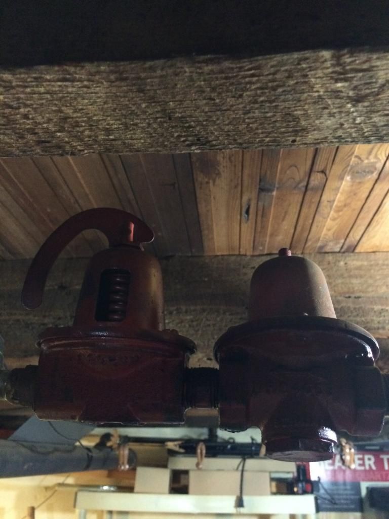

I believe these are the fellas you're asking for:
Wouldn't they be malfunctioning if the pressure ever falls below 12psi? When I did the recent bleed, I had to run a bypass from the spigot of the water main to the spigot before the circulator to have enough pressure to bleed my 2nd floor radiators. I brought it to 15 for that. Once bled, heated pressure got up to 25 and climbing. I drained the tank completely then and was still dangerously close to 30 so I backed the pressure off with the spigot I filled at. Since then, the highest I've seen is early 20s. To be able to swing from a cold 2 up to a hot 25 seens screwy and worrisome
I believe that's true.
Did you look for MANUAL shut off valves on this water line?
The valve to the LEFT is I believe an old style pressure RELIEF valve. This type of pressure relief is no longer up to code, and if my eyes aren't deceiving me, there is a PLUG in the bottom port of that valve... is that correct?
If that is true, PLEASE tell me that there is ANOTHER pressure relief valve on or near the boiler... one that looks somewhat like this:
image courtesy supplyhouse.com
Even if that other valve is not plugged, I would feel so much better if you told me that you had one of these on the boiler.

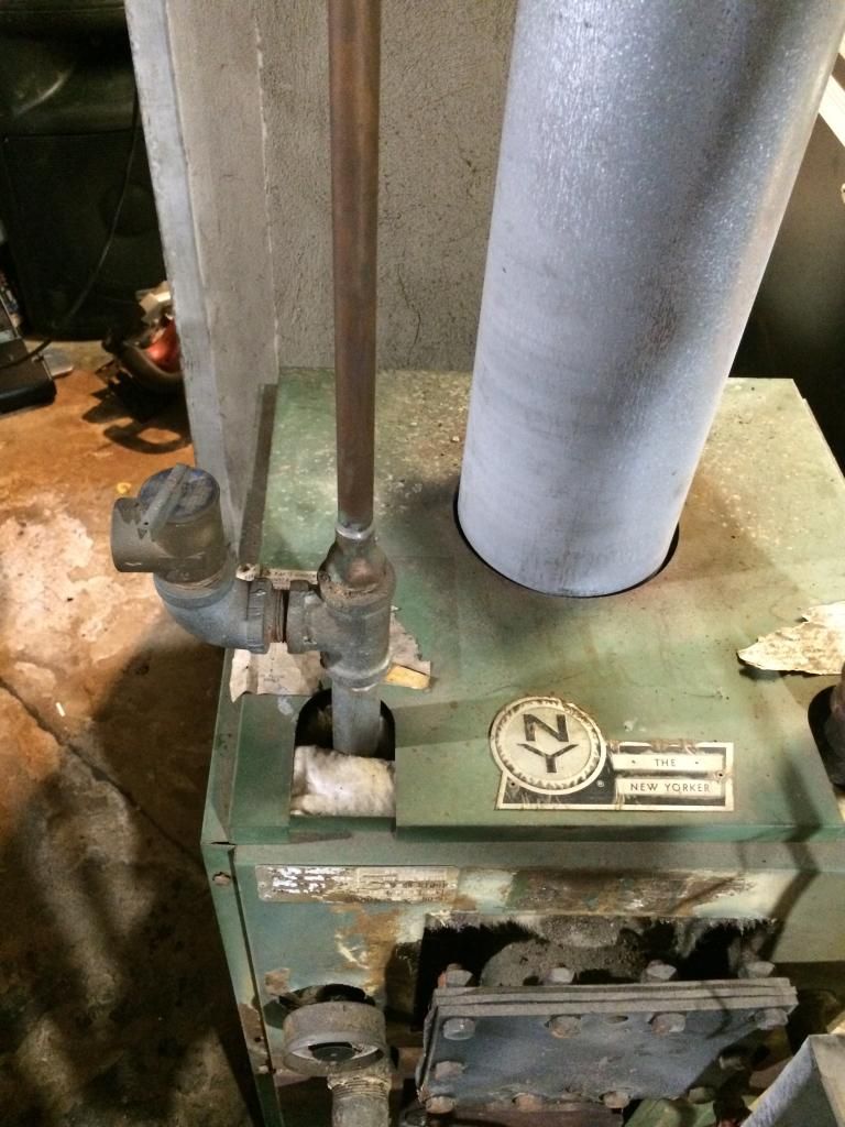

OK, you DO have another 'proper' pressure relief valve:
But what is NOT proper is the fact that this is not piped down toward the floor.
Heaven help anyone standing in front of that if/when it lets go. Time to call 911 for a trip to the hospital burn unit.

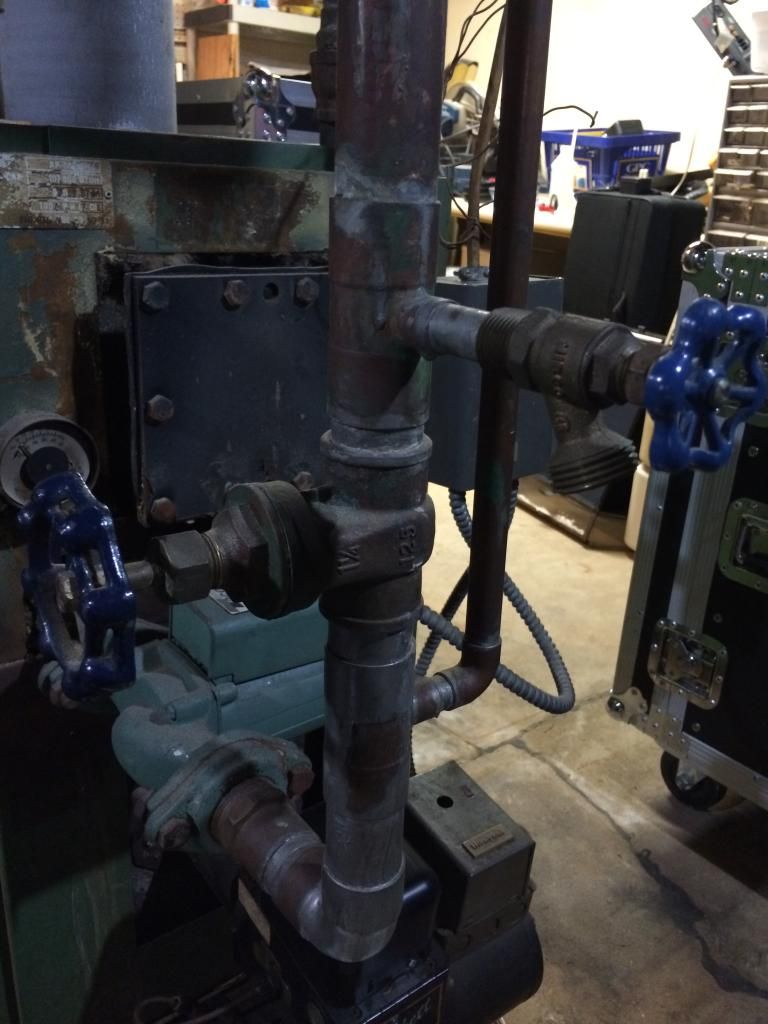

This looks like the water line feeding the boiler, is it not?
Is that valve in the foreground OPEN or CLOSED?

Yes I did. There is one valve prior to the 2 red bell housing fixtures. It is open. After these fixtures, the water supply enters the 1 1/4" return/supply immediately before the circulator. There is a manual valve just behind that entry point which is also open (the return from rads). Immediately above that is a drain/fill valve which I have used to both to drain and fill. Those are the only manual valves on the water supply end of things. Here is a picture of what I just described:
To confirm, the valve to the left with the arm and spring on top is a Bell & Gossett A-8 30psi pressure relief valve. I do not see a plug on the bottom. There is a threaded hole on the bottom that is vacant. This is where water should come out if manually testing the valve with the arm.
The fixture on the right is a Bell & Gossett B-8 12psi reducing valve. It does have a plug on the bottom which I assume is a service port. If I understand posts from you to others correctly, I shouldn't even fool with trying to service it there and just replace it if faulty.
Given that the pressure falls below 12psi on the system, either the manual valve before these is faulty (unlikely, it's a simple inline spigot type valve) or the one of the 2 Bell & Gossett valves is clogged. I believe the galvanized pipe entering these to be near the end of it's life expectancy so I'm very nervous about replacing them. I've encountered a lot of fittings in other plumbing repairs here where some of the threads were rusted through. Moving along, I can manually fill to pressure via bypassing from the main supply to the drain/fill valve in the picture above which is what I did in order to complete the rad bleeding process. As long as the system doesn't leak/ maintains pressure, I'm fine with avoiding the valve replacement until the summer.
Yes, there is. It appears you already discovered in the replies I'm hitting up next.
Whoah! Hold the phone... I lied above. The manual valve before everything was NOT open. Forgive that error. When open, it increases the pressure of the system to 10psi according to the tridicator. I had shut it off when the hot system pressure was reaching the mid to upper 20's. I have also developed a dripping leak at the stem of the large valve in the picture above when the first manual valve is open.
Duly noted, I'll pick up a 90 and a length of straight pipe to aim it at shoes instead of stomachs.
Probably and easy fix. Just lightly snug the 'gland nut' which will compress the packing material a little bit more around the stem. Only tight enough to stop the weeping.
