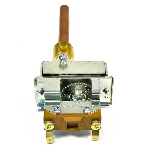

I disconnected both wires going into and out of the aquastat, and the boiler still fired.
It's a Burnham P-204A-WNI natural gas firing unit.
image courtesy supplyhouse.com
You disconnected both of the wires on the HIGH LIMIT switch?
If that's so, then you definitely have a wiring error.

Just another side note: when i disconnected the high limit switch earlier, I had 24v hooked to th-w. Which if I'm reading correctly, shouldn't be hooked that way with a damper, only without.
