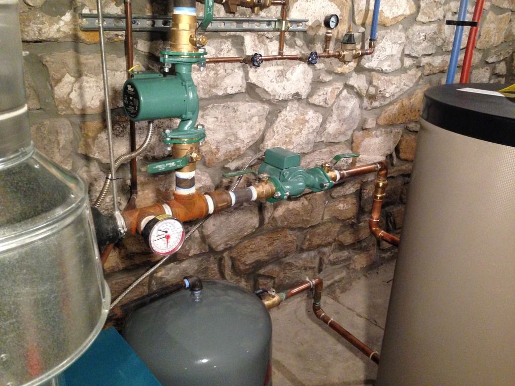

Re-piping update
NJT and Lawrosa asked for revised pics so for what it's worth I thought I'd upload some now that the conversion to primary secondary is "almost" done.
1. Yes I forgot the $%&#* globe valve between the ESBE and the supply line, so I'll be taking a few pieces apart to get that corrected.
2. Please disregard the temporary wiring. I'm still working out the relay/ODR wiring for the primary circulator and haven't buttoned everything back up.
Any comments or critiques are welcome!
Thanks all.

Is that esbe oriented correctly? The square mark on pump side? Triangle facing close tees?

Yes sir. Square is on the pump return, triangle is to the tees.
What I don't like about it currently is the slight uphill angle from the supply line. I don't want air to get trapped so when I take it apart to add the balancing valve I'm going to see if i can't get that lower to avoid that possibility, or just adding another purge valve above the return temp gauge. That probably means having to change the 45's to 90's to buy more distance between supply & return. I hate to add more friction but i figure for a short run like that boiler loop it beats moving both gas and electrical hookups to drag the boiler away from the wall another 6" or so...

Just saying cause the label up the square and triangle are opposite . But maybe they are putting labels on both sides?

Yeah it came with additional labels for each side so i stuck them on there just for grins.
