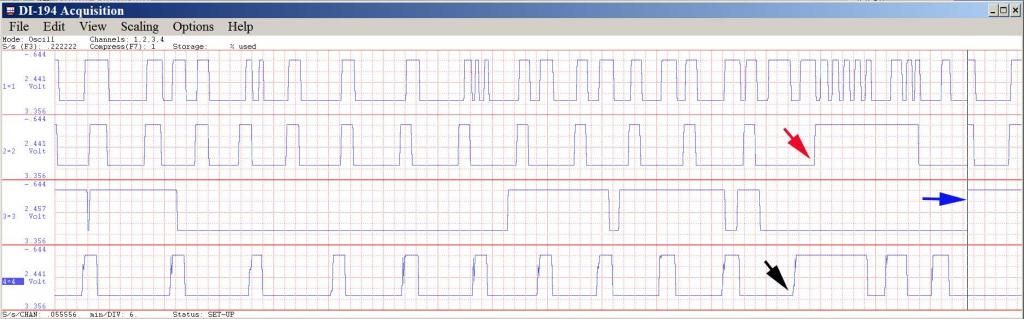

I notice this morning when I turned up the heat for the Main Zone, and my wife turned up the small office zone (about 15' of baseboard) the boiler is cycling on and off like it hasn't before but it's settling down once the main zone comes up to heat. She turns up the office zone pretty high (73) and I notice that thermostat tends to stay on for a while, but the temp in that zone and the boiler tends to reach a hot level that will stay there until the T is satisfied.
Lets see if I can post a picture of the DAC for what it's doing. Each small mark is 6 minutes. The top line is the blower motor, second line is either the Bed/Bath zone or the Office zone, the red arrow shows where I switched from the Bed/Bath to the Office zone, (the DAC only has 4 inputs and I need 5) the 3rd line is the radiant heat zone, and the bottom line is the Main zone and the black arrow shows where I turned up the thermostat from 67 to 70 at about 8am. The blue arrow is current time, it just keeps wrapping around in about 7.5 hours and I can record with no time limit if if I like. The glitch at the beginning time for the Main zone is a glitch produced by a defective relay. It has no affect on the heat system.

It's funny today, the boiler seems to be sort of short cycling and it hasn't been doing that before, it may just be a combination of the outside temp (25-34) and heat load? It's been going on and off in maybe 3-4 minute cycles for about 5 times and then it settles down and turns off for a while. This boiler seems to bring the water temp up faster than the V14 ever did even though it's got a .6 gpm nozzle compared to the .75 in the V14 which was reduced maybe 5 years ago from a 1.0.
My house faces due south with a lot of windows and on sunny days, the heat doesn't even come on even if it's in the teens outside like it was last week.
