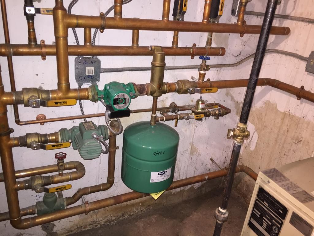

I see like seven circulator pumps. Is this an advertisement for a plumbing supply ?

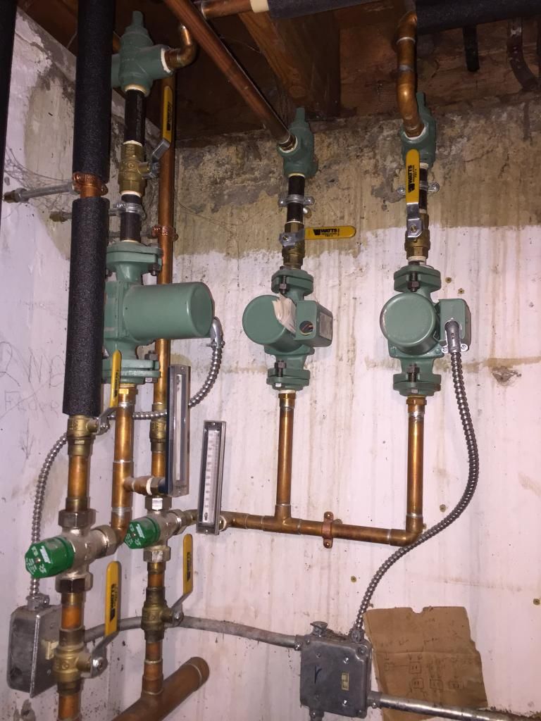

So far I see when you bleed the system you need to shut the yellow handle of the bypass in this pic. Its the yellow handle valve to the left of the dark grn pump...
[ATTACH=CONFIG]45268[/ATTACH]

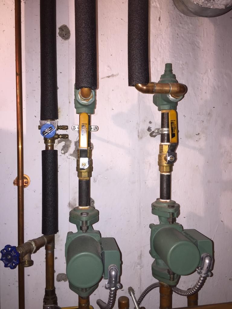

And shut the yellow handle to the right of that pump and bleed from the blue handle boiler drain there...
Also for each zone you bleed the flow control should be opened all the way for the zone you are bleeding...
[ATTACH=CONFIG]45269[/ATTACH]
Flow controls are above the pumps...
[ATTACH=CONFIG]45270[/ATTACH]

So basically I'm dealing with the top level of pipes in the pictures you mentioned, the horizontal pipe above the expansion tank with the green pump in the middle of the two valves? So if I shut the yellow valve to the left the water will be prevented from returning to the lines. The blue spigot on the right is to relieve the lines of air. Is this correct? Does the valve directly to the left of the blue spigot need to be shut when I bleed? I'm also curious what the red spigot is for on the left lower side of the system. There is also a blue spigot on the bottom of the boiler itself, but I'm guessing that is just to drain the water in the actual boiler?
Also note you must raise the pressure here. Lift that handle on fill valve.. Although there is a bypass there. The fill valve may not give enough force to push out the air. so opening that yellow handle in back will help better... Dont raise psi over 30 or relief valve will trip..
[ATTACH=CONFIG]45271[/ATTACH]
Last all zones must be closed. Only open the one your bleeding... Yellow handles above pumps...
[ATTACH=CONFIG]45272[/ATTACH]

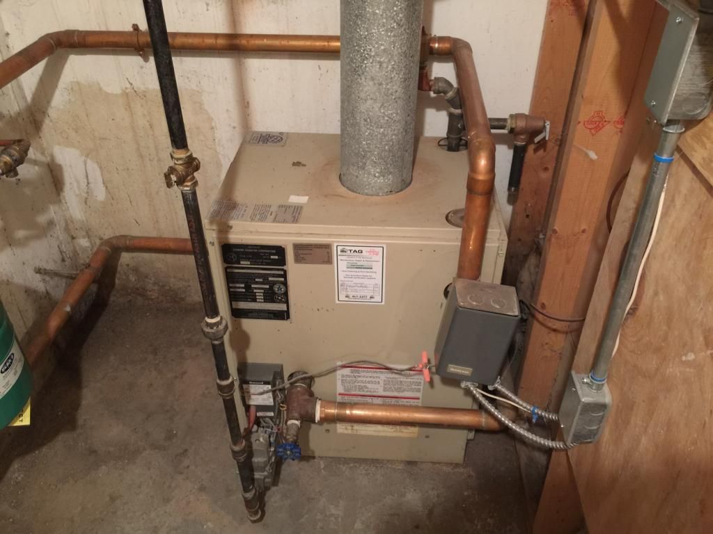

Also even after you get the air out , the air eliminator/s may not be working. These should remove the fine bubbles that are in the system.
Thats this item here above the expansion tank.. It may need to be rebuilt..
And there is one tucked behind the flue pipe in the back of boiler.. Thats an AAV. These need to the boiler to be drained some and/or isolated to repair..
I feel you may have a combination of failures..
1. faulty gauge
2. faulty air vents
3.faulty fill valve thats not maintaining 15 psi in the boiler cold..

#36
also what type heat emitters do you have? This was not addressed before but you have two zones with mixers... These are low temp zones usually used for radiant heat... If so it will be slow rise in temp..
Thats these two devices with green handles. Dont tounch them yet until you explain...
1. what does the temps read on the thermometers there?
2. When the boiler is running what is the temps read on the boiler gauge? Does it read 180?f What it and let us know...
3. Feel the pipes and basboard. Are they warM? Hot?
Last I cant tell what this is on far left in pic. Has blue cap.. cant read it..... alsowhy is valve closed under blue handle valve..??
#37
Join Date: Jan 2015
Posts: 25
Received 0 Votes
I'm not sure why that valve is closed, but I opened the spigot and nothing came out. The blue valve above that spigot says "Watts Flow Measurement Valve". It's on the closed position. Should I open that valve below the spigot and see what happens? It's been closed ever since I can remember.
Also, went I was bleeding the individual zones, should I have closed the valves below the mixers or was it fine just to close the ones above the circulators?
#38
Im sorry I did not see this or state this before...
Please tell me about your heat emmitters? Finned baseboard? Fan coils anywhere? Snow melt system?
Take more pics...
