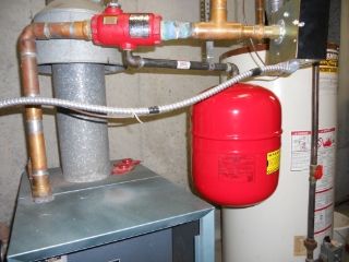

Hi,
Firstly, I appreciate you taking time to read this and i am extremely Sorry for sounding in HURRY and urgent.
I noticed that my expansion tank was leaking and the problem is i have to travel due to an emergency for two weeks and I want to be completely sure that leaking tank will not pose any danger to my family.
Your reply is very much appreciated.
I am also not clear what kind of tank i need to buy. Home depot has many different listed HERE
I also read NJ Trooper post on Expansion Tank but i see that there is no room for optional valve. is there any trick to make that happen (perhaps buy tank in smaller size than one i have ?)
I am also not sure how to drain water from the tank since there is no valve and tank is hanging on the pipe directly going into the boiler.
Also, do i need to replace anything else while replacing the tank ? I noticed that something looks like air valve where tank is mounted is rusted.
Here are the images:

Where on the tank is the leak?
The brass can on top is NOT part of the expansion tank.
If that is the part that is leaking, just screw down the cap on top tight and wait until the spring time.
If you order on the internet, Expansion Tanks , Amtrol Expansion , Extrol Tanks , Therm-X-Trol Tanks , Boiler Expansion Tanks - SupplyHouse.com is a MUCH better place to order from.
You should not reduce the size of the tank, the size is chosen according to the needs of your system. Using a smaller tank may cause other problems.
Your tank appears to be a #90 size tank from what I can see. This means that you probably have cast iron radiators throughout the home?

NJ Trooper thank you for reply.
Leak is from the circular raised point "Where the sticker says "STATE Therm -o-flex"
I have baseboard heat (not cast iron radiators).
What would be my tank type ?
Thank you

Spott, you think that tank is a 30 ? Go back to the pics and look at it again... that's not a 30 I don't think, look how tall it is?
Sorry, I don't see it. Are you sure it's not water leaking from that air vent on top and it's dripping down?

Air vent leaking right there at cap... I see drop of water........
[ATTACH=CONFIG]47821[/ATTACH]

Are you sure that it's not dripping from the vent on top and running down the tank?
Even though air vent on top of air scoop is dripping (little) but i am NOT sure if that is the main source of leak.
it seems Leak is from where paint is bubbled on two spots and is dripping water. Please see pictures.

OK, I see it now! Yeah, that should be done pretty soon, if not immediately.
In the future, don't take the heating system so much for granted.
ET7 is 7.3 gallons and replacement suggested by NJ Trooper # 90 is 14 Gallons, shouldn't replacement be same or less size.
Yes, it should, but please do not confuse the TOTAL volume with ACCEPTANCE volume, they are two completely different numbers.
I'm gonna check again though just to be sure...
But, you need to call someone, I don't see this ending well for you if you try it yourself. Something ALWAYS goes wrong for first timers... just being realistic.
And while the guy is there, have him replace the air vent at the same time.

I lightly scratched off the paint and got the clear picture of source of leak
please see below. Can it be used for heat lightly for two weeks or is it a DANGER ?

Get a a run of nipples and two elbows and offset the 60 so it gets around the top of the boiler..
Looks like you have the room against the wall..
Like this.. (Homestore has longer nipples if you need them.)
I have not followed this thread too much. Let me do the calculations... stand by....

The largest boiler is a 150,000 for a #30.
It doesn't have to hang right off the air scoop.
With a couple fittings can you swing it to the side of the boiler.
Nipple, 90, nip, shutoff, nip, tee/bd, nip, 90elbow, hang tank off that and you could have your isolation valve and drain at the same time.
You might want to support the pipe with some strap or hangers for weight in case it goes, it could get heavy.
Sorry for the delay but I would stay with the #60.
I'm going to go a step further with this.
You will DEFINITELY NEED TO support the pipe if you do this. It is not optional. The longer the horizontal nipple, the greater the torque when the tank takes on water and gets heavier. Even more important if you add the isolation and drain valve in the horizontal section.
image courtesy amazon.com
Around the pipe at the tank, up to a floor joist above.
You can see this in the pic that Mike posted.

-3- What is your advice on Water Worker 4.4-Gallon VS Amtrol #30.
-4- I can manage with some EXTRA LLLONGER nipples to get #60 (7.3 gallons) attached and put it between water heater and boiler, it will be of great inconvenience and will be in way blocking things BUT do you think I must go with that even though at this time i dont seem to have any problem with 4.4 gallons.
I am also attaching images of gauge
With old Tank = 30 PSI = 150 F
Old Tank Unhooked = 0 PSI = 100 F
New 4.4 Gallons Tank mounted - Supply Valve opened (Water in) = 12 PSI = 100 F
New 4.4 Gallons Tank mounted - Heat ON = 20 PSI = 220 F
Boiler is too hot,,, consider lowering it to 180F..
The exp tank you installed is fine....
Good job...

Yep, I agree, there seems to be no reason at all that the old tank was a 60 size (or larger!)
Since you used the 30, you were able to install the optional valves?
Check the air charge in the tank at a MINIMUM of bi-annually and that new tank will last a LONG time.
-1- What is the difference between (AGA Ratings) AND Net IBR ratings
When replacing Expansion Tank should I be concerned of AGA ratings or NET IBR rating ?
-2- Since the smaller tank i put up or #30 is compatible for NET IBR of 150,000 and my boiler NET is 156,500.00 Would that cause problem in the future ?
Boiler size is a round about way of sizing an expansion tank. It assumes a lot of things... basically using the boiler size in order to estimate the volume of water in the system.
What actually determines tank size is the VOLUME of water in the system. Since the water expands when heated approximately 3-4 % in volume from room temp to 180F, that expanded water needs a place to go. Your system does not have a massive volume of water being copper fintube baseboard and thus the 30 size should be fine. My own boiler is a bit smaller than yours, but similar installed baseboard and the 30 size is adequate.
Empirical evidence that the pressure goes from 12 to 20 further says that the 30 is fine. IF your gauge is accurate! We don't know that yet!
No clue... never heard of it!
It's got a 5 year warranty though... save the receipt!
I would hold off on that ... if it's OK, it's OK.
