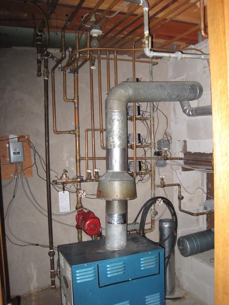

With the spring weather approaching, my boiler has begun to act up again in terms of very loud banging noises. After some investigation I have discovered this is only happening when the boiler is cold (i.e. has been off for several hours). When the thermostat first calls for heat, the boiler comes on but the pump does not. It is during this period that the banging is occurring, once the pump activates all is well again.
Just as a quick side note, at the beginning of winter I re-plumbed the system when I moved into the house. The system has a compression style tank, and someone had put a bunch of automatic bleeders in the piping. I removed these and installed a new water separator at the outlet of the boiler and plumbed it directly to the expansion tank above. This solved all of the continuous noises I was having during regular operation. In fact, the system has worked flawlessly and quietly until now.
Digging into the wiring a little, the heart of the control is a White-Rodgers relay that I cannot seem to find a part number on. The boiler is activated by this control box and the pump is run off an aquastat mounted on the outlet of the boiler. I'm thinking if I wire the pump so it runs directly off the thermostat, then I won't have this latency period between the boiler coming on and the pump beginning to circulate. Is this a bad idea for any reason?
In reference to the wiring diagram for the White-Rodgers unit (see picture in link below), it appears I can connect the pump across terminals 3 & 4 to be activated by the thermostat. Is it okay to do this? Currently, 'L' terminal is jumpered to 3, to which all hots except the pump are connected. The neutrals connect to the other (lower) 'L' terminal and 4 is not connected to anything. The boiler runs off terminals 1 & 2.
Obviously, if I wire the pump this way, it will turn off when the thermostat stops calling for heat. It would be nice to have the pump continue to circulate until the temperature in the pipes begins to decrease below a certain value. I know this is do-able with a temperature limit switch, but I'm not familiar with the terminology to find the hardware I need. Would this be the recommended way of doing things? If so, can someone recommend an inexpensive hardware solution.
BTW, the system uses a single pump and has 4 zone valves. There is an extra zone with no valve that I have yet to figure out where it actually runs.

I don't think the question should be one of how to rewire, but rather one of why is the boiler 'kettling'... you have a symptom and are suggesting a cure that is a 'band-aid' to the real problem.
Let's start by getting more information on the system itself such as the boiler make/model and any other information regarding the boiler controls.

Yes, sorry about that, I meant air separator. It is a B&G IAS-1-1/2, with a 3/4" top outlet plumbed vertical all the way to an Airtrol tank fitting. The feed water line is also tee'd into this vertical run of pipe.
The boiler is a Raytherm Model 168-T. Circa 1978. Both the relay and aquastat are White & Rodgers but I have no further info on them, other than what you see in the pictures. The zone valves are also W&R.

Great... the IAS is the right thing to use for this, but I'm sure you know that already!
It is my understanding (but I can't be certain because the manual for your boiler is not on-line at the Raytherm website) that all of their boilers are copper heat exchangers. As such they have a MINIMUM FLOW requirement that must be met at all times.
What this means is that I am questioning why the pump would be connected to an aquastat that holds off it's turning on for some period of time... (this aquastat is generally called a 'reverse aquastat')

Unfortunately, I do not think there is a manual for the boiler. I will double check when I get home tonight. I do have the cover off, since I was checking the wiring last night - Is a picture worth anything?
The endswitches of all the zone valves are operating the W-R relay on the wall.
Terminals 1 and 2 of that relay are calling the boiler to heat.
That part is easy...
There appear to be FIVE armored cables entering that relay box.
One must be power from the electric panel.
One is going to the pump.
One is coming from the a'stat on the supply pipe.
One must be going to the boiler to power the 24VAC transformer inside it to operate the gas valve.
That leaves one unaccounted for, where does that go to / come from?
It appears they've simply used that relay box as a 'junction box'.
Next, the a'stat on the supply pipe has a cable coming from a box to the right. There are two more cables heading out of view to the right. Where do they go to / come from?
There is another box above that one that appears to have nothing in/out. What is that box?
What is the black object between those two boxes? Is that the 24VAC transformer for the zone valve power?
If there is a wiring diagram of the boiler on the inside cover, take a clear pic of that also.
The boiler should have a 'high limit' water temp control inside it. Probably set to 180F ?

Okay, I have uploaded a slew of pictures in the hope that there will be some clarity as to what is happening here. I also omitted some information before, thinking it wasn't important, but I realize now that may or may not be the case.
It appears there is a heating loop that runs into the back of the fireplace. I believe the previous owner was using heat from the fire to supplement the hydronic system. The pump is now gone (only flanges left) and the valves to the circuit are closed. Devices labelled A,B, and C in the picture album appear to be for control of this circuit, which had its own aquastat (Honeywell) mounted on the wall and the probe hanging below it. The junction box 'A' gets power from the current A'stat.

From Raypak I&OM
Your Raytherm has A Finned Copper Tube Heat Exchanger. It must never ever be fired without water flowing in the heat exchanger.
CAUTION: This heater requires forced water
circulation when the burner is operating. See
minimum and maximum flow rates. Severe damage
will occur if the heater is operated without proper
water flow circulation.

The standard way is to have a relay on the boiler that starts the pump when there is a call for heat.
I do not have a manual for that boiler but it is obvious that it has NO controls other than high-limit.
The pump should always run on a call for heat, burner on or off.

A Picture of the gas train to the right of the gas valve would help.
You have a balancing (butterfly) valve next each zone valve.
I will need more time to look at the piping, yikes . . .
yikes . . .
Why are you worrying about the piping anyway? The question was about the circulator operation and that's been covered... hasn't it?
