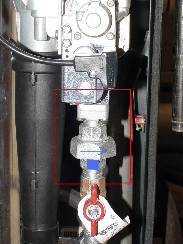

I need to replace the blower in my Weil-McLain Ultra 230 LP gas boiler. I have purchased the Ultra-230 Blower Replacement Kit (Part # 383-500-040). The blower came with replacement instructions that are, for the most part, very straightforward. However, what I did not know was that I will need to disconnect the gas line union directly below the gas valve.
My questions are, first, pipe wrenches will be the proper tools for this job so I don't damage boiler components. The instructions indicate I will need two wrenches, one to loosen the union and the second to hold the gas line securely. How does the union function so I am cranking on the right part and turning in the proper direction? Also, there looks to be some sort of pipe dope/paste. How difficult will this old dope/paste make it to loosen the union AND what is the best stuff to get to put it all back together?

In looking at a picture of your boiler I came across a recall campaign. No idea if it effects your boiler. Is this setup exactly like yours ? If it is... you would hold the nut on the bottom and turn the union in the direction of the arrow.

I'm always very hesitant to suggest DIY with gas line components because the potential for disaster is very real, even with the best of instruction.
