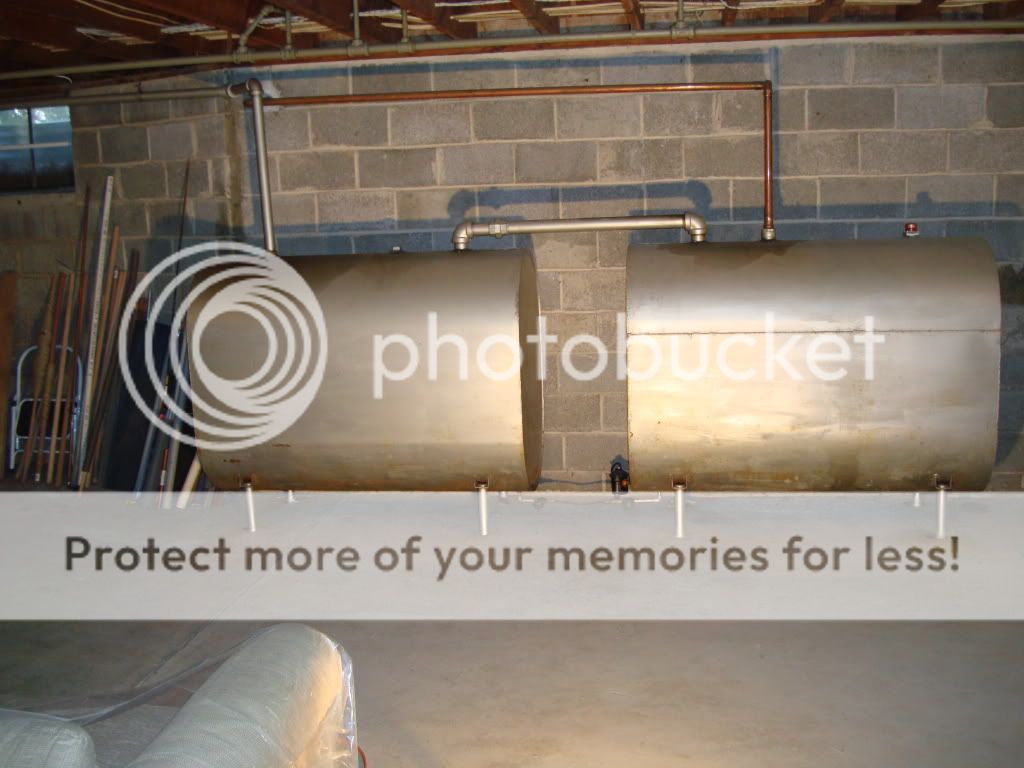

I have 2 tanks with a cross-over pipe as you can see in this picture. It was set up this way long before I bought the house. It was pointed out to me the copper is the wrong material for the vent pipe. The cross-over piping is 1 ½. You can see the fill on the left tank and the copper vent pipe on the right tank.
At the bottom oil flows between both tanks on a tee and the tee supplies the burner about 18 feet away. The oil gauge is on the right tank.
I used to buy enough oil so that on a fill oil would be forced over into the right tank via the cross-over pipe. But I don’t do that anymore because as was pointed out that puts a great deal of pressure on the tank. So I buy about 225 gals at a time and let it run down fairly low (not too low) and then refill.

I made a mistake in my last post; my cross-over pipe is 2”. I know you wisely aren’t using a cross-over pipe but I just wanted to clarify.
I am a rank newbie so you have to suspect anything I say. But if I understand correctly I think there should be more than 5/8 inch threads buried when tightening 1 ½ inch pipe. (I guess it would be the effective thread depicted in that link in post #29).

Looking at those twin tanks in zoesdad's basement, I'm wondering what the pitch is towards the center . . . . like ¼" per foot or more. In the photo, they look perfectly level. It must be so slight that it's visually imperceptible ?
A couple years ago, when I swapped out my single tank, I had to use a trolley jack to lift the dead end up about 5" to get the remaining oil out (something the installers didn't want to deal with.
To avoid a build-up of sludge in the bottom of the tank(s), do you pipe it so that incoming fuel enters towards the dead ends (outer end in your case) in order to keep the bottom somewhat clear ?

Vermont you are correct – I think. I don’t think the 2 tanks are slopped properly towards the center. But it seems to work and the last time I very carefully checked the oil level in both tanks with a stick, I didn’t seem to feel any sludge. I tried. But I have no idea if “feel” is of any value. (Maybe that trick for septic systems, where you tie a white sweat sock to a stick, and put the stick on the bottom, then remove the stick and observe the staining pattern, would work for an oil tank also. I think I’ll try that.)
I think I came across something one time that said the fill pipe should be far away from the gauge (I think that was the advice). But I don’t know much about this stuff.
