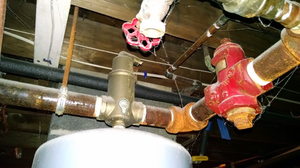

I am going to be replacing a taco circulator pump, and i was wondering if i have to drain the whole system, of if i can just close the valves above the pumps? i am attatching a picture.

There is a valve located above the pumps - but I don't see any valves below the pumps. Maybe they are outside the view of the photo? Without valves that isolate the pumps from the system, you will need to drain to below the pump elevation. Now might be a good time to add additional valves if required in the future.
Stand back and take several wide-angle photos that show much more of the system from various angles.
P.S. What is wrong with the pump that requires replacement? Those Taco pumps just have one moving part - the rotor, which is replaceable.

Frank, are there similar shut off valves on the SUPPLY side of the boiler piping? In other words, can you isolate the SYSTEM from the BOILER with valves?
If so, you won't need to drain all that much water... just the boiler itself.
Take a bunch more pics of all the piping around the boiler.

The pipes with the pumps and shutoff valves are marked upstairs and downstairs return. Below that there is a pipe that appears to be a supply pipe. That pipe also has a shutoff valve, and some sort of relief valve.

I took a couple more pics. The one with the red handle looks to me like it supplies water to the boiler, it connects to the same pipe as the pumps, just below them. There is what looks like a drain valve below it on the same pipe.
A BUNCH is not two. Need to see EVERYTHING in order to help.

Please read this:
http://www.doityourself.com/forum/bo...sion-tank.html
Since you will be de-pressurizing the boiler to work on the pump it would be an ideal time to service your expansion tank as well. The thread above has step by step instructions to do so.
Consider adding the extra bits if you want to make future life easier when servicing or replacing the expansion tank.
So basically open all the valves I would close to work on the pump, then turn it back on with the pressure relief valve open?
No... I think you may be confusing pressure RELIEF with pressure REDUCING valve.
When you replace the pump, close the MAIN WATER FEED valve, close the valves above each pump, close the valves over on the supply side at the other end of the loop.
After you fill the boiler back up after replacing the pump by opening the main water feed, and BEFORE OPENING the other valves, connect garden hose to the drains BELOW the shutoff valves on the return, just above the pumps.
These two, NOT the ones above the shutoff valves!
Vent air from each of those pipes.
You should hear air escaping from the air vent on the main supply line above the expansion tank. This thing (it's called a SpiroVent by the way):
Once you've done this, you can open all the valves and start the system back up.
You MAY hear some air gurgling through the pipes but don't worry about it... your AUTOMATIC AIR VENT (the brass thing above the expansion tank) will take out the rest of the air in a short time.
