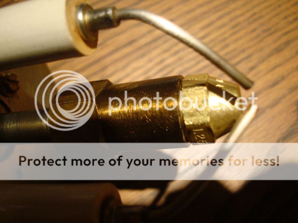

I thought this was a good idea, so I woke up early this morning and pulled the burner from the boiler so I could have a look. I have the beckett calibration tool (IE: the piece of metal with markings on it) and WOW -- it was out of spec by probably 3/16" or more (it is not close enough to the end of the head.) I have included some pictures. Note the carbon build up on the top of the nozzle, is this normal? It makes me wonder if that is happening because some of the fuel is actually not making it to the inside of the first box since the gun is too far back!
Your heat reclaim unit should be ok. Did you check the burner coupling for splits and remove the end caps looking for widened grooves?
I'm not entirely sure what the "burner coupling" is. Do you mean the coupling that connects the motor to the pump? If so, I decided to pull the pump off this morning and inspect the coupler. The coupler has a slight amount of play on both the motor shaft and pump shaft, but it doesn't seem like it is enough that slippage would occur. What I DID find, was that the back side of the pump is covered in greasey oil -- I assume this means the seal on the back of the pump has failed -- does this mean I should be thinking about getting a replacement pump?
Here are all the pictures from my work taking everything apart this morning. Just to cover my bases I pulled that weird heat exchanger thing off the vent stack so I could look inside of it -- it looks really clean in there -- so I don't think it is causing any issues. I also opened the damper all the way and looked inside with a flash light -- I saw a pile of gray ash at the end of the tube, where it enters into the masonary chimney, but it was such a small pile I doubt it was impacting draft. Just the same, I cleaned it out.
Thanks everyone for the help so far, I look forward to your thoughts based on my pictures and what I found this morning. The most "promising" thing seems to be the the Z distance was set 3/16" off and that perhaps the pump seals are starting to go, which is probably not so great as well ... .
A couple notes on the picture, there is a shadow in the picture where I'm holding the beckett tool against the burner head, so it makes it hard to see just how out of position the gun is from the end of the heat.
Also, I included a humorous picture of the screw that holds the Z adjustment in place, I promise, I was not the one who striped the screw, but I intend to replace it since I'll be adjusting things. Finally, I included a few pictures of the gun on my work bench just in case anything of interest is happening there.
Thanks for all the responses so far, I have really been beating my head against the wall on this one and I appreciate all the feedback!

That screw is made like that. Only way to loosen it is with vice grips on the inside. Check end caps on the coupling while you have it out. A adj. wrench on the coupling snug and a good pull will pop them off if stuck. I would clean up assembly with cleaner and steel wool. Pop a new nozzle in and tighten up the electrols together a bit and see what happens. Could be oil related too.(pump,etc.) Good luck.

I don’t know whether this indicates a problem, maybe the other guys would know, but I wonder if those insulators in your pic should look blackened like that. Here is a picture I took of the electrodes I replaced when I decided to start to do my own maintenance years ago. At that time I thought there was something wrong because there were no tips left. But the people on the forum here said that isn’t necessarily a problem if the gap is correct.
But I just looked at this picture again and noticed the insulators were not discolored at all, and I assume they must have been in my burner for a fairly long time since the electrode tips were burned down flat. So I was just comparing that picture to your picture of the electrodes and was wondering if the blackened insulators indicate a problem with the burning process. Maybe not.
p.s. here is a pic of the new electrodes I put in after a year. I took the pic so I could remember what new electrodes looked like after a year of use.
Ah, ok, thanks for that. I'll be careful not to bugger up the threads when I loosen it with the vice grips to make my adjustment
Ok, I'll clean everything up, check the ends on the coupling, adjust the Z dimension with the Beckett tool, and put everything together. Since I have to go to the plumbing supply store to get a new burner gasket I'll pick up a new nozzle as well. I may pick up electrodes if they aren't too expensive. I realize that the ones I have are likely fine, but I doubt it can hurt at this point.
Yes, I am thinking it is because the gun is not close enough to the end of the head. If you look at the picture where I am holding the beckett tool up against the end of the heat -- the gun nozzle is not touching the calibration tool and it should be! I am thinking that some of the fuel is getting burned on or too close to the electrodes and gun, and is not burning fully which would create the carbon buildup you see in my pictures.
Anyway, I'm just on my lunch break now and I need to run to the supply store as the close before I get off work. I'll update again tonight or tomorrow with whatever progress I make. I am going back and forth as to whether I should replace the pump. All the buildup you see in the picture on the backside of the pump makes me think the shaft seal is worn and leaking oil by -- makes me wonder what else may be worn out inside the pump. Maybe that build up is normal, but it seems unlikely...

I did not know you could check the Z dimension with the T501 gauge (learn something new all the time, lol). I found this which obviously you already know but maybe it can be helpful to others reading the thread.
(figure 7 page 7) http://www1.lennox.com/pdfs/installa...O183UF_IOM.pdf

So, I cleaned up the gun assembly and reset the Z dimension to the proper distance with the T501 gauge. In the end, I think I moved it a little more than 1/8" toward the head (I marked where it was so I could see.) As guyold suggested I also pulled the ends off the pump coupler and that all looked good inside -- no signs of obvious wear.
I noticed that inside the combustion tube there was a layer of greasy oil and (this ended up being a mistake) I removed the head so I could get in there to clean it. Unfortunately, the threads on the screws that hold the head in were quite brittle and one of them got partially stripped. The threads in the hole still look ok, so I think I just need to get a new screw. I was able to put it together enough for testing purposes, but I can't leave it like it is or I won't sleep at night.
I also noticed that my electrodes are probably too worn to calibrate 100% properly so I am going to get a new set. They are close enough for now though (maybe 1/32" out of spec?)
I did get to fire it up tonight and it seemed to run same as normal, but my problem was also intermittent so that doesn't mean anything just yet.

Well, on Friday night I got some new self tapping screws to replace the rusted out ones that got buggered up when I removed the head to clean the tube it connects to -- I think in the future I'll just clean as best as I can be reaching my hand in from the other end after I remove the gun -- don't want to risk messing the screws up again.
I also got a new set of electrodes and installed them and calibrated them using my T501 gauge exactly to the Beckett specifications. Below you'll find some pictures of the cleaned up gun with new electrodes as well as the head (which I cleaned up a little bit with the wire wheel on the grinder and as with some 320 grit sandpaper.) The only reason I bothered cleaning the face of it was so I would be able to tell if it was getting dirty again.
So far the every firing has been spot on (I must have heard it fire 20 or so times because I've been keeping an eye on it all weekend, though it was really warm around here, so it didn't run as much as it might have otherwise.) So, perhaps the combination of the Z dimension being off and the gun assembly being so gunked up with fuel varnish and carbon was causing an intermittent ignition problem -- seems plausible.
In terms of my concerns over the fuel pump, I did some more research and found out that air in gun can cause extended shut off times (would make sense that air was in there since I changed out the nozzle), because now it seems to stop burning within a second of the call for heat ending, which seems more reasonable.
I'm going to continue to keep my eye on it and see what happens. I'll post back in a week or so whether or not I believe my efforts yielded a solution. I may also have the local HVAC guys check the draft for me and do a combustion analysis just to be sure, but I want to make sure it is operating more or less correctly first.
