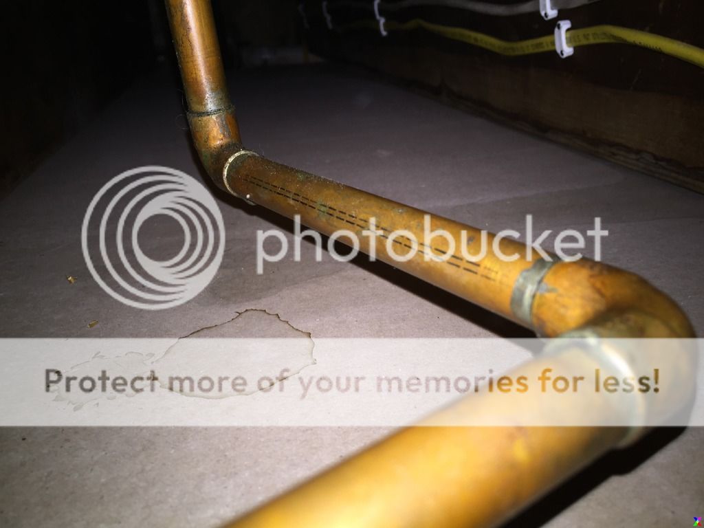

I traced the source to the upstairs bath baseboard. It was about a half a quart of water that made its way to the floor. It was a fairly big puddle.
The heating system uses Venturi valves that have 1/2" bent copper coming out. In order to replicate the path with strait pipe I had to use several 90 degree fittings.

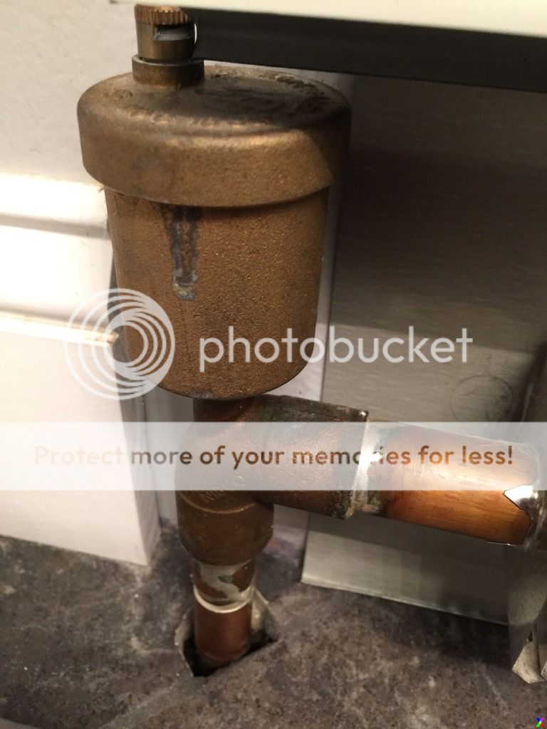

To purge air, I have an automatic bleeder on the baseboard. I always keep the cap closed tight as I heard people have had issues with them leaking.
So, I'm not sure if the leak is in one of the soldered joints or related to the valve. What's frustrating is there has been no issue for 6 years and it has been bone dry since I found the water last week. In other words, I can't replicate it.

2) from the pics, can you tell where the leak might originate? It does not appear to have gotten wet other than above the hole where the pipe enters the floor above

A one-time leak in six years leads me to think it is more likely that someone spilled water on the floor and it ran down the pipe to create the puddle that leaked through the ceiling. I don't think I would do anything at this point in time but to watch it carefully.

I've had automatic vents (looking just like the one in your pic) leak some water - seemingly out of nowhere - and then not leak again for quite a while. I suspect it's the little discs inside them that aren't sealing quickly enough after allowing for the venting of some air.
Some knowledgeable people on this board recommend manual air vents, in lieu of the auto air vents, when they are located inside (or above) a finished room.

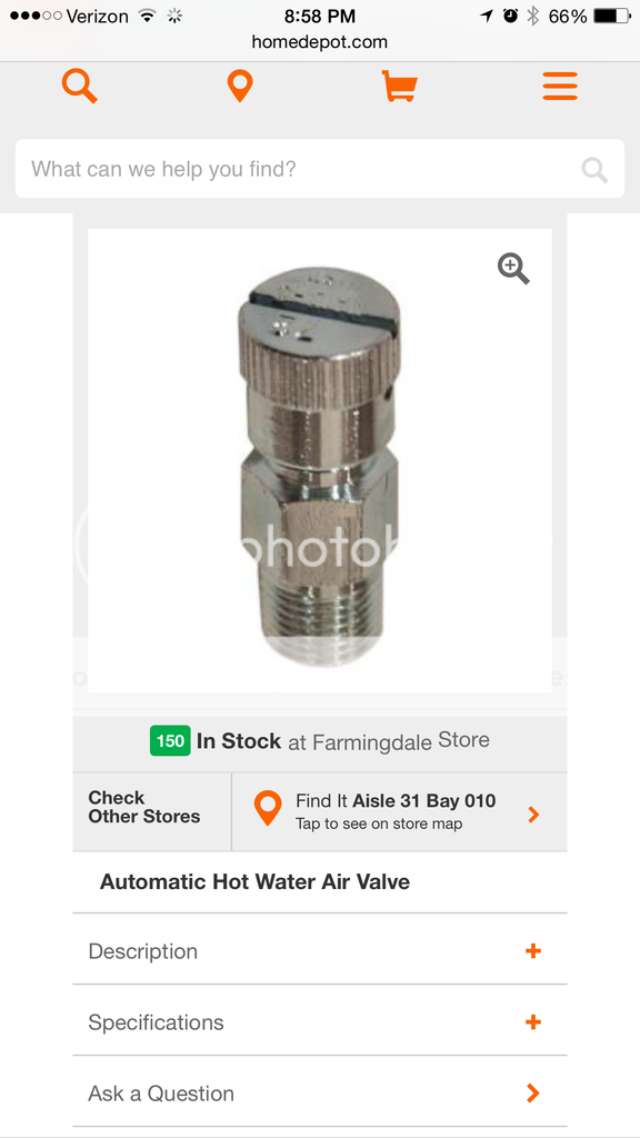

Is there a manual bleeder that fits the same threads?

I've seen basic manual vents on the shelf at the home centers around here that will fit your application, they look like this:

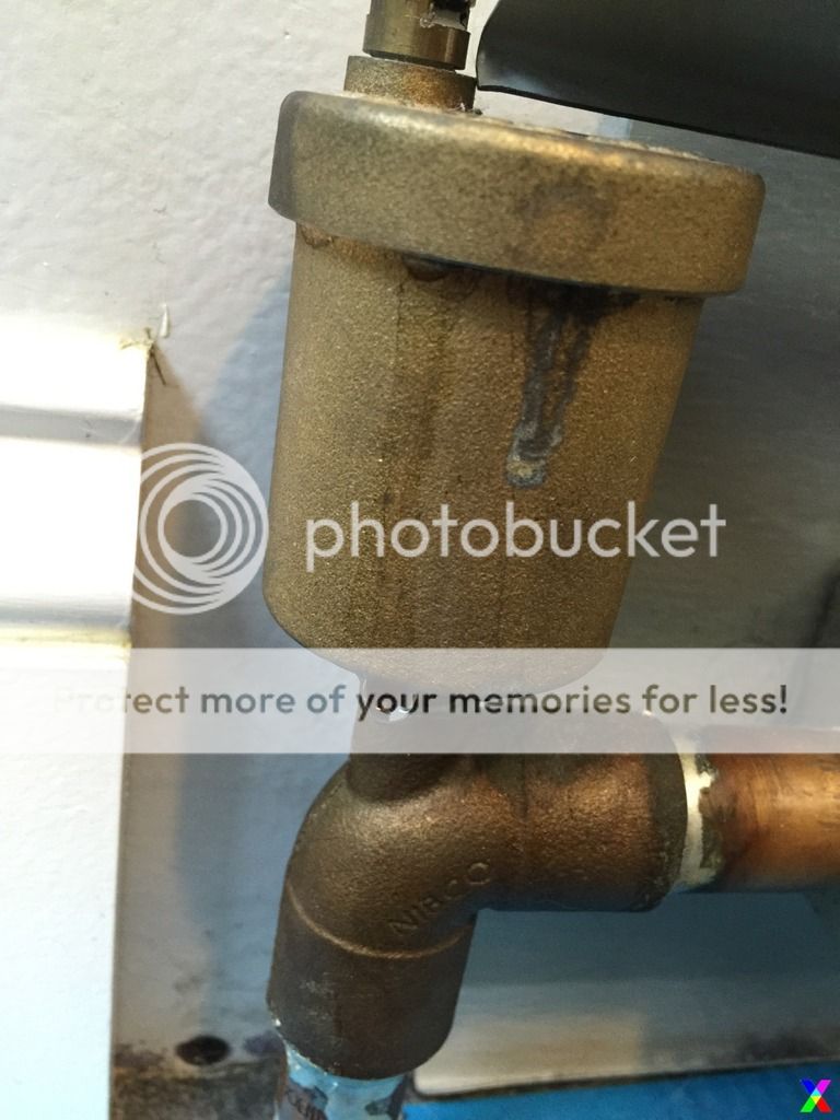

The pic looks like it leaked under the cap... ( that brown mark).. And I may see streaking...
Put in manuals.....

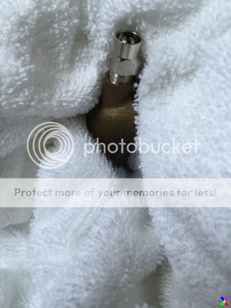

Ok I found the leak. It was coming from the top of the bleeder:
I replaced it with a manual bleeder but that is leaking at the threads (and it is tight). Should I have wrapped this with Teflon tape? Also, any trick to doing this without draining the system? I got soaked trying to do without draining.

Ok I found the answer in another thread. I turned off the water to the boiler and drained off enough to take the pressure to zero (or close). I wrapped the fitting with Teflon tape and everything seems to be working well.

Any joint, be it threaded, soldered or otherwise made, that shows any corrosion is most likely leaking. New water that is added because of a pressure drop allowing the pressure reducing valve to open and adding water will also admit air that is dissolved in the incoming water. Stopping all the leaks will stop the pressure from dropping and will stop the addition of new water.
