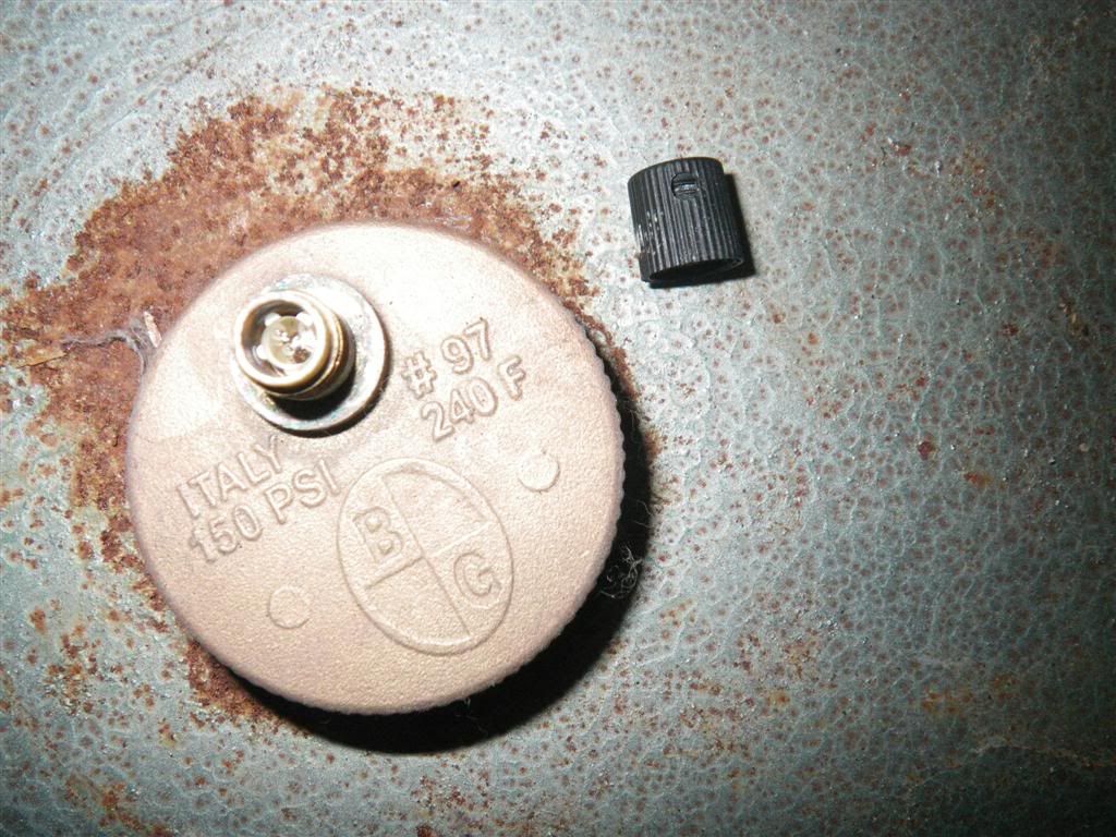

I have some air in my hydronic heating system. Not much. Not enough to create an air block. Not enough to hear it on the first floor. Just enough to hear some running water whooshing sounds on the second floor where water pressure in the system is the lowest.
I think I introduced the air into the system when I chemically flushed it few years ago when I was addressing the ketling problem. I don’t think I actually added air into the system, but it rather gased out from the make-up water.
I do have a simple air eliminator in the system – Bell & Gossett Model #97. It’s screwed directly to the boiler heat exchanger. See pic below:
I’m pretty sure the air eliminator is dead. There is some rust around it implying it was working at some point in the past, but it’s been bone dry for the last few years.
I see few choices…
1. Purge the air with a water filled bucket and a pump. Basically cycle the water thru the open water in the bucket allowing the bubbles to escape. Should work, but it will introduce some new water into the system. Also I lose about 2-5 psi per year, so I keep adding a bit of water every year or so, so eventually I will have the same problem.
2. Fix the air eliminator. I don’t have an easy place to cut in and install the new air scoop. Nor I really want to cut into the system. And I’m afraid to replace the existing one since it’s directly screwed into the exchanger and I don’t want to compromise that joint.
So I was thinking replacing the guts of the air eliminator could be acceptable alternative. It looks like the top could be screwed off and I could simply swap the guts with a new one. I think I could try to affix the body of it somehow and take the top off without putting too much stress on the eliminator/exchange joint. Is anyone familiar with this model and can confirm the guts can be swapped?

Is the black cap loosened? If it's tightened, the air eliminator won't function.

the cap is loose of course.

You probably have another bleeder valve in your system . . . . maybe up in the living quarters (at the highest point) ?
This B&G Air Vent looks remarkably similar to this Taco Vent (Made in Italy but no Model #) that I recently removed and cleaned up:
If your B&G is similar (like in identical), then the "guts" aren't much more complicated than a float similar to what you might find in a carburetor, except when the float sinks, it means air has been captured and it's supposed to let air out until it the Float rises and closes the valve:
You can probably bleed yours by manually opening the little cap to relaese any air, and close it back up tight if any water appears. You might need a straight pin (I use a Turkey Breast Pin myself) to push the valve open manually.
Sometimes the valve gets crudded (sp?) up with mineral deposits and ceases to work altogether, and some people leave the little cap on tight all the time just in case the valve gets stuck open, and leaks all over the place while you're not looking.
Many such air vents are not serviceable at all, and cannot even be opened up at all for an examination/cleaning. They're permanently sealed and it's expected that they'll be tossed when they get clogged.

I think mine could be clogged up as you're describing. I can remove the cap and nothing happens. No air, no water. It is a floater type and it looks very much the same as the one in your pics:
Can you push the valve down with a needle thru the opening that is under the black cap? I think that's what you're implying, right? i could try that.. but should I reduce the pressure down first? i don't want to get a hot stinky water spray in my eye

". . . Can you push the valve down with a needle thru the opening that is under the black cap? . . ."
To avoid that "squirt in the eye", you can align your pin first and then put a towel over the unit to block any such hot squirts.
If yours has a lot of mineral deposits holding it shut, it may not budge; and if it opens the accumulated air will exit first followed by water. If the spring doesn't shut it off, you'll have to put the cap back on tight immediately.

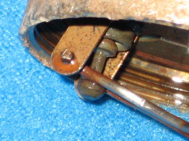

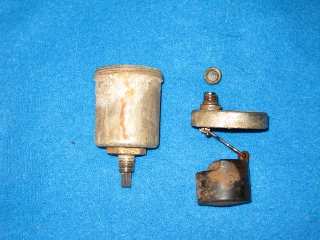

closing a loop on this one. i bought the same air scoop as i have installed and took it apart. took some convincing (vice+pipe wrench) to unscrew that puppy for some reason.
after that i decided to manually vent the air from the system and it went just fine. some air came out and then some water. i ended up screwing the cap tight for few days since water was slowly seeping out, but then i loosened it and was all dry afterwards.
no air in the system, nice and quiet now. and i have a spare air scoop just in case.
