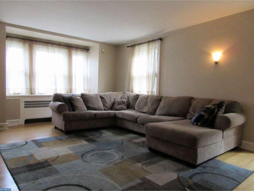

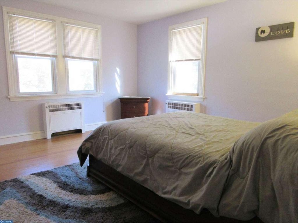

The system is based on a Crown boiler from 2006. There are eight radiators, 3 on the main level (living,dining,kitchen), and 5 on the 2nd floor (2x master bed, bathroom, small bed, large bed). Each radiator is individually connected to a supply and return main bus pipe that runs the length of the house. The thermostat is located in the dining room, about the center of the house and roughly 6 feet from a radiator.
The living room radiator is recessed, the remaining radiators are factory enclosed with bleed valves in the upper left corner of the front face.
