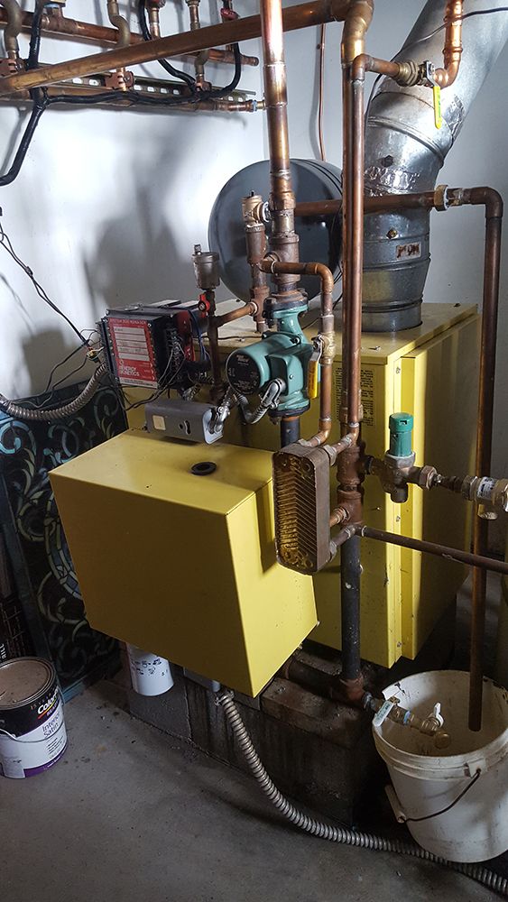

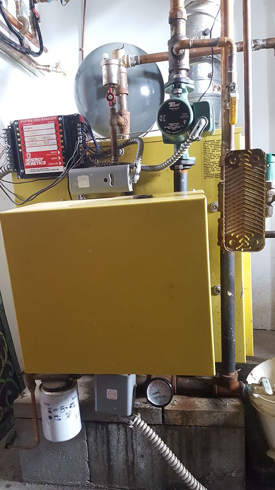

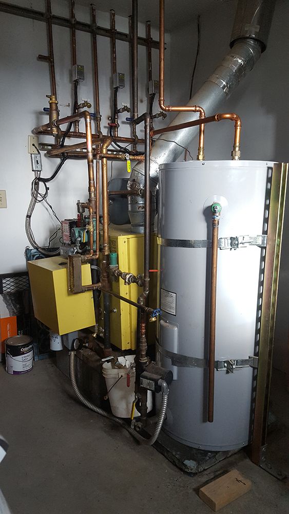

Hey spott, sure thing, pics below.

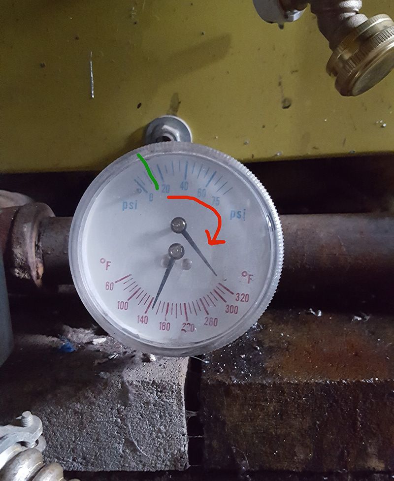

The system appears to be blowing the T&P due to pressure. The gauge is brand new as well, we replaced after the last gauge stuck on max after one of the episodes. I re-bled the system and topped up to ~13 psi, it ran smooth to around 180-185 and then started the pinging in the expansion chamber again and I could see the pressure gauge dancing around 15-18 psi as if air pockets are being created and moving around - then i shut it down, manually relieving steam/air from the T&P before it reaches 30 lbs. No banging in the pipes at any time during this procedure, and the zones are flowing/returning full hot.
Totally understand with the domestic hot water tank, just noting that as well since it is repeatable as that T&P starts leaking just as the pinging begins in the boiler expansion chamber around 180 degrees F.
The pressure gauge pic above was taken when cooling just before 6 old circ pump fins were found when removing the pump and assuming blocked flow, pipes in the house started banging like nuts. Now, similar issues but no more blockages found (and new pump).

I'm not sure if the members can see these pictures as photobucket no longer offers third party linking. I can see them as I run a special program to see all attachments. You can post them directly to the board or if that doesn't work.... let me know and I'll tell you where to email them to and I'll post them.
How-to-insert-pictures.
145 degrees and way over 100psi. Doesn't seem like the gauge is working correctly.
That gauge in your pictures looks to be installed in a pipe at the bottom of the boiler.
Isn't there a gauge directly in the boiler itself ?

At the time of the gauge picture, the system had been cooling down for a little bit - I did not get the temp when it was hot and blowing steam. With the fins stuck in the pump, the T&P had been releasing major blasts of steam and upstairs pipes banging hard enough to shake the floor - enough hot air was released via T&P to divot the Styrofoam block under the water tank (system had just been bled/refilled as well).. Basement was half full of steam, all of the windows fogged, gauge psi pegged. My best DIY-guy guess was that air pockets forced a spike to max the gauge..
That gauge has since been replaced (can see the new one in pic 2), and as far as anyone can tell that is the only gauge on the unit (welcome to Alaska systems). Now, similar symptoms, I don't let it get to the point above, but with no blockage in the pump and return lines hot it still seems to be creating air, since when I pop the T&P at 180 manually it's mostly steam..

It looks like you have a heat plate installed for your domestic hot water with a yellow handle Ball Valve closed. Any special reason why that is closed. Open that valve and see if it relieves the pressure in the tank. A little hard to follow lines. Does that needle go back or is it pinned.

Hey spott, in the pic the unit is off, the yellow handle ball valve for supply to the water tank has been open during all situations listed above - T&P leaks with it in the open position.
When we removed the gauge, some tapping on it brought it back to 0 from being pegged, but we did not reinstall (new gauge for good measure), so it was not stuck completely.

2 pics below are of the system refilled cold (14 psi) and of the temp where noises begin and I shut her off, 190 degrees F and ~20 psi. She does dance a tiny bit when moving up from 15 to 20. I also confirmed prior to filling the boiler that the (new) expansion chamber is at 12 psi empty, and once I fill to 14 psi, the expansion chamber also reads 14 psi.
So, I fire her up and she seems to run great, no noise, heat in the lines for whichever zone is open as well as to the hot water tank. The last round I did this with the garage zone open, yesterday I left all zones closed and hot water was the only call.

It sounds like you are making steam which means the water is not circulating. First off where is that Grundfos pump you mention. I only see 2 Taco's.
Does that vent on top of the boiler ever release any air. It doesn't look it would where it's located and with the pinging in the expansion tank it sounds like air is trapped right there and not letting hot water into the tank when it expands causing increased pressure.
When your boiler is cool tap that expansion tank with a screwdriver. The top should sound solid and the bottom half hollow or tinny. Then run your boiler up to temp and tap again. If your whole tank sounds solid it's bad. Either the air is out of the bladder or it burst.
I may be out in left field but that section of piping coming from behind the aquastat to the pipe coming off the top of the boiler where the relief valve is should be done differently so the air can be released from that vent. Do you have the installation manual.
That boiler only has 2.5 gals. of water in it so the circulator must run when the burner comes on and recirculate either through the boiler or the zones or else you may get steam which I think is happening to you. Air stops the water from circulating.

Hey spott, the Grundfos pump for domestic water is located in the other room, comes in through the darker line next to the hot water tank. For the last run I did, I shut off the valve behind the auto-fill to be sure no water was added erroneously during the test via autofill.

I'm guessing that Grundfos is actually a recirc pump to get hot water delivery to your faucets faster. You most likely have a good size home with long domestic water line runs.
