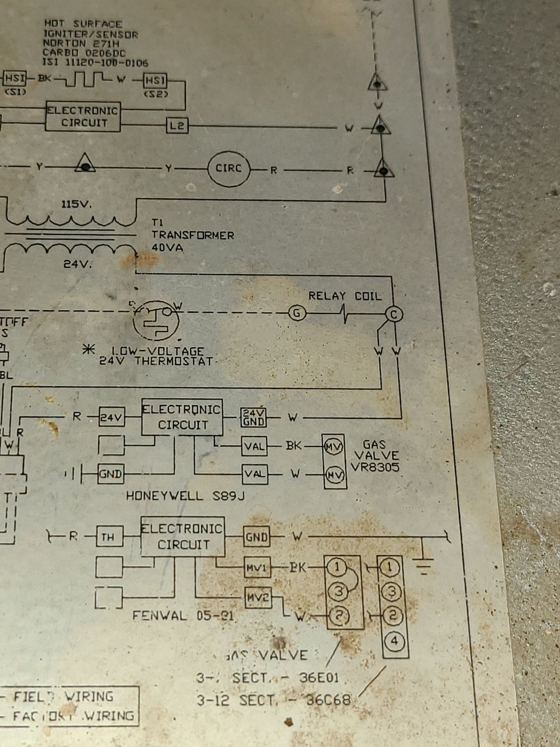

I have a Smith propane boiler that I can not figure out why it won't turn on. It has a new fenwal ignition module and the damper opens the evacuation fan comes on for 1 or 2 seconds the ignition module flashes once then nothing happens after that, I'm not getting any error codes, I've checked the igniter the rollout and the spill switch, I'm at a loss. Any ideas would be great.

I have a Smith boiler gb 100 that heats by radiant heat. The damper opens then the fan runs for about 2 seconds and the fenwal control box flashes once and then nothing. I've checked the igniter the roll out and spill switch with a ohm meter and they test fine. It goes thru the cycle 10 times and I'm not getting any error codes. I replaced the igniter module and it does the same thing. Any help or ideas would be great.

The draft inducer must be running and prove it's running for ignition to continue. You need to look at the inducer for a problem. Actually.... you need to check the end switch on the damper. That switch must close when the damper is open to supply 24v to ignition circuit.
Is there a wiring diagram on the unit or on one of the doors ?
Post it here..... How-to-insert-pictures.

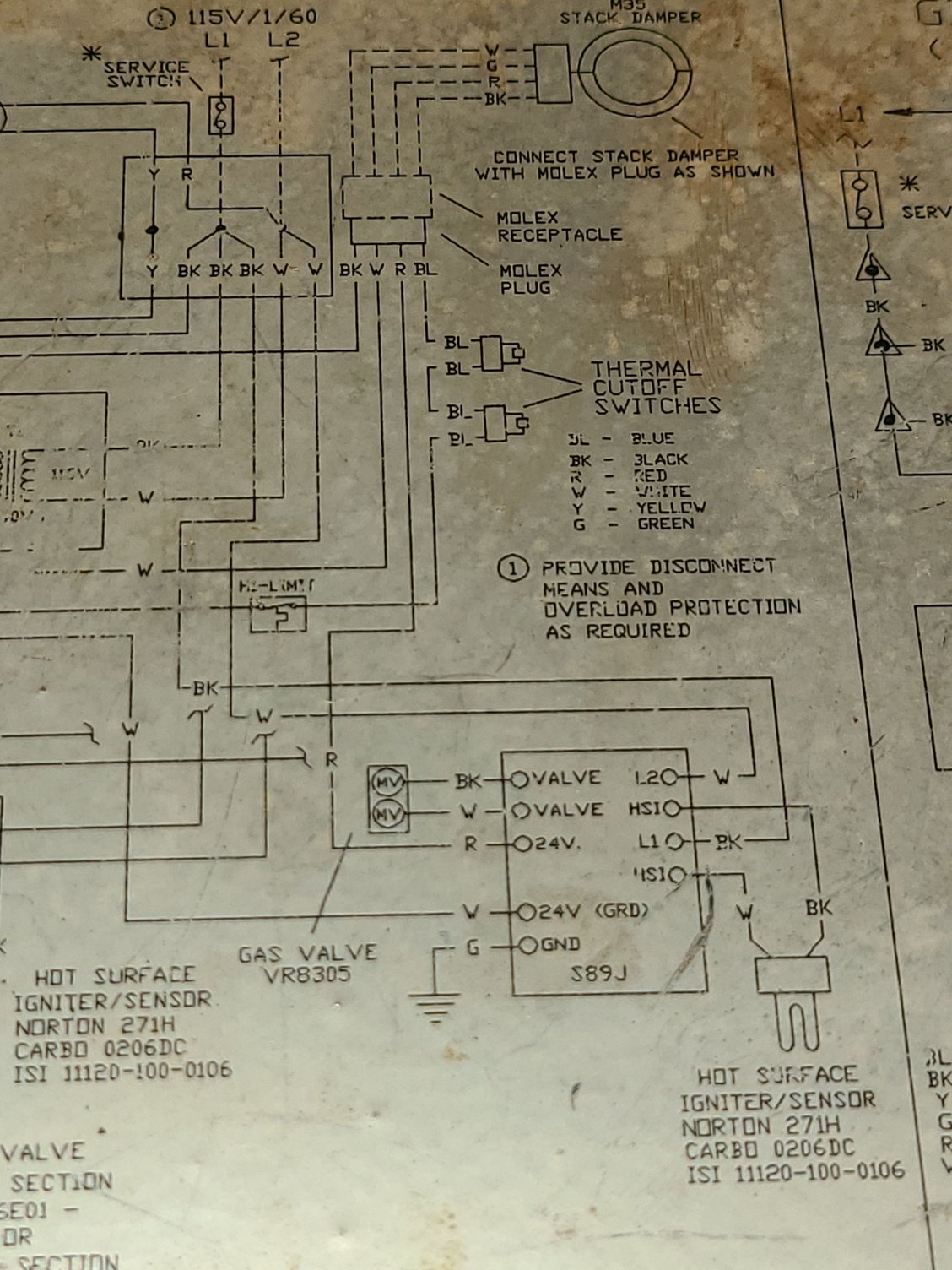

This is a Smith propane boiler a gb100 W-5 hsdi. I took several pictures that show the wiring diagram. The fenwal igniter says it has a 0 purge and a 0 interpurger

Can you post everything in one picture.
I can't read between them as the diagram is showing two ignition modules.
I don't see draft inducer in the diagram. I do see circ but I though was a circulator pump.
If you have a problem posting a large picture here... let me know and I'll PM you my email address where you can send it.

The manual illustrates several wiring methods and system types.
The actual diagram on the door is usually the correct diagram for that unit.
I'm assuming you are using the Fenwal/Honeywell system.
That manual is showing a powered flue damper with NO draft inducer.
You said the damper opens and the fan runs..... what fan ?

There is a fan on the exhaust before it goes outside it is about 3 feet above the damper. When the damper opens up the fan comes on for about 2 seconds. The igniter module is a fenwal 35-655927-001 . Also where the fan is there is a pressure switch . I will try take a picture tomorrow of the whole set up and try to get the wiring diagram all in one shot. Thank you for your help.
