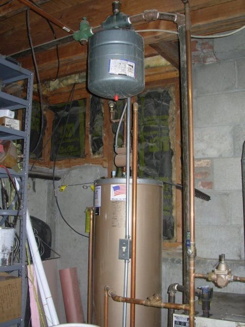

Adding LWCO to old HW Boiler
I've been doing a little reading on the function of an LWCO and it certainly seems like a worthwhile safety device that my 45 year old boiler system does not have. It sounds like ideally you want it to be in the boiler or failing that, as close as possible to where the hot water supply side exits the boiler and to be a manual reset. In my case, I think that would mean installing a T in the black pipe line, which would require removing the pipe from the boiler. I'm concerned that disturbing something connected for this long would be asking for trouble. Is there anything available that allows you to drill a hole in the pipe and install a fitting (tapping the hole, etc.). Are there any alternatives to mounting it here? Would it prone to false calls if mounted up near the inlet to expansion tank?
One more question, the system is run by a Honeywell R8182D triple aquastat which was replaced back in 2011. It works fine but I know these old relay boxes don't last forever. I also run an indirect tank off of the DHW coil if that matters. If you were going to replace this with a modern, solid state control, what would you recommend? Do the new controls have the smarts built in so an external LWCO isn't needed?

Not quite. The LWCO needs to be installed in piping directly connected to the boiler, but above the elevation of the normal high level of the water.

How about just before the pressure relief valve?

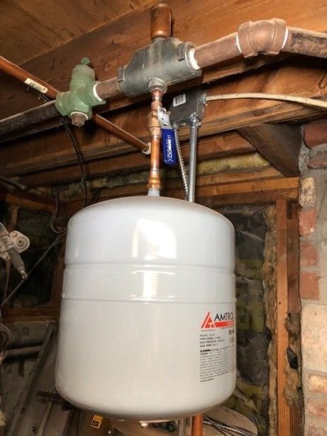

Thanks very much for the info guys. I read up on both, the Tekmar 256 and the Honeywell 3250P. It would be nice to upgrade the whole enchilada (including ODR) for only $156 but I get the impression that the Tekmar 256 is an ODR only and I would still need an aquastat. I think Doug meant to use it with my old aquastat. It is clear that the 3250P is an aquastat and you must buy the add-on ODR for that capability.
SInce I do have a zone in the basement, I would like the piece of mind an LWCO would add and I'm hesitant to leave the water feed open. Even with the 3250P full set up, I think I would still need to break into the plumbing to install the 'electro well' for the LWCO, wouldn't I?
As for the aquabooster, you were 100% on that (coil cannot keep up with demand). When I finally have to replace this boiler, I'll go with an indirect.

There is no need to alter your plumbing with the 3250. The new well you would need in order to activate the LWCO feature will go where the old well is now for your current aquastat. Remove existing well and install new one in boiler in same location.
