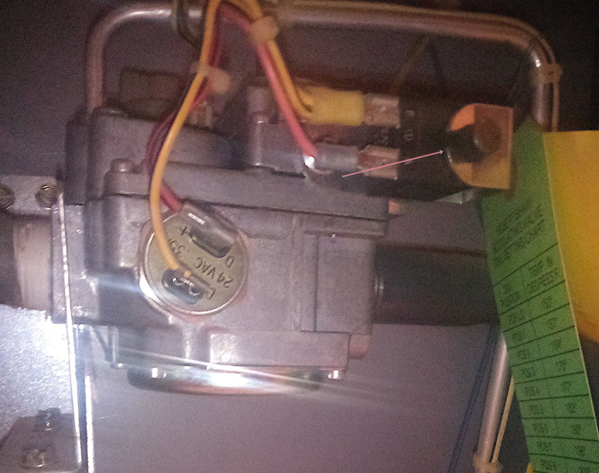

Hello everybody.
It's a 2 part question.
The heater is a Raytherm H1-0330
First question:
I turned off the heater with the toggle switch because of air in pipe noise, like dying elephants (not the issue). It wasn't heating at the moment.
Done it before without any problem.
This time when I turned it back on the electric came on but not the burners. Switched it off, then back on and nothing.
However, if I push the red reset button it comes on fine, heats to thermostat temperature, kicks off, but won't come back on when room temp drops.
If I push the red reset button, it heats again just, but repeats this situation.
Question 2.
The little red reset button is off to the side out of this picture. What's this silver metal button where the arrow is? I attached a picture...

Hi, hard to tell from the pic, what is the mdl # of the valve?

It says 35A. It that's what you referring to.

That’s not a button. That appears to be the pilot solenoid.
what red reset button are you pushing? The model you posted is for a boiler not a furnace.

Thread moved to boiler forum. If it heats water it's a boiler. If it heats air it's a furnace.
35A is a solenoid.... not a gas valve.
That looks like an old Honeywell gas valve and there should be a much longer part number on it.
I keep getting linked to a pool heater.
Is that the complete model number off the ID tag ?
