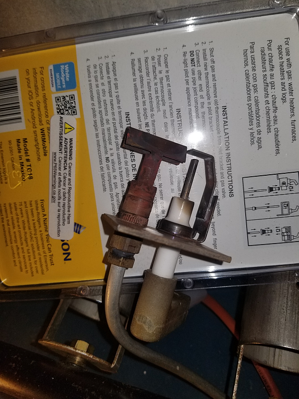

Smile Wiring help needed for pilot control module
So the parts came in and I am ready to replace the intermittent pilot control module.
How do I Prepurge and Trial for Ignition timing dipswitches
Do I wire in exactly as the old one or should I not connect the 24V. I ask because the manufacturer sent an email with this ...
IMPORTANT
  • "TH-W" terminal should be connected to the "W" terminal from the thermostat
  • "24V GND" terminal should be connected to the unswitched leg of the 24VAC transformer
  • "24V" terminal should NOT be connected unless you have a functioning vent damper connected to the "P1" vent damper plug. Note that once the module works with a vent damper for 10 ignition sequences, it will no longer work without a functional vent damper after that.
  • Read the instructions to set Prepurge and Trial for Ignition timing dipswitches before applying power. Once the module starts the 20th “Call for Heat”, the control operating sequence is permanently locked and cannot be reset by resetting the Dip Switches.
Thanks!
Old Pilot controller
Pilot and Thermocouple
Replacement I ordered - looks too big
Replacement I ordered - need wiring advice

What you bought was a thermocouple, what you needed was a pilot assembly. Below is a sight where you will find examples of what you should have bought. If you call them and give them the model number of your boiler unless you have the parts list with the number they may be able to help you.

Thanks, spott - I looked it up and called them; to me it looks like this one
https://www.supplyhouse.com/Utica-Du...Pilot-Assembly
After providing the model, etc for my Utica, they think it is this one
I don't see this one in there. They recommended I call Utica and provided the ph nr.
Reading around for the connections, it appears I should use the TH-W terminal for 24v and leave the 24v terminal unused.

I have installed it as per page 8, I have the 8600M. I used the TH-W and it kicked off the furnace once and since then it gets the heat signal, the squealing noise happens (damper opening I'm guessing) and no spark noise.
I also received and installed the pilot assembly unit a few hours ago
I installed both parts at the same time and it has worked only once since, a few hours ago.
