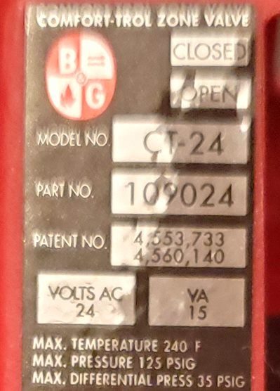

There is only one relay like that one, I have 5 zone valves upstairs and 4 down. I took a picture of the zone valve case, they are kind of different they work off of a heather that pushes out a pin to open the valve.

The CT-24 wires like a standard three wire valve.
1 - power open
2 - common (T)
3 - T

Nine zone valves ??
How many thermostats ?
Typically on a system like this a controller is used. The reason for that is you are not supposed to mix transformers within a system. With nine zone valves you should have three transformers according to the zone valve manufacturer. If you do have three transformer that means those transformers will be sharing a common leg. That presents a phasing problem.
On the relay the A1 and A2 are the coil wires. Technically those two wires must connect to all nine zone valves to monitor when they open.
I consider myself a wiring expert but I may not be able to help you here.
