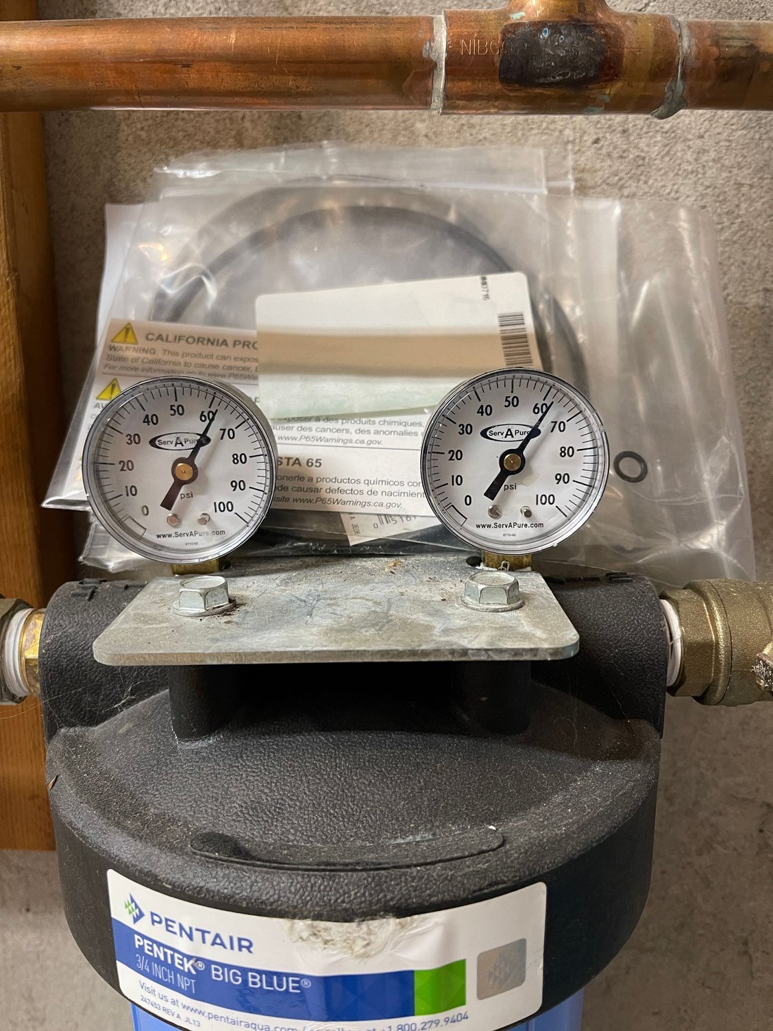

When the service guy came three weeks ago, he did check the pressure independently with a gauge like PJ’s. 20 psi did check out. He said he also checked the expansion tank and said it was ok too. Just now I checked it and it is hollow at the bottom, and full at the top. What should the pressure of the tank be? There is not pressure gauge on the tank, just on the boiler itself.

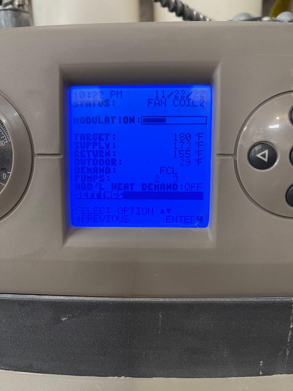

The display on the boiler indicates the following:
TARGET: 180F
SUPPLY: 173F
RETURN: 155F
OUTDOOR: 29F
DEMAND: FCL
PUMPS: 2 3
ADD’L HEAT DEMAND: OFF
Thanks for all your input!

Not sure if this is useful, but this is the domestic pressure on either side of my sediment filter.
This is display from the boiler. Which supplies hot water to my hydro air system and indirect water heater.
