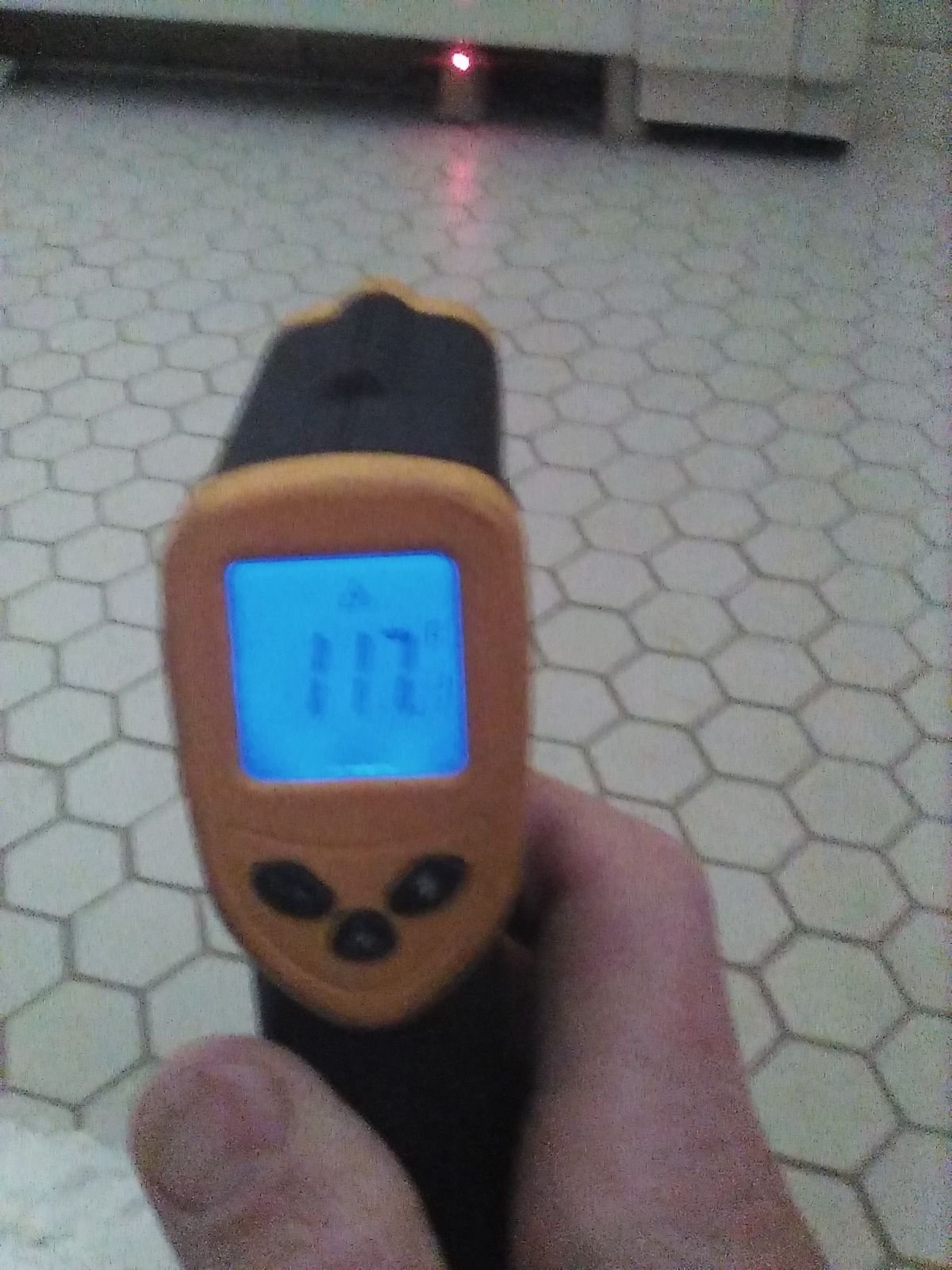

In the 1970's I rented an apartment that was the first floor of a two-family house. Each unit had its own oil-fired forced-air "octopus" furnace that shared a common return via the basement space. Each unit had a separate contract with the oil company. I set my fan switch to come on at a very low temperature and the fan ran almost constantly. An unintended effect was that I got the benefit of all the heat in the return air from both units. My oil bill was about $75 for that season during the "oil shortage". My landlord who lived above complained that his own bill was the most expensive he ever had for his own unit.
Just for fun I took these photos of the temperatures of my radiant floors today. The room temperature is set for 69 degrees, the outside temp was 35 degrees, the boiler output is 150 degrees:
Residual radiator temp in dining area. Zone not calling for heat.
Floor temp in dining area with radiant heat. Zone not calling.
Floor temp in area that does not have radiant.
Pipe temp at baseboard in bathroom. Same loop as radiant. Zone calling for heat.
Radiant floor temp in bathroom.
Maybe this will help the OP in setting boiler temps.
Clarification: My boiler set point is 150 with a 30 degree differential so the supply temp to emitters will range from 120 to150 minus any pipe losses along the way.
