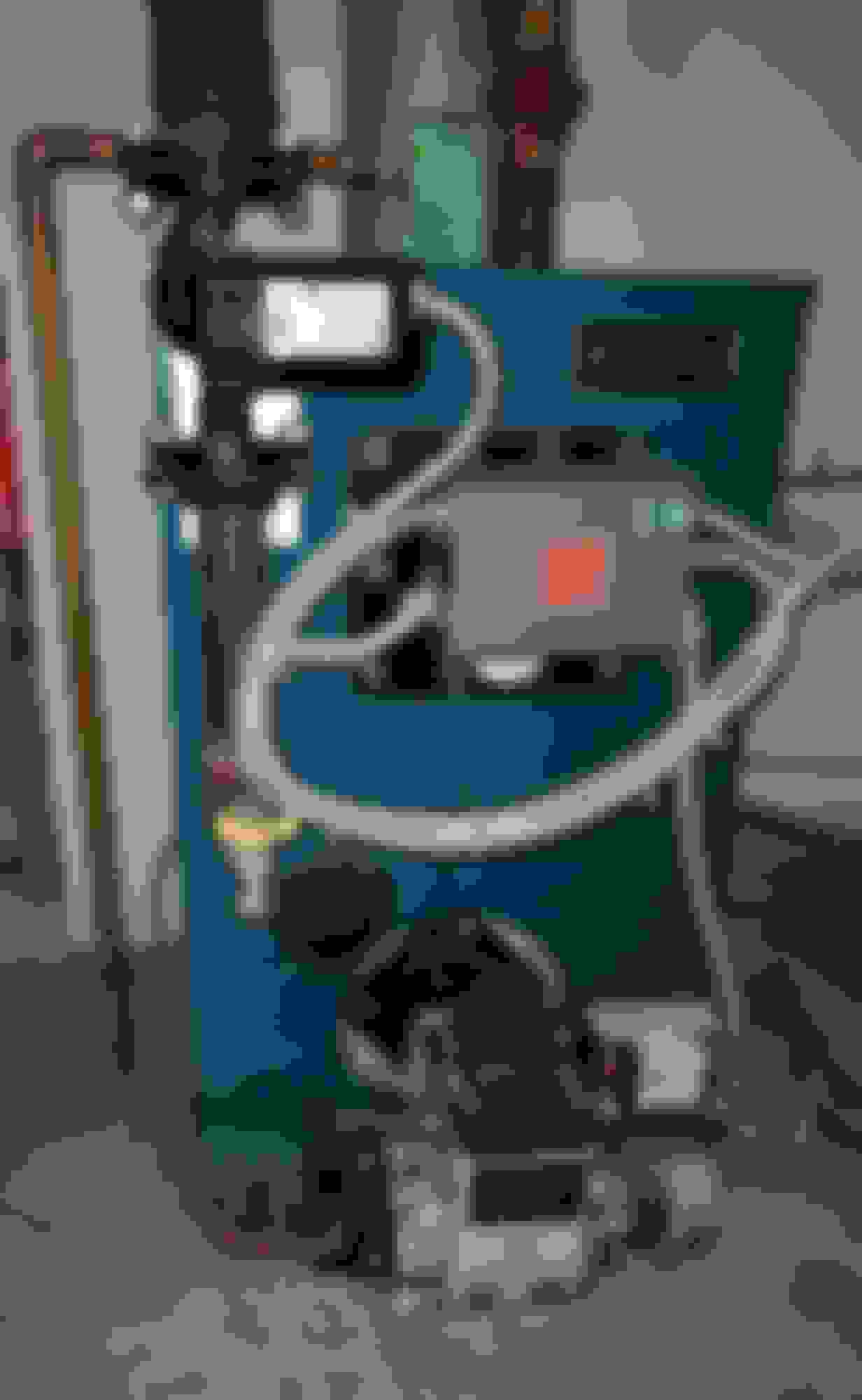

Boiler acts like its on a timer
Hydronic baseboard heating system in single story house with a basement runs for 4 minutes then off for 8, consistently until getting up to set temp, which literally takes hours, even for only a couple degrees. Runs longer only on the first call for heat in the morning. There is only 1 thermostat so only 1 zone. I've checked all settings on the thermostat.
The aquastat has HI limit set to 180 with 10 differential and no LO limit because it's heating only, not also domestic hot water. I've bled all the baseboards that have a valve and only water comes out, no air. The radiators in the 2 rooms in the basement do not have bleeder valves. All baseboards are warm/hot, no cold spots that we can find.
I do occasionally hear crackling sounds downstairs at the pipes in the unfinished ceiling that's the living room floor, a little way from the boiler and sometimes at the boiler, that I'm guessing may be air that's not working its way to the valves? There are some blue faucets in the pipes running toward the living room, if that makes a difference.
Any ideas why the boiler reaches the HI limit in only 4 minutes and shuts off, then cools down the 10 degree differential before coming back on and repeating? It does seem to run more "normally" once it's reached set temp. I've mentioned it to the service person for several years when he's here for the cleaning/tune-up and he says this is normal. This is the first year I decided to time the on/off cycles and realized it was that short.
When I ask the service company, they want to bleed the entire system to "reset it", instead of checking to see if all components are working properly. Does this make sense? Definitely expensive at $149/hr. I've decided to try to do more research first.
Oil fired Beckett RSA85LN-TB low pressure boiler,
Beckett by Honeywell R7184B Interrupted Ignition Oil Primary Control,
Beckett Electronic Oil Burner ignitor 746001,
Beckett 21805 burner model K37MYBKN-597,
Honeywell L7224U aquastat,
Taco Cartridge Circulator model 007-F5, (by boiler controls),
Bell & Gossett NRF-22 Circulator (higher up on other pipes),
Lux 9100uc programmable thermostat.
Welcome to the forums.
Your thermostat activates the aquastat.
The pump and burner come on together.
The pump runs continuously during a call for heat.
The burner cycles to maintain the 170-180f water.
Is the pump running continuously ?
Is it just the burner that is cycling ?
You should be able to see what's happening with the water temperature by watching the gauge.
It sounds like a circulation problem. It could be airbound causing the pump to pump nothing.

It is not uncommon when coming out of thermostat night setback for the boiler to hit a setpoint temperature and turn the burner(s) off. The pumps run continuously until the setpoint temperature is satisfied. After that all would shut down until the thermostat demands again. If this is happening the boiler is more than likely oversized, zoned or both.
How may thermostats do you have?
The OP said one thermostat but two circulators.
That could be DHW (domestic hot water) tank setup.
Calling for heat means the room temperature is under the set thermostat temperature and the system should be in heat producing mode.

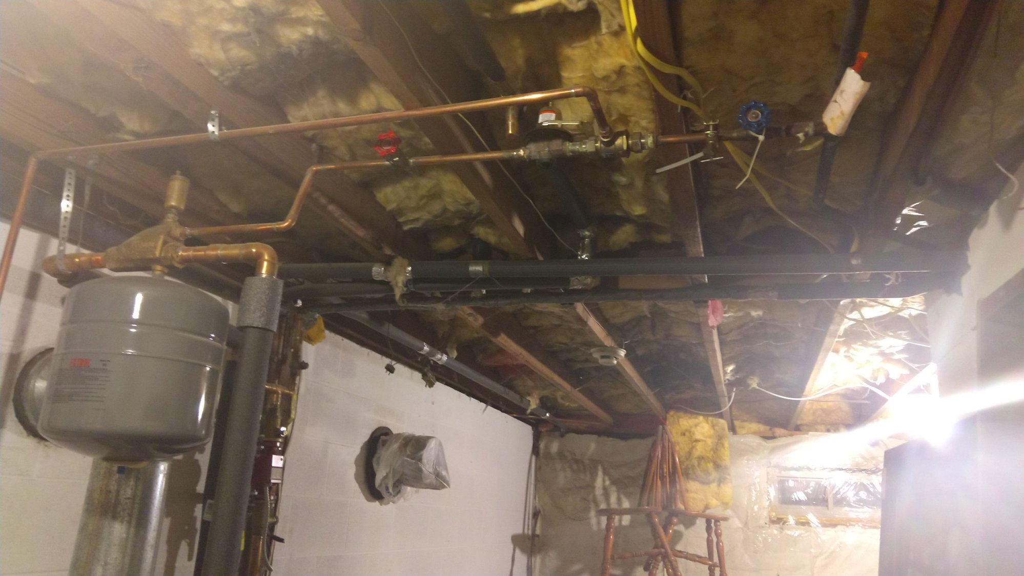

Join Date: Jan 2023
Posts: 41
Received 0 Upvotes
It does appear that the circulator stays on until setpoint is reached. I also experimented with changing the Hi limit differential from 10 to 15 and it extended the run time from 4 to 5 minutes and the off time from 8 to 11 or 12 minutes. Does this indicate anything?
It looks like you have pumps on both the supply (red) and return (black). It that correct? Do they both run at the same time? Usually two pumps on a single zone system (only 1 thermostat) indicates a primary/secondary system with closely-spaced tees. (Usually high-efficiency condensing boilers.) Not often used on an atmospheric boiler like yours. Your piping does not look like a P/S system.
Setting a larger differential causes the boiler to stay off longer after hitting the set point. That will extend the OFF time since lower temperature water will be circulating. And will cause the run time to be longer to make up for starting at a lower temperature. As long as the water temperature is enough to provide a satisfactory level in the heated space, longer run times are better to avoid short-cycling. However atmospheric boilers should not be run below certain temperatures (usually 130-140 degrees) for extended time to avoid condensing. My Burnham ES-2 boiler is designed to run as low as 100 degrees, I run it at 150 degree set point with a 30 degree differential on a large mass cast iron system that can drop to 100 when starting at 120.
AFAIK the stub-out on the supply pipe near the lower flange of the red pump does not connect to anything? The connection above it appears to go to a loop not connected to the red pump. If so, that loop will be getting flow due to the black pump. Could this be a system that had one zone/loop with a pump on the return and a two loop addition with a supply pump?

This looks like a separate heating loop that gets flow from the black pump on the return line.
Have you tried listening for pump operation by placing the tip of a screwdriver on the pump and the handle against your ear?
The supply pipe with your red circulator has a yellow ball valve on top of the pump and then the pipe splits to 2 feeds with a throttling valve on each pipe which I believe are only 3/4's open. Those valves adjust with a flat screw driver to open fully. You can loosen the nut a little if needed to bre able to turn screw and then retighten. You want thay line straight up & down for fully open going in direction of pipes.
This will give you more flow to your emitters. The 2 pumps are unusual. Do you have any idea why 2 were installed.
The installation is not properly installed no matter where the pipes go. There should not be one pump on the supply and one on the return. If in fact there are two zones and someone disconnected a thermostat an connected both pumps to the same pump terminals the piping is incorrect.
You are going to have to see where the returns come back to the returns. They are all above the return.
I see the supply manifold or what ever it is has another pipe off it. Where does it go?
The pump on the return (black) is the arrow pointing down? The red pump arrow point up?

It's a maze of pipes and I don't know how to tell what's coming and what's going. Do these pictures help? I have no idea why 2 pumps.
If the red pump is sending hot water through the house, my guess is the branch to the right is going toward the kitchen upstairs and the one off to the left is going down the hall toward the bathrooms upstairs. The one behind the branched pipes that goes up and to the left against the wall goes around the corner and toward the upstairs living room, but splits into 2. The pipe that's behind and above the split above the red heading to the right, doesn't appear to be attached into the boiler pipes at all but must be somehow because it's warm. That's the direction of the far side of the living room. I have no idea how hot water gets to the 2 downstairs rooms but they are the same direction as the pipes to upstairs bathrooms.
This is how the pipes were when we bought the house in 2009. I know that for years it heated the house fine, but the last several it has not.
I have not tried listening to the red pump with a screwdriver but know it does vibrate, just much less than the black one right at the boiler.
On the horizontal pipe at the top.of the pipe that is vertical above the black pump there is an arrow built into the pipe that says 'water' and points toward the elbow.
I hope any if this makes sense. I tried to answer all questions as best I can.

Unless the system pressure is low this is not causing your problems. What is system pressure when boiler is off for a while? What is pressure when boiler has run for some time and is hot?
If you cannot read gauge, see Sticky at top of forum about pressure gauge.
Water can be pumped into emitters (i.e. red pump) or away from emitters (i.e. black pump) but should not be both on the same system.
You have a SUPPLY pipe coming off the TOP of the boiler going into your RED pump. That pump is sending water through a TEE fitting to 2 pipes which go to emitters and then return to the RETURN pipe with the BLACK pump. You also have a third supply pipe with the green or black handle valve that comes off the main supply after the RED pump which means that line is controlled by the BLACK pump on the return line.
Unless I'm missing something, what I'm seeing from your pics is the SUPPLY coming off the top of the boiler, feeding those 3 supply lines, up to an elbow and going to the extrol tank and to the BLACK pump and back to the boiler. Is that correct or does it separate somewhere as it should.
Spott: I think you are correct. I missed that.
It now looks like a weird version of a primary/secondary system. (Without the second pump, I would have called it a bypass.)
If p/s it could work like this:
Black pump is primary. Water circulates through supply “manifold”, through air scoop and back to boiler. Return from emitters is connection with green valve that passes behind red pump and connects to “manifold”. Red pump is secondary circulating through double connection to emitters and back through return connection. Short section of manifold pipe between red pump stub out and return stub out is bypass and may be acting as “closely spaced tees”.
Primary circulation could account for short cycling. I will research further for p/s system on atmospheric boiler.
This suggests that it is not an appropriate application of p/s.

This is the gauge after boiler has been off 1.5 - 2 hours for night setback. Aquastat says water temp is 103 degrees. Is it concerning that it looks like there's water inside the gauge and it's below the aquastat?

That has to be the worst attempt at a p/s piping setup as I've ever seen. With the sysytem you have there is no need for it or even a bypass is not needed. You would do yourself a service if you redid the near boiler piping and you would most likely get more heat.
With the air scoop on the return pipe above the pump I doubt that air vent is even doing anything with that pump pulling so much. You can put extrol anywhere but the air scoop goes on supply.
You should use the nozzle that is called for, at least the spray angle and the spray pattern. Your burner wants a .85x70B. The 70 is the angle and the B is solid spray. The .85 is the gallon per hour it dispenses. You could go down to a .75 if you thought the boiler could pick up quick enough but .60 I believe requires another head on the burner. The head has fins that allow only so much air. Your head I believe is an F3. A.60 requires an FO head in order to burn properly. Your burner sticker says .85x70B YET the boiler OEM specs say .75x80B @ 140psi pump pressure.
Your nozzle is pretty important on your boiler because it's a steel boiler or dry base as they're called. If the flame hits the firebox and ruins it you have dry steel behind it which could burn through.
Sometimes you can take those covers off. Dry it and keep an eye on it.

justcantdoit: When there is heating issue, one of the first, simple things to is confirm venting of air at high points of zones,
Photo in Post 17 shows auto venting valve above expansion tank. Venting valves or manual/purging at boiler level cannot remove all air in high elements of many systems. Those valves often leak and have to be sealed off.
DH Post #6 outline easy, long term venting:
Unvented/bleed air in system makes noise and reduces heat transfer. Solution is installing $12 Watts auto vents at high points of each zone, Are very reliable, easily opened for service. Has black knob on to manually confirm venting or turn off.
https://www.supplyhouse.com/Watts-05...Vent-3679000-p

Thanks to Spott for addressing the issues so clearly, especially the nozzle. Oil is not in my expertise.
Not really, especially if you DIY it. A professional would probably not do it as follows but a fairly simple DIY solution would be:
This does not address the air scoop issue but may be satisfactory once air is purged from the system by bleeding (NOT flushing). Moving the air scoop to the supply side will entail more piping work and would eliminate the need for the suggestions above.
If not DIY get some quotes or suggestions from your service company or others and come back for our opinions.
Your gauge readings look OK. The hot pressure reading is approaching the 30# limit. If it goes over then the safety valve will open to relieve the pressure. That will result in a discharge of water to the floor but not a flood.
For the time being, I suggest you use a 180 degree set point and 10 degree differential to keep the water going to the convectors as hot as possible. Also use overnight setback temperature of not more than 3 to 5 degrees less than daytime to reduce recovery time.
Wouldn't redoing the piping be very expensive, especially with copper tubing?
- Remove red pump and replace with a flanged nipple between the existing flanges and valves. Since the valves are there this could be done without draining any water.
- insert new valve on vertical pipe between supply and return stub outs. Could be Shark-bite, soldered copper, or copper compression. Keep valve closed to isolate supply and return flows. Again by closing supply and return valves the amount of water to be drained to do this work can be minimal and limited to the area of the near-boiler piping. Draining and/or flushing the system should be avoided.
