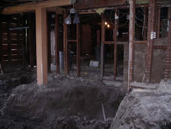

Here's the house we're starting with.
Backstory: 1920's construction, built on top of a landslide in the middle of earthquake country. The house is as much as 8" out of level, with a sagging living room floor due to a missing vertical support down below.
Project scope: construct a liveable space on the ground floor for the parents to reside, saving them a 20' climb to the bedrooms. Beef up the foundation to current seismic standards. Level the house. My wife and I will move in upstairs. The middle floor will be common access -- kitchen, dining room & living room.
This is a few days after construction, and the wood stairs and front porch has been demolished.
The trench represents approximately how much farther we're digging down to get below the landslide, onto stable dirt. The new foundation slab will take 18" of this. The house itself will be lifted to accomodate demolition & construction, than lowered back to its existing height.

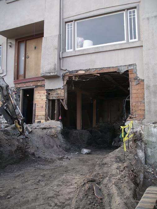

This is the access hole the contractor poked into the house to begin preparation for the dig-out and lifting.
Here is a good illustration of the existing floor height, and how much farther down we're digging.

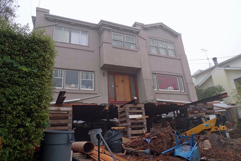

A shot from the front, with the house lifted off of the old foundation.
The old foundation wasn't substantial, and was badly failing. I'm told the house was mostly off the foundation along the rear.

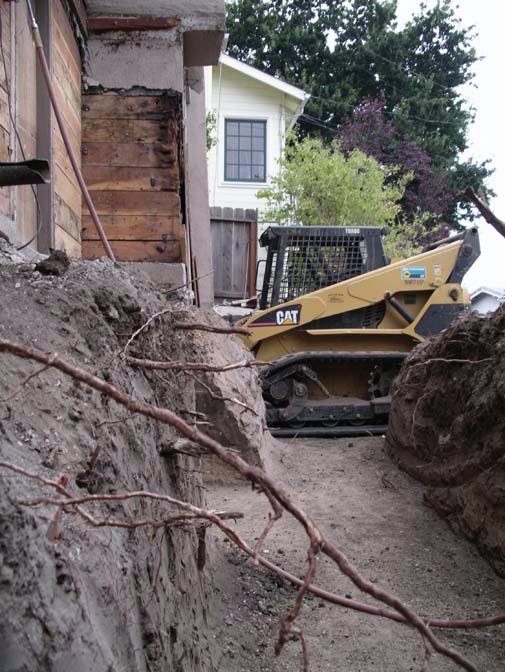

A challenge was the neighbor's house, which is very close. Our project is essentially digging an 11' cliff right up to the other house's foundation (also failing).

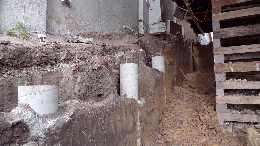

To shore up the neighbor's property, our contractor bored down and poured hold-back pillars. This was also done along the back side of the house.

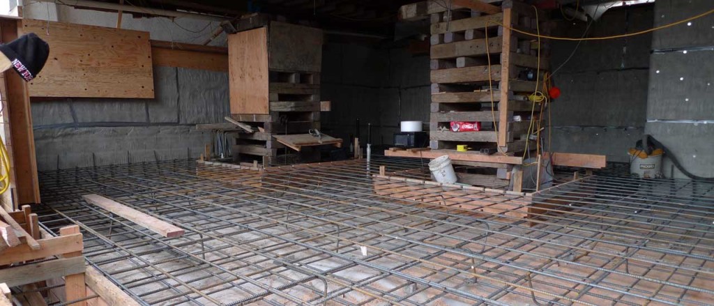

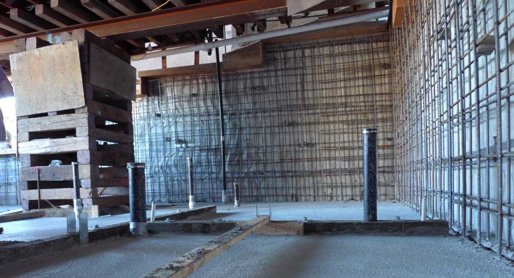

Jumping ahead, this is just days prior to the pour of the main slab. The 18" slab is heavily reinforced with steel. A second big concrete pour will fill in the three crib pits and tie in some work at the front of the house that's not yet ready.

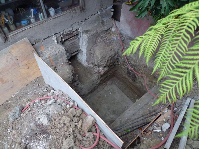

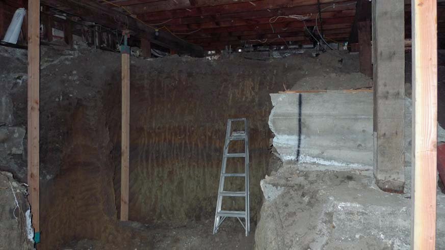

This next series focuses on the back wall, underneath the kitchen upstairs.
Prior to lifting the house, dirt sloped up to meet the ceiling at the back. The contractor dug this out using handheld power tools. This was done by hand to make way for the steel beam & crib needed to lift and support the house.

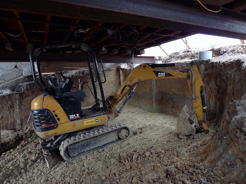

After lifting the house, the big guns came in and started mechanical excavation. This is the same wall, dug down about half way.

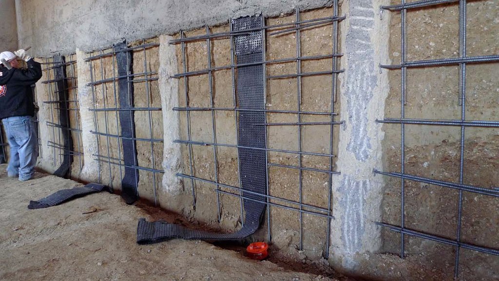

It was dug out in two phases. The dirt was stabilized with shotcrete and steel tied into the pillars. Notice the light colored stripe across the dirt. This is the separation layer between stable soil (below) and the landslide soil (above). We're now clearly below the landside, into "good" dirt.

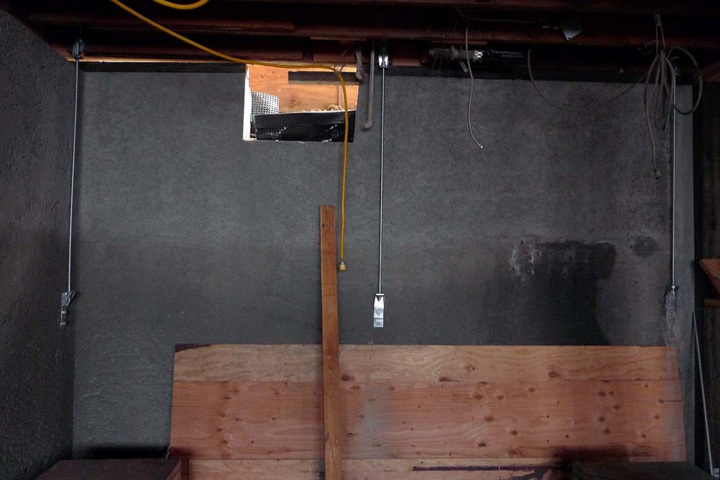

The walls were reinforced with a double layer of steel before application of structural shotcrete. The concrete is 12" thick along the back, and 8" to 10" in other locations.

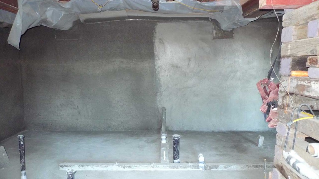

Here's the finished back wall, from the same perspective as the first photo. The shotcrete has been smoothed on the right, as this will be a utility room. On the left, it was left rough, and we will apply a nicer finish to it after completion.

Three pits were dug in the back yard to place cribs to support the steel beams. Concrete pads were poured inside the pits to address the issue of soft, wet dirt.

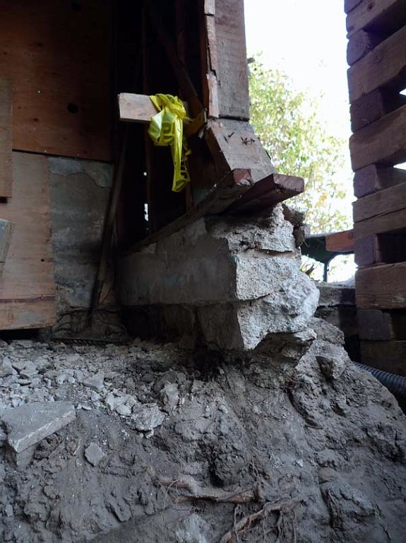

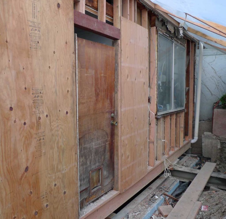

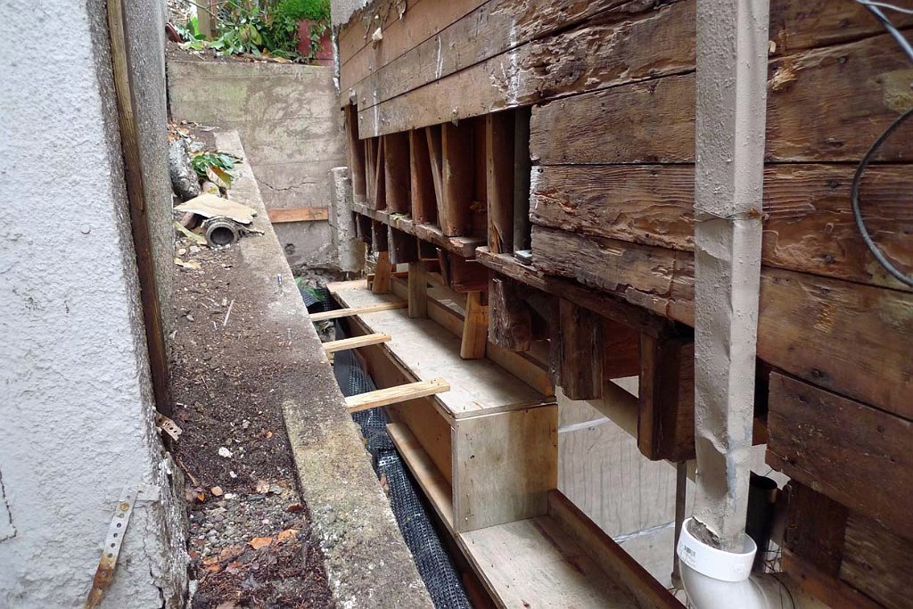

After lifting, this is the same corner of the house as viewed from the side. We had a lot of dry rot in this location.
The back wall was reframed to support the weight of the house upon lowering. We still have much work to do in this location, including replacement of the rotten window.

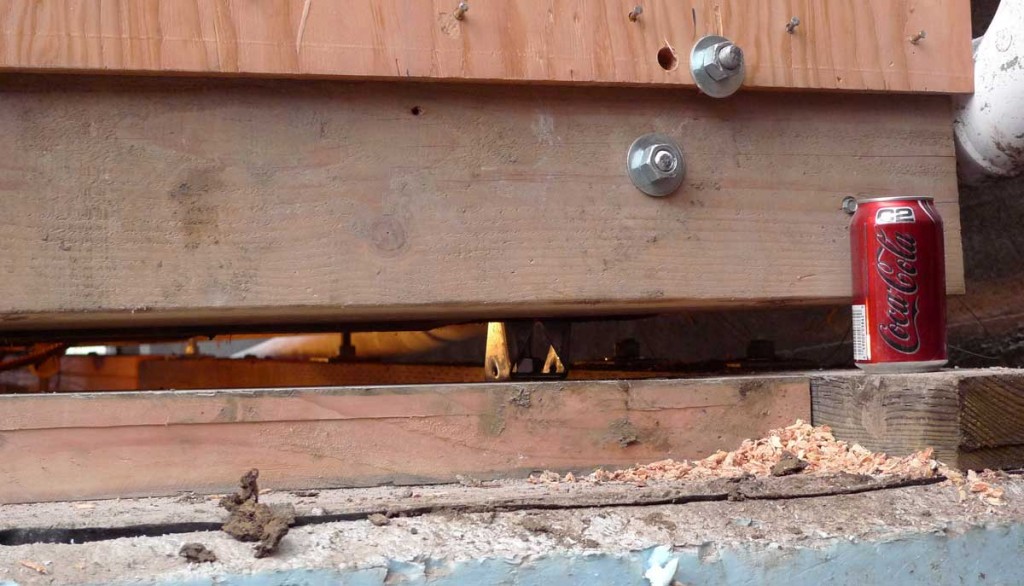

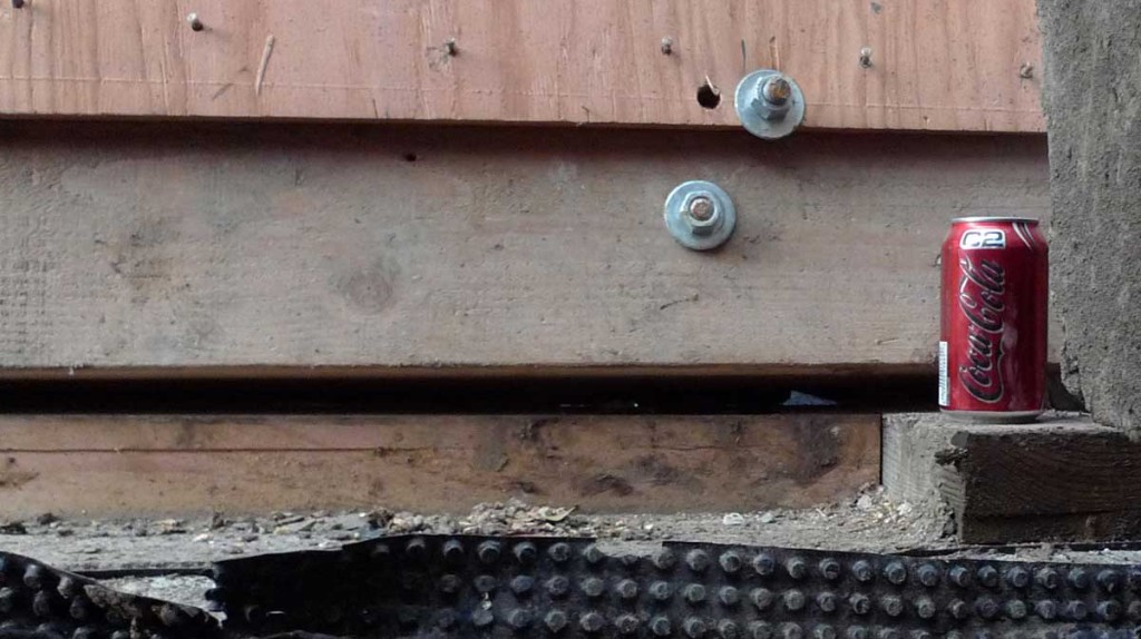

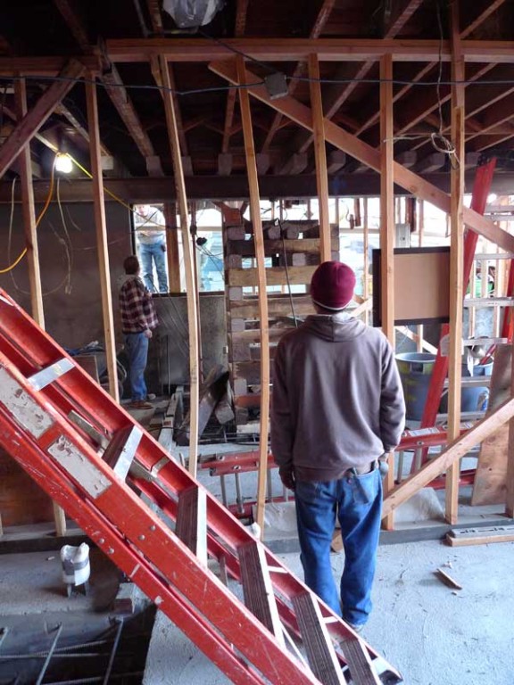

Because of the warped floor, we had a problem when setting the house down. The kitchen didn't touch down to the foundation, and worse yet, the middle of the house had a "belly" -- a low spot. So most of the weight of the house came down on this woefully inadequate temporary wall, framed of 2x4s. Upon noticing this, the contractor quickly re-lifted the house and reinforced the walls.
To address the problem of the kitchen hovering in the air, pull-downs were fashioned out of brackets and all-thread. We all want to be sure the house is done moving before we begin the work of building and repairing walls.
Here's a shot of the gap between house and foundation four days after it was set down.
Same shot yesterday, three weeks after touchdown. We've got a little ways to go, but it's quickly getting there.

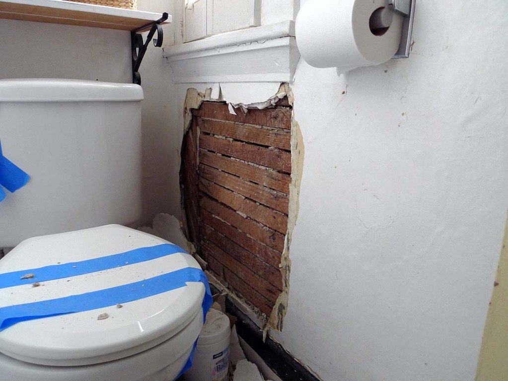

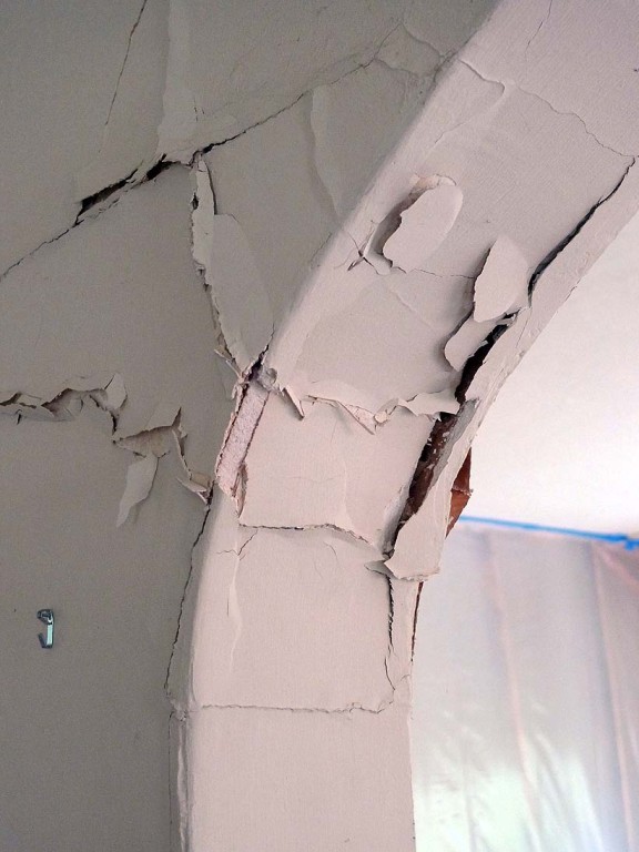

The next five photos picture samples of the resultant damage from the leveling of a structure that's been crooked for over half a century.
This is an archway near the center of the house. It's not original work. We're seeing damage like this on three arches on the main floor.

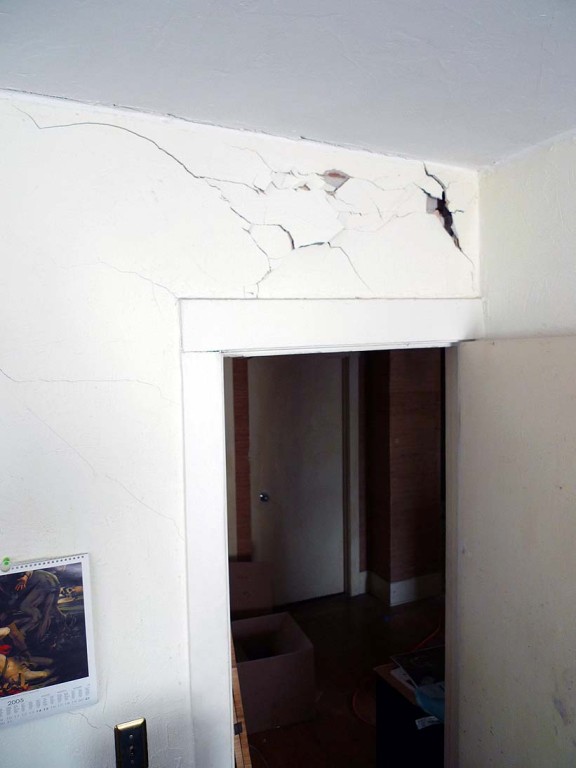

This is the about the worst wall failure. The top of the door frame is now sloping down about 5° to 10° to the left.
This damage was helped along by water intrusion. I pulled it apart prior to taking the shot, but the whole exposed area bulged out like a bubble and cracked.

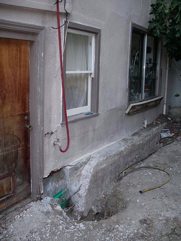

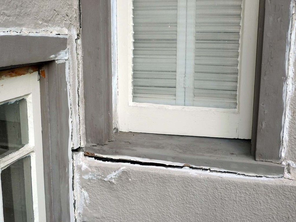

This is about the worst exterior stucco damage we could find. It's on the other side of the toilet in the photo above. There was also some minor, hairline cracking in other locations.
