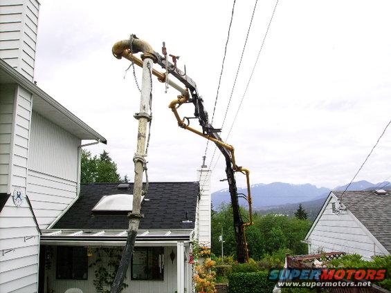

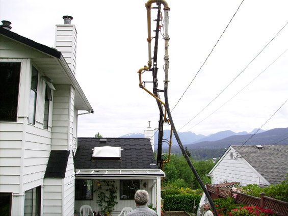

I just poured 6.5 meters of aggregate..uphill to the rear of the house and land.
The rear steps were poured off the lane but the rest was boomed up to the house along with a line at the end of the boom to reach further up, than from off the lane...
What an eventfull day....phew.!!
