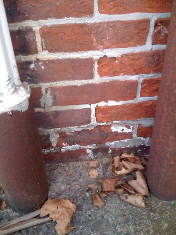

Bricks pushing in
Old 07-21-09, 06:55 PM
S
Join Date: Jul 2009
Posts: 1
Received 0 Upvotes on 0 Posts
Bricks pushing in
I have a wall between two downspouts where it looks like the bricks are starting to push inwards. You can see the main brick with the white grout on it below. I was wondering if anyone had any ideas what might cause this. Thanks.
Old 07-21-09, 07:34 PM
P
Join Date: Feb 2005
Posts: 1,306
To me it doesn't look like the bricks are pushing in; it looks like they are flaking away. Notice the small chips on the ground under them. The mortar is staying put, but the bricks are eroding below it.
