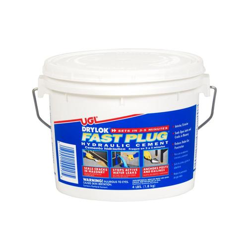

I have most of a bucket of Drylok "Fast Plug" which I used to patch a damaged and weeping section of the wall elsewhere in my basement. The label says says "Hydraulic Cement" on it, so I assume that's the right stuff?

Pulpo: It's this stuff:

That is the long time proven classic for repair of concrete cracks that are not live or recent. You will never find a dam without it becaue is works even if the wall is damp, not like caulks.
Hydraulic cement is a generic material that many people slap their brand on. It has been around for well over 80 years since no one has come up with a better repair because it works well with concrete and the environment (materials and moisture).

The verdict is: The crack is not compromising the structure of the house and can be easily patched. So today I mixed up some hydraulic cement, poured it into a makeshift pastry bag, and squeezed a bunch of it into the hole until it started pushing back out. Then I filled the rest of the crack and that was that. Problem solved.
