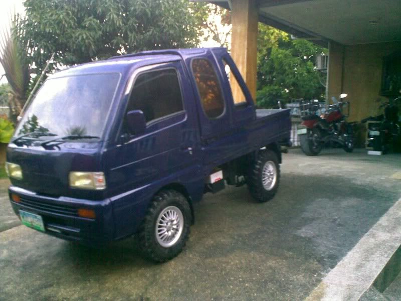

Two meters is plenty wide for my multicab and just wide enough for the small cars and taxis we have here. Think like a Toyota or Honda 4 door. I think I measured my truck at 1.6 meters and I know have passed other multicabs on the 3.5 meter road which is on the way to my property.
Multicab:
As you can figure it weighs little as 2 men can pick the back end up and move it if it's in the way of someone getting out and I'm not there. I want the drive strong enough that if some idiot in a cement truck with 10 meters of concrete drives over it. Is 4 inches enough or should I use 6?
