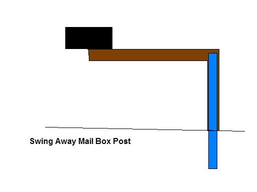

Mail Box Post
I saw this idea in farm magazine:
The brown frame is made from round pipe and fits loosely over the round blue post so it can swing out of the way when struck.
