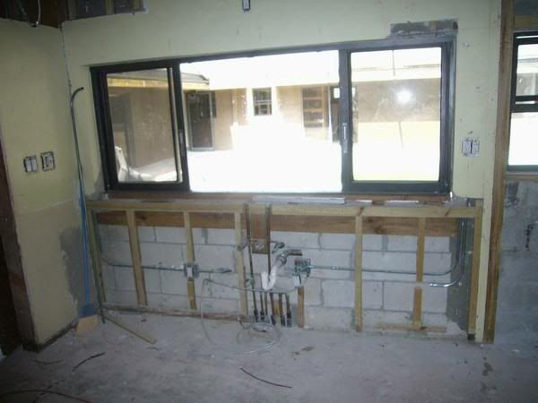

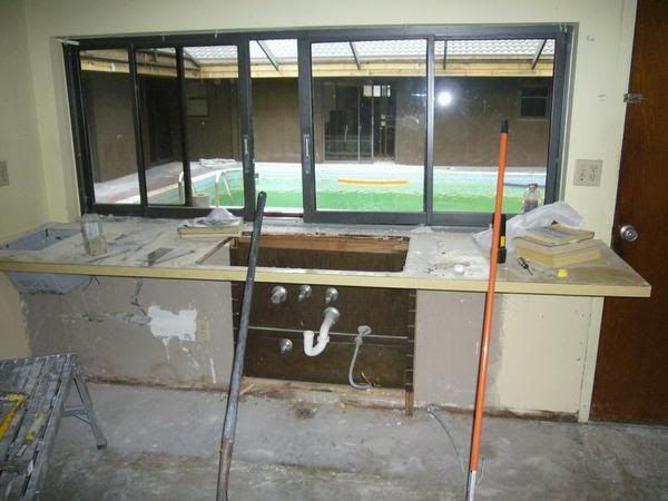

This was the initial condition. A large kitchen window and the sink drain stubout was too high. Not low enough to accommodate a garbage disposer and a deep sink. So I need to lower it to 12" off the floor. The vent is to the right, as indicated in red.

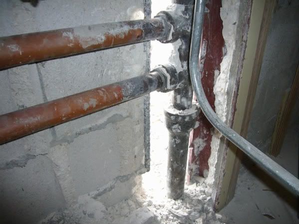

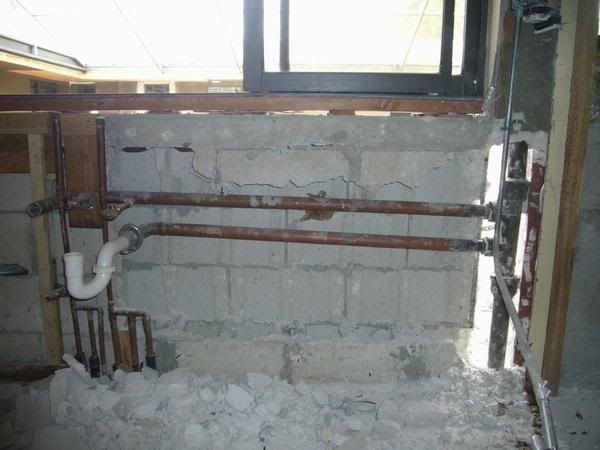

First the demolition to expose the cast iron vent pipe, and the two copper pipes that tied into that.

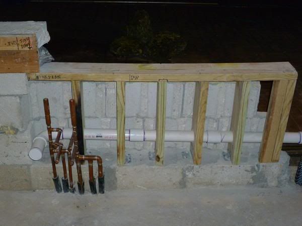

I end up having to remove 4 rows of hollow block and only keep the exterior side of it. I then built a 2x6 wood frame around the new pipe, and the wood frame sat on top of the bottom row of the block wall, I filled the cells of the bottom row with solid concrete.
After some more thinking, I decided to go with a solid concrete wall. So I tore down some of that wood frame, and installed some rebars to make a solid wall. The wall has a tie beam across the top of the window, so the portion of the wall below the window is not really taking any load.
