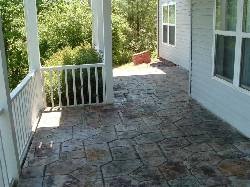

I had about 400 sf poured, stamped stained and sealed this past week for a client. I leave it to the pros. It turned out spectacular. I don't know how the staining goes, but the sealing must be done after it is completely dry. They put on an initial coat, then rolled on a second thicker layer the next day. If it is done after it is dry, I would think it would help to keep any mildew on the surface of the sealer, which would make it easier to rid with soap and water rinse. This was a dirt area, 6" down from the threshold.
