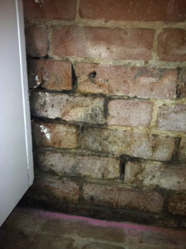

Mold on exposed brick wall?
Old 10-28-11, 01:28 PM
O
Join Date: Oct 2011
Posts: 5
Received 0 Upvotes on 0 Posts
Picture of interior exposed brick wall in my apartment. Can this be black mold? Air quality test came back negative for toxic mold, but what else can this nasty stuff be???

Welcome to the forums!
I'm not seeing the pic http://www.doityourself.com/forum/li...-pictures.html
edit;
I can see the pic now
It looks like some type of mold to me. What have you done to try and remove it?

I need help! Does anyone know what this black stuff on my brick wall is? Landlord says its not mold, but what else can it be?

Just recently moved in to the apartment, so I haven't tried anything yet. Can this be mold, even if the "expert's" indoor air quality test apparently came back negative? I don't really have the money to get it tested again.

What did he say it is, if it's not mold? It looks like mold to me & the wall needs to be sealed from the outside.

I'd mix up a bleach/detergent solution, scrub it some and see how it responds. If you have any breathing issues or are otherwise concerned - wear a mask.

Bleach is only a temporary solution. The outside wall will tell the rest of the story.

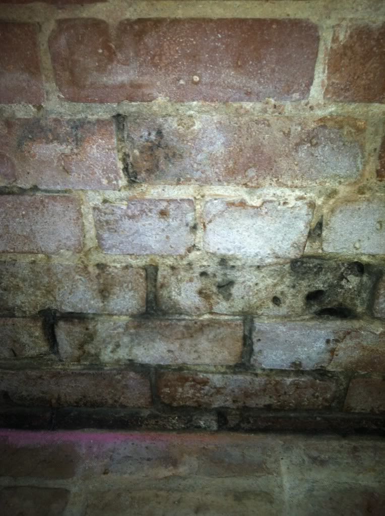

Pictures
Here's the pics of the wall again.

You should be able to clean it up but as Pulpo stated, if moisture is coming thru the wall from the exterior - the mold will come back..... but all of this is stuff that the landlord should take care of.
