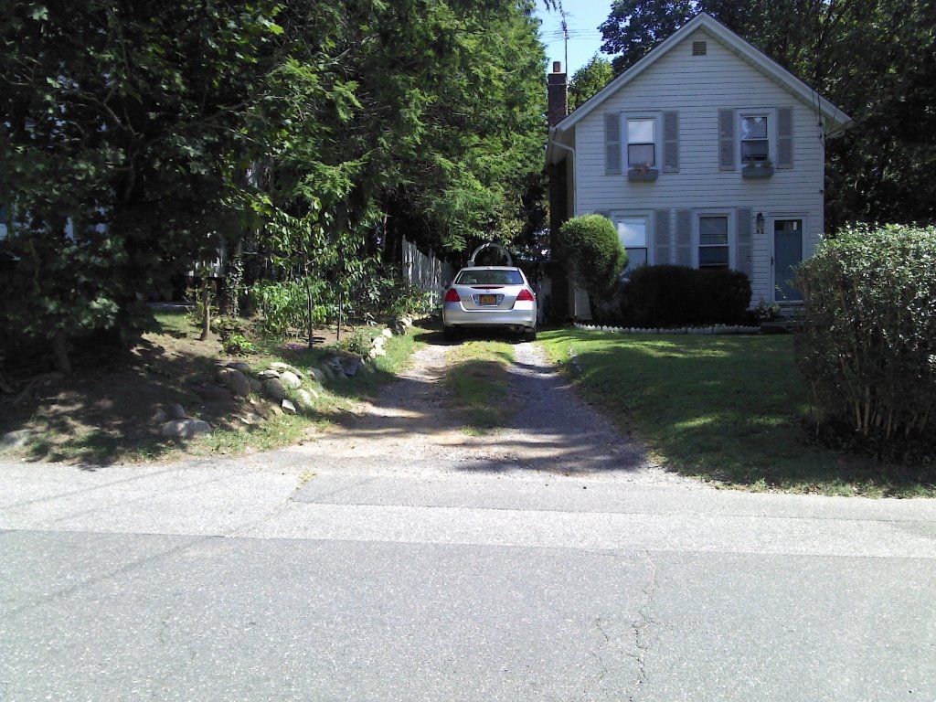

Is it possible to make a cheap driveway using flat rocks on a ground thats grass/soil?
I was thinking about placing the flat rocks on two lines where the tires would run up and down the driveway and leave the middle with artificial grass.
Please give me your opinions. Thank you

Welcome to the forums! You can make a driveway from almost any item. I have seen them made of asphalt shingle tab waste. How large of rock are you planning? How do you plan on preparing the ground? Without digging and putting gravel or sand in the area, your stones won't lay flat.
The rougher and irregular surface, the better traction you will have in the winter, but it will change in the spring, That is the beauty of a cheap driveway with no preparation or concern about what is under it.
Without more information provided, that is my best guess.

i was planning to dig and try to level the ground best as i could. i was initially thinking of making the driveway with solely gravel but i didnt want them to get stuck in the tire grooves(do they?)
i've never done this so im not sure how large of stones they sell at lowes/home depot...im hoping they sell a stone thats (1) Thin but not thin enough so the weight of the car would crack it (2) Wide(maybe 18-24 inches?) (3) decent height..
ill post the picture of the current driveway tomorrow when its not dark.

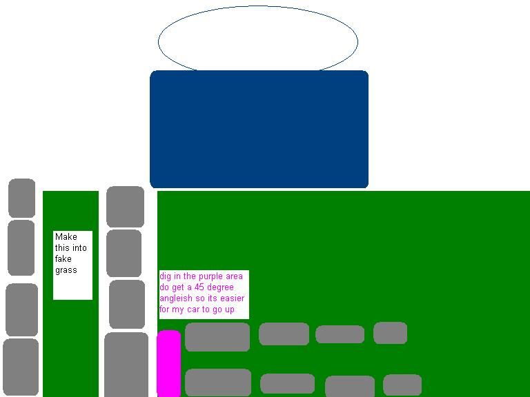

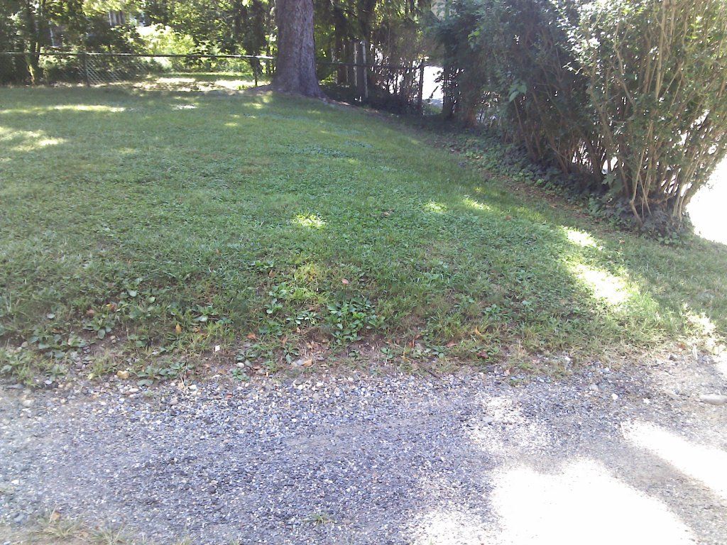

im not too concerned about the property value, and the astroturf is just a plus, i guess i dont need to have it done but i really do need the side driveway for one additional car. the edge of the grass is at a disadvantaged slope so i was thinking of digging to make it as 45 degree as possible.
i've attached pics, please take a look. excuse the poor illustration lol

A paved driveway would be best [either asphalt or concrete] but I can understand needing to spend less money. I'd just get a dump truck to spread a load gravel and call it good. Tire tread will pic up smaller gravel but it really isn't that big of a deal. The gravel yard should be able to tell you which type of gravel is best for your area. I like crusher run as it has rock dust in it which helps 'glue' the gravel together. The downside to crusher run is it is possible to track the dust into the house during dry periods.
There's a wealth of information on pavers that allow water to flow through. Just do a search under Permeable Pavement or EcoGrid. I can't say they will meet your cost requirements, though, as I've only dealt with them indirectly on urban paving projects. Could be a bit pricey.

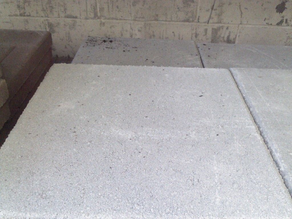

I went to home depot and found the pavement stones i was looking for, my questions are:
1. Do i need both use both paver base AND paver sand for the foundation? or can i use just one, if so, which one?

im banking on that, they look pretty sturdy, one paver weighing in at 37 lbs 16x16x2...
i calculated how many paver stones i would need, roughly about 30 per tire lane, so 60 stones for the single driveway
would i need the base + sand or just the base...?

I don't much about installing pavers but for a driveway use the base would need to be packed pretty solid. I would hazard a guess that you would want to limit the amount of sand under the pavers to just enough to make it level.
