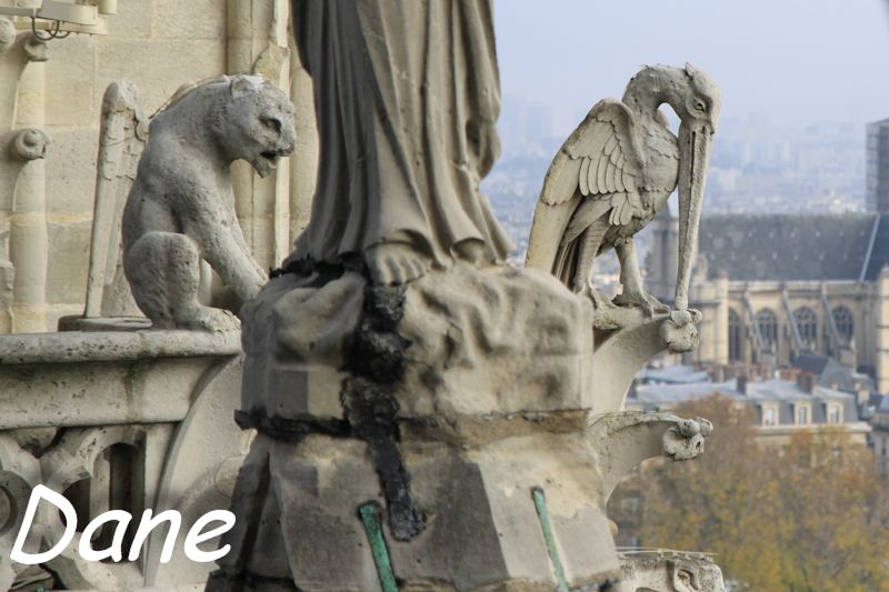

I thought gargoyles were supposed to be scary but I don't know about a pelican. I suppose he could have a bad attitude.
