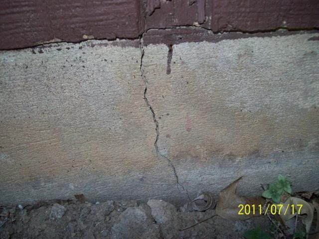

We have a 40 year old single level home with a typical S.Texas slab foundation. The soil has a lot of clay. We have noticed that the back corner of the house has dropped about 3/4 of an inch, an 1/8 of an inch crack 6' long in the slab has developed in an adjacent bedroom, a couple of interior walls have developed separation cracks near the bottom of the walls, several doors will not close. Gets worse during hot dry summer months. We have come to the conclusion that something has got to be done. To date we have not had anyone look at it, but learned right off that there are many methods of slab repairs, all are expensive, & are very controversial. All companies claim that theirs is best & none of the others work or will not last. I am in hopes that this forum will shed some none biased opinions on what method works best.

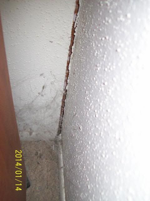

Jim...It sounds like you made a wise decision. I just got out my level & doubt if my back bedroom has even a 1/2 drop. All the sliding windows work fine. The one thing that I don't understand is why some of the inside walls cracked (picture, ignore the cobwebs) 3 to 4 ft up from the floor & stopped there. They don't seem to be getting any worse & this only happened to the inside walls. I"m sure there is an explanation. When you sold your house, did you adjust the selling price because of the foundation?

The questions about cracks in your walls are exactly what you should be asking your engineer, and I specify engineer because you don't want just any house inspector, you want a structural engineer.
