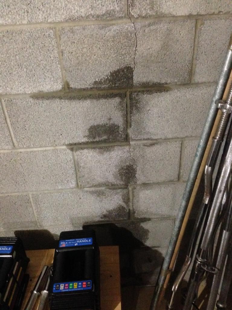

Still having an issue with this in a couple of spots. I have no concerns about the sheathed walls on the house - the veneer is on the foundation exclusively. But what is happening is that, in some spots, water that makes its way on to the stone veneer is making its way through the mortar and wetting the underlying block, eventually showing through in my basement. In one section of my basement, I have a fine crack in the block that is probably a result of water making its way off the deck and right in to a corner of the veneered wall. That fine crack will seep water in to the basement every time it rains.

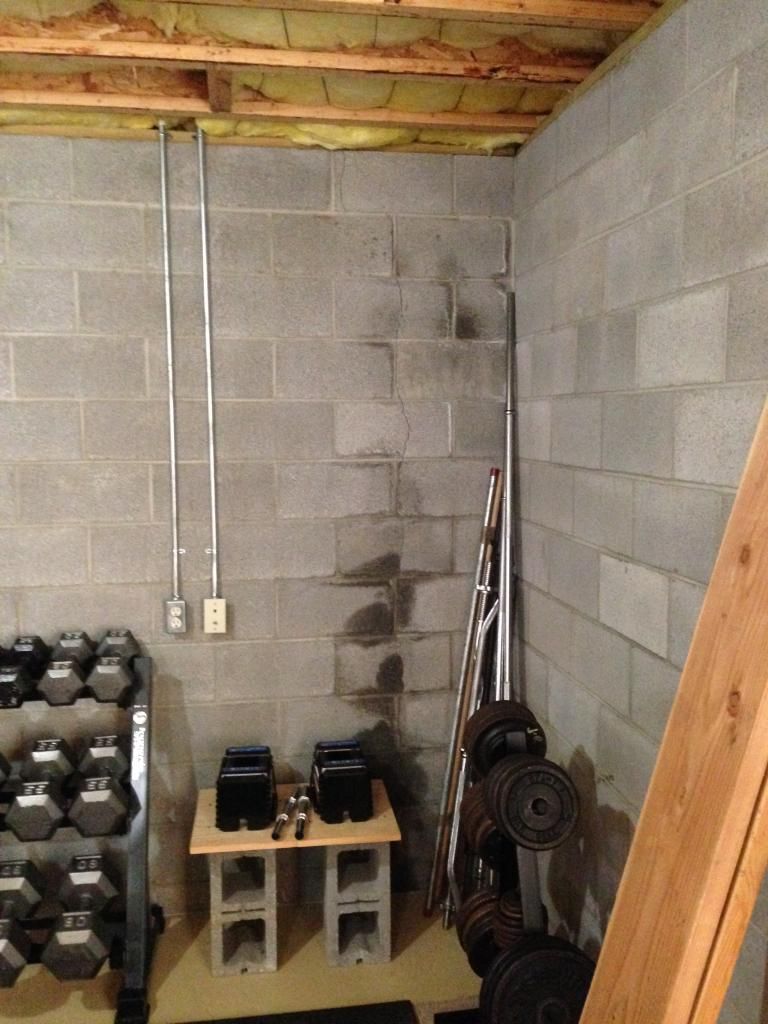

Here are some pictures of another spot where it's happening (by the deck I mentioned above). This is the most severe location I have. We have heavy rains here in PA last night and it started wetting the inside as you can see from the pics.
Distance shot of the interior wall:
Close-up shot of the interior wall:

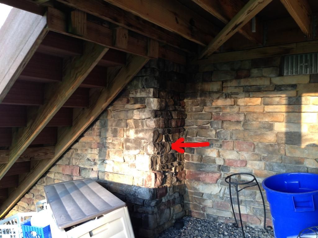

Distance shot of the exterior:
Close-up shot of the exterior (for reference, the part that is "leaking" in to the basement is the short "bump out" in the dead center of the picture. The sill plate in the basement is approximately aligned with the ledger on the deck.):
The red arrow shows the approximate location of the start of the "wet spot" on the interior wall:

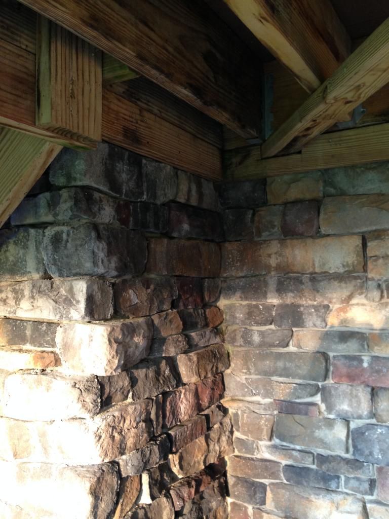

And a close up shot of the ledger where the water seems to originate from (when I watched it last night it appeared to be coming from in front of the ledger and dripping down on to the veneer, not from behind the ledger. With this being the interior corner of the deck, it gets a lot of water action from multiple directions):

Forgot to mention, there is visible flashing behind the siding as well as behind the ledger. It does not extend below either, and I can't be entirely sure of what it is, but I honestly believe the water is getting in behind the stone at a lower point.

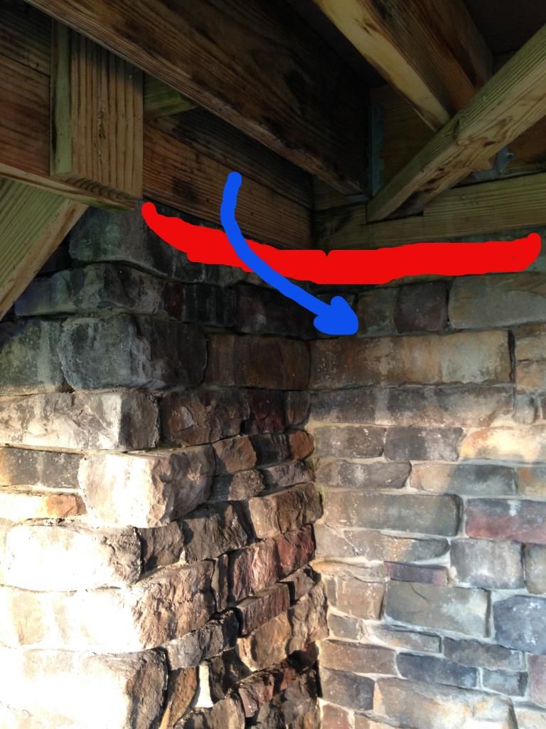

My understanding is that the stone veneer will never be waterproof, neither will the underlying concrete block. The crack I have in this wall may be exacerbating the issue (or may have been caused by it, chicken-and-egg scenario). So my thinking was to find a way to flash it to keep the water away. Problem I'm running in to is that the best thing would be to slip some vinyl or aluminum behind the ledger on the deck to "kick it out", since I think this would send the water away from the veneer and to the ground. But there's no way to get behind the fasteners on the ledger to do so. Looking for other suggestions.
Like this... The red being some sort of flashing that allows the water (blue) to kick out beyond the foundation and essentially keep it away from the veneer and preventing it from wicking in to the mortar on the wall.
By taking the floor boards of the deck up, you can flash the top of the wall-ledger connection and create a drip edge as far away from the building as you like by extending that flashing over the floor joists/blocking. Of course, to do this you need to remove the first row of siding as well, which I've repeatedly suggested you do anyway to inspect for the presence of water behind the WRB or existing flashing.
