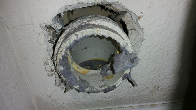

Cleaning up dryer vent exhaust hole

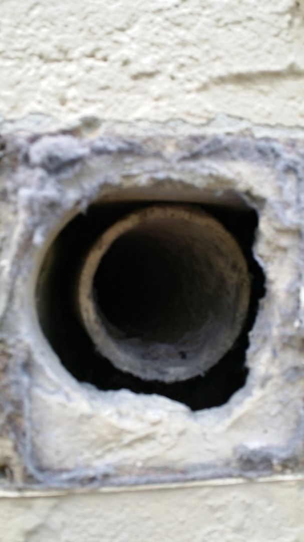

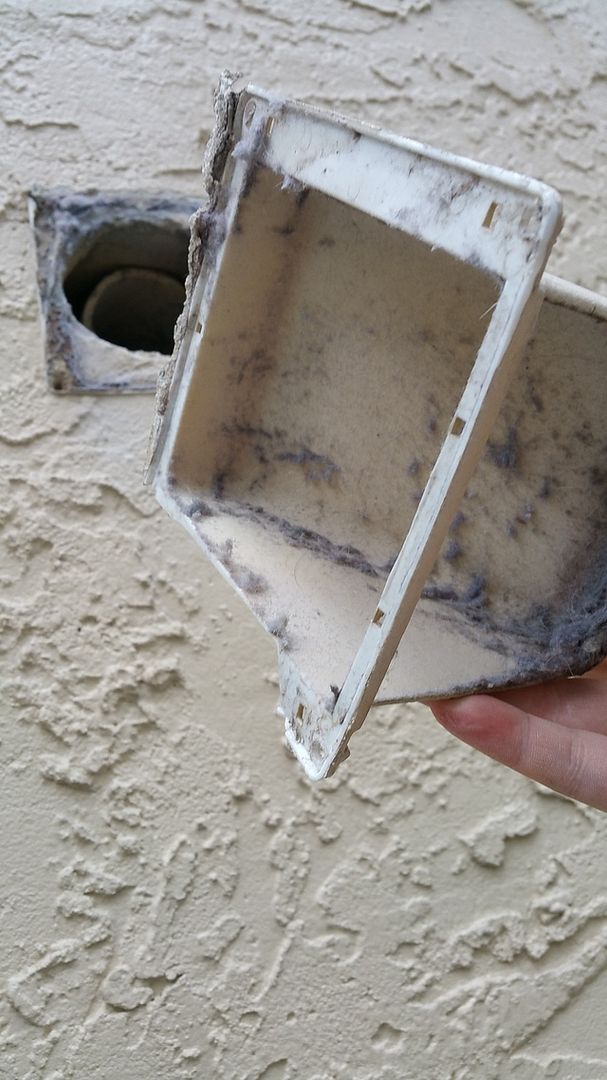

So youve seen my threads around alot lately youll see in the pics that rhe old exhaust cover has no barier to stop bugs from getting into the lines. I took the cover off and noticed a few issues of concern. Obviously the first thing is that there is not a perfect circle. What do I need to fix this I hace a pretty powerful drill do I ust get a 4in circle thing? Also it appears the vent pipe is not all the way out. Do i need some sort of connection to extend it?
Thanks
Thanks
A dryer duct should be a 4" metal line. That looks like a smaller diameter PVC pipe in the picture.
A regular dryer hood comes with an attachment pipe.
In order to make that hole larger you'll need a sharp chisel and small sledge hammer.
The hole size will be almost 4-3/4" so a 4" hole saw will be of no help there.
If the existing line is indeed PVC pipe, you are very lucky that the stuff hasn't caught fire yet and burned the house down.
Replace all of it, with metal, asap. Your homeowners insurance company will thank you.

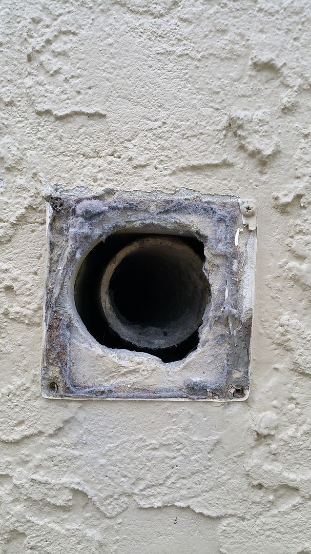

I think what he's got is metal... it's probably 3" and is flared on the very end. So covered in lint he probably can't tell what it is.
I would suggest you get a small diameter masonry bit, put it in a hammer drill and make a series of holes around the perimeter to clean up the opening and make it more round. The dryer vents in the pics above usually come with a sleeve that can be siliconed onto the exterior to seal up the hole.

When its daylight out ill go out and double check that its not pvc.. what type if cost am I looking at if i had to replace everything? Is tge a multiple thousands or hundreds can I do it myself?
By smaller diameter masonry could you suggest a size? Im envisioning you mean just drill numerous holes vlose together then i can break away tge bits? Sort of like carving a pumpkin
Oh, like a 1/8 or 5/32" masonry bit. And yes, connect the dots. Once you drill a series of holes, one smack from a hammer and cold chisel should open it up. A 4 1/8" hole is the perfect diameter if you wanted to make a template to draw an outline.

Cost of replacing pipe is strictly related as to how hard it is to access. If easy to see and get to no problem and easy do it yourself, If behind walls and no access than can be very expensive. Dryer vents that are not working properly cause most dryer problems and dryer fires.

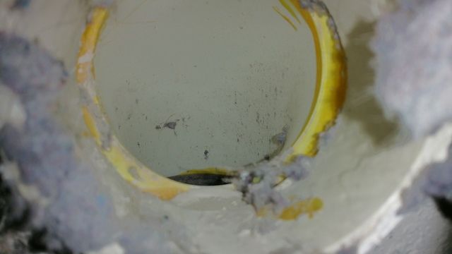

Well this wasnt what i wanted to see im very convinced its pvc on the exhaust. When did they do pvc for these things? Im wondering how far pack it goes onto the system or if its pvc the whole way.
So i bought a "lint eater" to clean out the exhaust but im wondering now if im better off leavong it because I wonder if the lint lining the piping is better then having it all the normal outside again.
All I know is ots right there on the other sode of this wall is my kitchen then the dryer is on the second floor

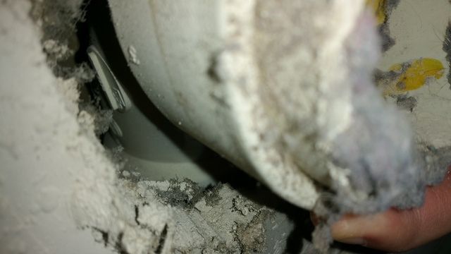

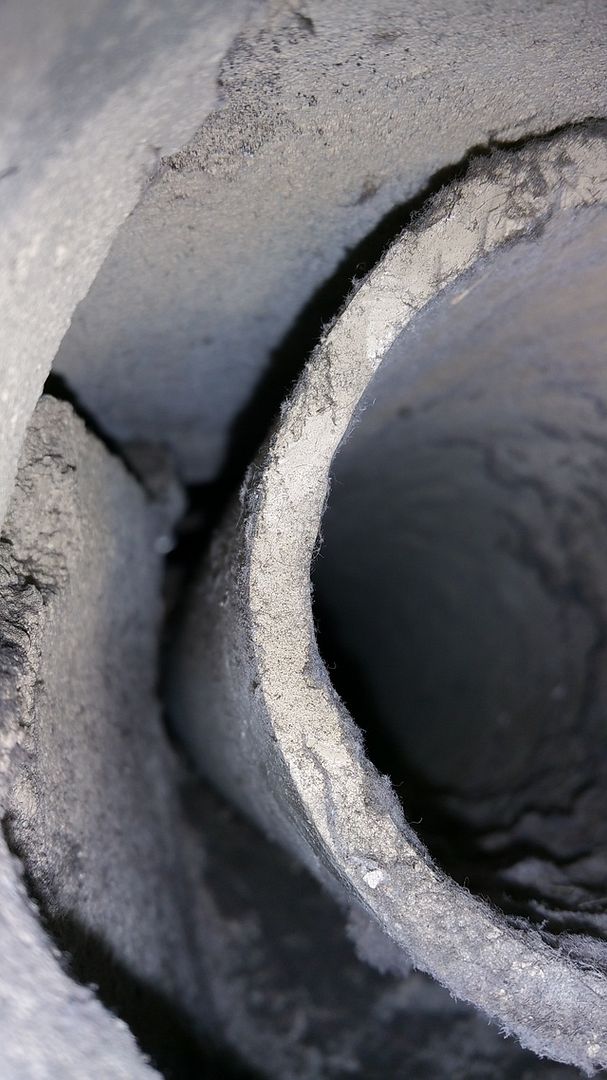

So more updates. Here are pictures from the dryer side I cant tell if its all plastic after this sleeve but I see enough. To worry me. So any videos or step by step guides to go at this myself?
In the meantime whats the thought here should I clear all lint out with the linteater? One one hand I feel the "layer" of built up dryer lint may suppress the buildup of static electricity, but the other hand if i clear the vent out thereay be kore surface area to build up a charge but less lint to catch fire.
Last consideration as mentioned all the hoisesnin my row likely have this issue is there some building code in FL i may be able to or something I could bring to HOA or even try to bring up to building code. Ideally It may be something to make the other owners act on it (most of these units are rentals.
Clean the lint it's not doing anything but causing problems. Lint is what burns not the pipe. If worried about PVC pipe check with your building dept says about PVC for vent pipe. I think the plastic you would be worried about is the old flexible plastic they had 30 years ago. The PVC would not be my choice for pipe but since it is there could be a major expense to change.

How can I be sure this isnt the flexible pipe. The house was built around the 80s so it may fit the bill. I realize the lint is what causes the issue but isnt it also the concern of static electricity causong a spark?
I guess i just call up my code enforcement office to see if its up to code?
Wow, that surprises me. A duct cleaning firm should be able to send a brush down that pipe and clean it up. To me, that's most important. PVC is not what you want to see... current code says "metal" but who knows what code allowed when it was built. And you aren't required to bring it up to code unless you change something major, like tear off that part of the house during a remodel. I would not call anyone and leave sleeping dogs lie!

At this point im super worried about the fire hazard not even really a concern about code.
I have the gear to clean the lines hust making sure its a smart idea to do it or not being that the bare walls of pvc will produce greater static electricity
From what I can see you have solid PVC pipe for vent. Never have seen any problem with that for a vent, Don't know what your code is now. The flexible tube I was talking about Looks like a spring is in the plastic and is very noticeable. Hard PVC is not the problem it is lint build up.

In actuality the corrugated flexible pipe, which you would typically attach from stub -out to dryer, is far more likely to trap lint than the smooth-walled plastic. Keeping the whole length of discharge pipe lint-free is far more important than your concerns about plastic pipe.
Minimizing any lint getting into the vent in the first place, is just a matter of conscientiously cleaning out the lint trap on the dryer before each load. And occasionally, depending upon use, disconnecting the connection at the dryer and vacuuming the vent.
As long as the warm discharged air has an unobstructed outlet and lint build up is prevented, any concerns about the plastic pipe is largely unfounded.

Well cleaned out the whole exhaust line with a vaccuum and the brush thing. Then I cleaned ou the lint trap area on the dryer. Will post pics of the lint i got our of there but now i got a bigger issue. If you turn the dryer on now it doesnt seem to heat up anymore wondering if something came loose it also seems to not countdown anymore so if you set it for 10 minutes it wont move from the 10 minutes spot at all. Ill be taking the bacl off tonight when i get home. Hoping the 2 issues are related. The blower definitely still works and the tumbler or spinner part works.

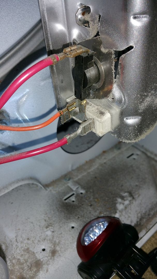

Will need a meter for this.
1st you need to check you have 240 volts to back of dryer. Unplug dryer And take back off. Check heater element and upper thermostat for continuity. (no opens) Either one open it's bad.

You are setting the dryer control on a heated setting, right? Got to ask, since some have settings that just blow cool air.

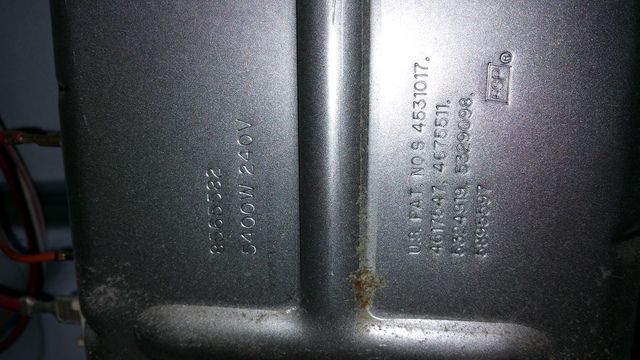

I took a pic of the housing of the element in case that helps anyone out. It may be hard to see but right below the orange wire across from the res wore there is nothing in that plug. I looked all over and saw no wore i could connect to this however.
How can I rule out the thermal switch vs the heating element? Any sort of ballpark on the cost to replace each and level of difficulty to replace?

After talking with my wife apparently shes been displeased with the time it takes to dry for a while now perhaps its been on the way out for a while now. it would appearently take sometimes 3 orore cycles to dry. Turns out the part is not very expensive and looks fairly easy to install. I might just go ahead and order all 3 parts, the thermostat and the fuse.

Ordered new thermostat, fuse and element, dryer works now! Waiting for the wifes input on if these changes make the dryer better or not.

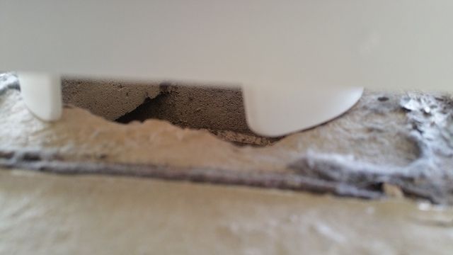

Back to the original reason of this post. So i have the 3inch pvc pipe i need to attach it to a 4inch diameter is there some attachment easily available? Can i be sure its 3 inches without actually measuring I was hoping to stop on the way home.

Thank you goldstar!
Bought the #1 rated multeter on Amazon and it came in last night. Took apart the back again and everything had a current or however you would say it. Then I checked the door switch, BINGO! I had already ordered spar thermofuses belt thermostats all of those and a door switch. It however has not arrived yet in the meantime i just cit the wire on the door switch and put a wire cap on the end (thank you youtube). When the part arrives i will fix that as well. I am also considering this other semi metal for the dryer exhasut not only safer but i feel i can get the dryer back further
