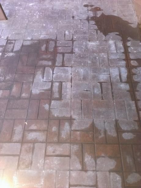

Hired a stucco guy to work on some stucco around 4 windows. They spilled a lot of stucco mix.
When they did the headers of the window blobs of the stucco mix dropped everywhere, some got on the bottom tracks of the window, and some got on the bottom of the wall where I have clay pavers. Also some got onto hosebibs and water shutoff valves. They only worked in some areas but their footprint with stucco coming in and out hundreds of times pretty much got it all over.
When they cleaned up they used a garden hose and sprayed all the pavers. At first it looked ok when the pavers were wet, but after a few hours when it dries up I see a white haze all over, and many many spots of stucco on the pavers. I tried to remove it with a bush broom, no luck, with a metal wire brush that worked but it would be insane to try and wire brush 1600SF of my paver deck. I called the stucco guy and he said that's fairly typical and a couple of rain storm and some traffic wear and tear it will not be noticeable after a few months...called again the next day and got the "he is not available right now will call you back..."
I spent four hours cleaning all of the stucco off window tracks, frames, hose bibs and water valves. Now I am trying to figure out how to deal with the clay paver deck. Will it clean up if I pressure wash the entire deck?
If I wash it and when it's wet it looks OK once it dries the spots, the patches and the white haze returns. Here is a picture of my deck when it's half wet.

A stiff scrub brush on a broom handle and a muriatic acid scrub, followed by a power washing (or at least a good hosing off) will clean it right up. Water and muriatic acid should be mixed no stronger than 8:1. Wear protective clothing, gloves, and eye protection.

I have found that a product called Sure Klean is better than Muriatic Acid. The local stone yard should have it.

I'm sure the water is his usual method to make it seem like he tried to clean up after himself when all it really does is hide the fact that its not clean just long enough that he can make a quick getaway. Hard to believe he couldn't put down a dropcloth or piece of poly.
Once the water dried and it turned white, it was dry. Waiting longer to clean it won't help or harm it either way. It will take the same amount of scrubbing whether you do it now or later.

Acid or Sure Klean will work. One thing though, wet the work first then scrub with the cleaner and keep rinsing as you go.

I would use the acid and a brush on it and scrub it. Might need to rinse and reapply the acid a few times to get it clean.

Are the pavers you show in the pix concrete or fired brick? Brick are easier to clean without acid stains. Oh, and BTW resist he temptation to make the acid solution stronger in hopes it will work faster or be less work. You do not want to trade one problem for another.

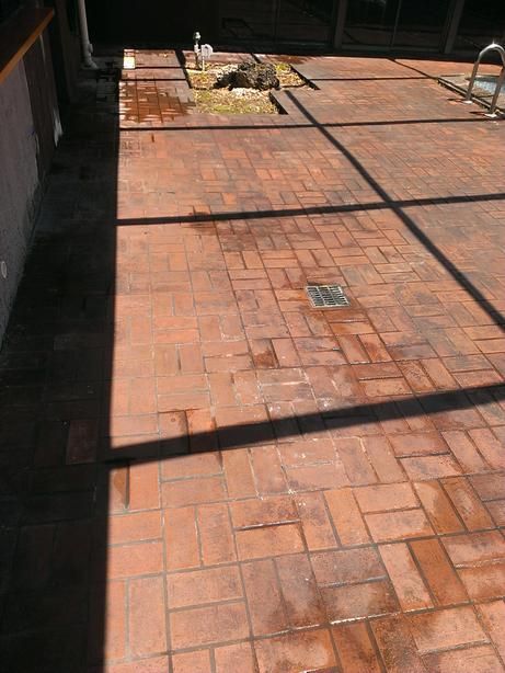

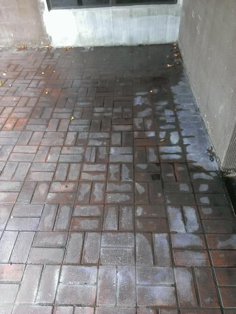

Those are clay brick tiles, about 3/4" thick.
Anyway I used the diluted acid and scrubbed scrubbed scrubbed...a lot of it came off.
BEFORE picture:
AFTER pictures:
I missed some spots, so have to do it a second time.
HOWEVER, my deck has four deck drains one on each side of the pool and they are metal grated drains. After I used the acid I used a garden hose to rinse off...the next day when everything is dry, the metal grate is now partly "green" in color.
Does this mean the acid corroded the metal grate?

Yep. Acid will do that to metal. Didn't see any metal in your photos, and no mention of a pool... guess we can't think of everything. You can probably clean the metal grates up a little bit with a wire brush. Go the long direction only to give it a brushed finish. Are they steel or aluminum?

They are either copper or bronze.
