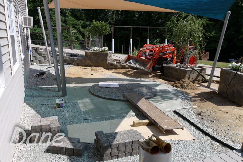

Old 05-24-16, 09:23 AM
Norm201's Avatar
Join Date: Sep 2013
Posts: 9,179
Received 254 Votes on 228 Posts
If you're interested you can see a step by step of my patio paver install

Old 05-24-16, 09:41 AM
O
Join Date: Jun 2013
Posts: 104
Thanks for the pictures, this is very helpful to see the whole process.
Good job on the patio, that tractor is one piece of equipment I wish I had for the excavation process but I guess it's slow and steady with the shovel...haha.
How did you measure the depth when you were excavating?
Thank you!
Old 05-24-16, 09:54 AM
Norm201's Avatar
Join Date: Sep 2013
Posts: 9,179
You're going to find out that hand shoveling will be a back breaker. I was lucky to have a friend with a front end loader. You may want to contract that part out. I went down about 6" but it was tough even for the front end loader. The clay was so hard at one point he could not go any lower than about 4" at some spots.
