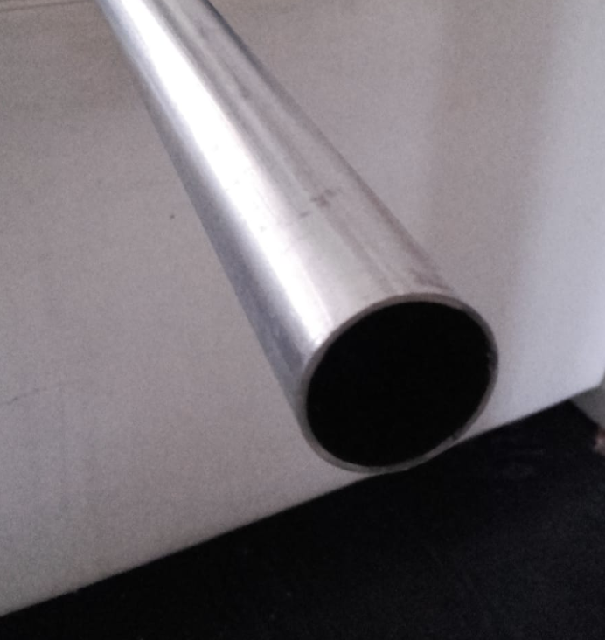

Final question: Can i use a regular hand saw (used for cutting wood), to saw through this galvanized steel
pipe? The store wouldn't cut it for me.

I would use concrete mix which is a mix of stones, sand and Portland cement. If using pipe for the handle I would drill a hole through each end and insert a big nail or bolt to help key the handle into the concrete.

As to the last part of your question.
No you cannot use a regular hand saw.
You need a hack saw or something designed to cut metal.

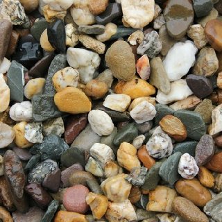

I plan to use stone grids inside the concrete mixture to make this heavier, and also because this way i need to use less concrete.
But how much is the max ratio of stone grid to concrete?
If i use a lot of stone peddles, will this make it more weak? Or will the layers of concrete keep it all together and keep it strong? I don't want it falling apart.

Concrete and stone are probably very close to the same weight!

I didn't know it was almost the same weight. However i know a place where you can find a ton of pebbles for free. So i figured, adding those in the concrete mix would save me some money on concrete. I could also find some old tiles and smash those into pieces with a hammer and use that as filling as well.

You should be able to find galvanized nipples (pipe) in the plumbing section. They are different lengths, I would probably choose a 3/4" diameter and 10 or 12" in length. The galvanized pipe will be quite strong enough to support the two ends. You could always add an elbow or something at the end to keep it embedded in the cement. The store might even have reject pipes that have had the threaded ends damaged that they'll give to you at a discount.

Do not add stones to concrete. It already contains stones and if you add more it will make it weaker. If you try to go cheap the weights stand a good chance of breaking apart when you set them down. By the time you buy pipe for the handle and the concrete there is no way out of spending some money. Concrete is the cheap part and it's per pound price is even less if you buy it in the larger 80 pound bags. If you want to go really cheap then forget about making dumbbells. Start looking around for things that are free and heavy; pieces of scrap metal, logs, rocks. Heck go out in the yard with a shovel and dig a hole. There are a lot of things you can do for strength training that don't use dumbbells or free weights.
