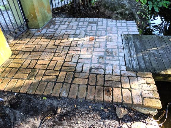

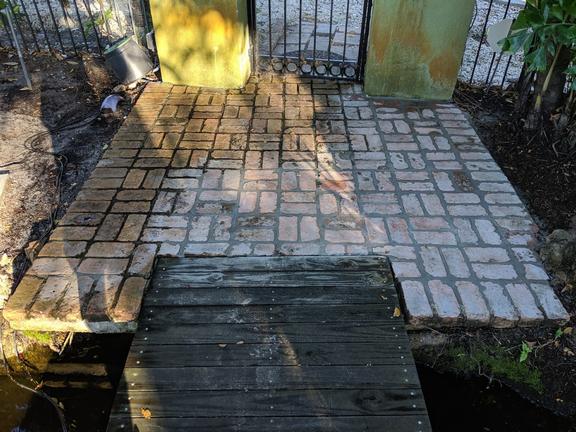

Here is a picture of the landing area today.
The area I redid the mortar joints is to the right side, where you see the bricks with a haze of white. If I mist the bricks with water, it will look fine, until it dries then the haze returns. I took a wire brush to brush it good today I think it helped a little, but the white is still there.
I have read that one trick is to use a diluted muriatic acid solution to brush the bricks. However my concern is the one side of this landing is the front gate, the other side of the landing is connected to a wood bridge over a fish pond. I wonder if I use muriatic acid then hose it off it will run into the pond and kill the fish.

Muriatic acid is really the best way to remove the white haze. Mechanical scrubbing is also possible as you saw but getting it out of the nooks & crannies is very difficult.
Yes, muriatic acid will change the water's pH if it gets into your fish pond. It will lower the pH number making the water more acidic. You can work carefully and hose away from the pond to make sure the acid goes the other way. I would check the pond's pH before doing any acid work and have some pH up chemicals (base) on hand in case you need to correct for any acid that gets into the pond.
Muriatic (hydrochloric) acid is probably the strongest acid you can just go to the store and buy and is quite hazardous in it's undiluted form. You should read up on safe handling practices and have the appropriate safety gear before beginning work.
