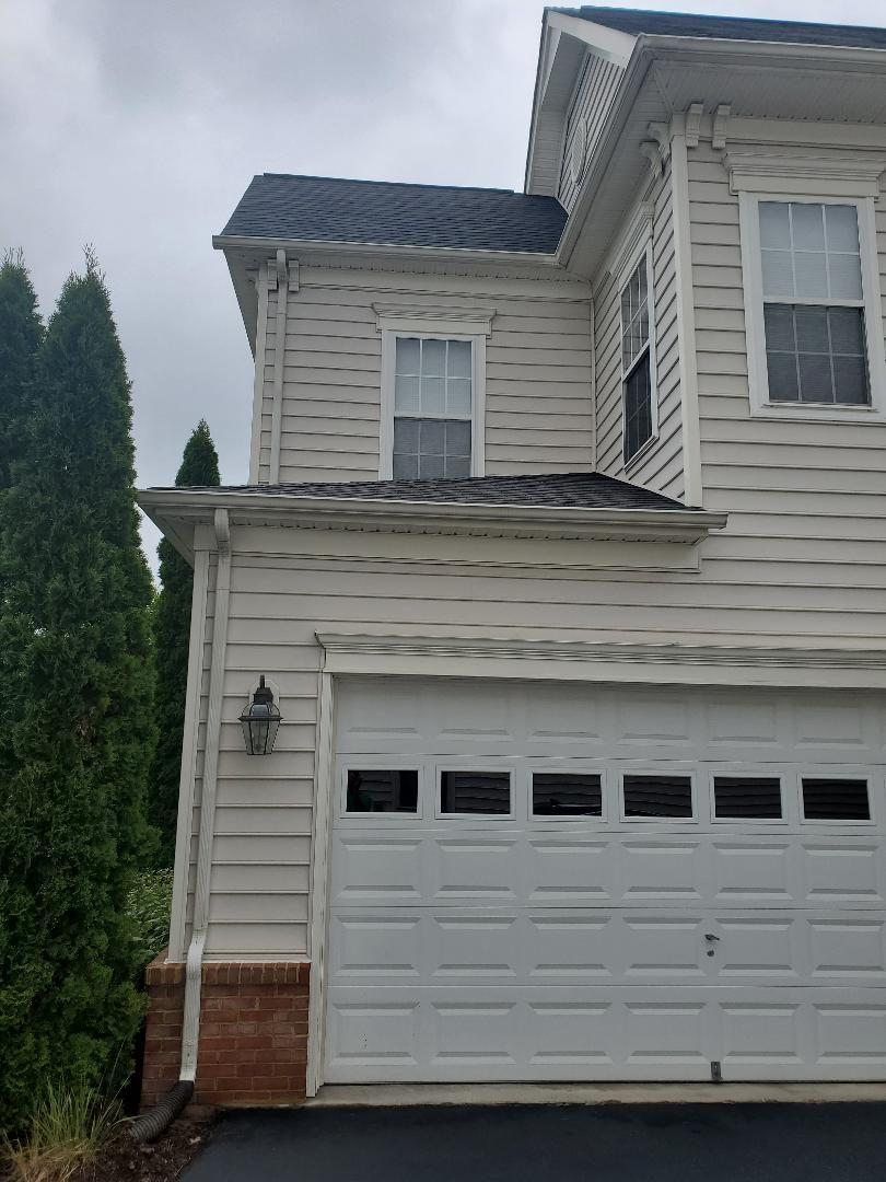

Hello DIY Community -
I'm looking for remediation help on solving a water seepage issue that is coming up from the ground and effecting the corner of my home and driveway.
The water seems to come up over night / early mornings and I've confirmed it's not related to any rain run-off, gutters or the sorts as we haven't had rain now in over 10 days and I've been monitoring very closely each day.
I've also been running fans and have really reduced the original build-up of water, but the area is visibly dark/wet each morning where by the end of the day it has mostly dried due to direct sun as I've been leaving the garage door open to help dry it out.
So, I don't really know what the next steps are to fix this issue. Not even sure what type of contractor would even handle this kind of problem, both in keeping the water out & repairing the concrete and corner of garage and bottom wall framing plate as it has been effected in small areas with the seepage. The total area effected is around 3x3 feet, so not too bad in the grand scheme of things. I'd say the height of the seepage is only 1/4" above the garage level in that corner.
I appreciate any help the community can provide. Many thanks. I will also post photos shortly.

Dig a hole about 12 inches deep just outside the garage. Observe early in the morning to see if water magically appears in this hole corresponding to the times the garage floor corner gets wet and magically disappears from this hole corresponding to the time when the floor starts to dry out.
You may need to regrade the land around the side of the garage so rain water and water from the driveway drains away from the garage and in particular does not go inside..
You may want to instsall a short French drain at about the level of the foundation footings on the side of the garage up to that corner and collect the water in a dry well further back with a sump pump inside in case the dry well overflows.

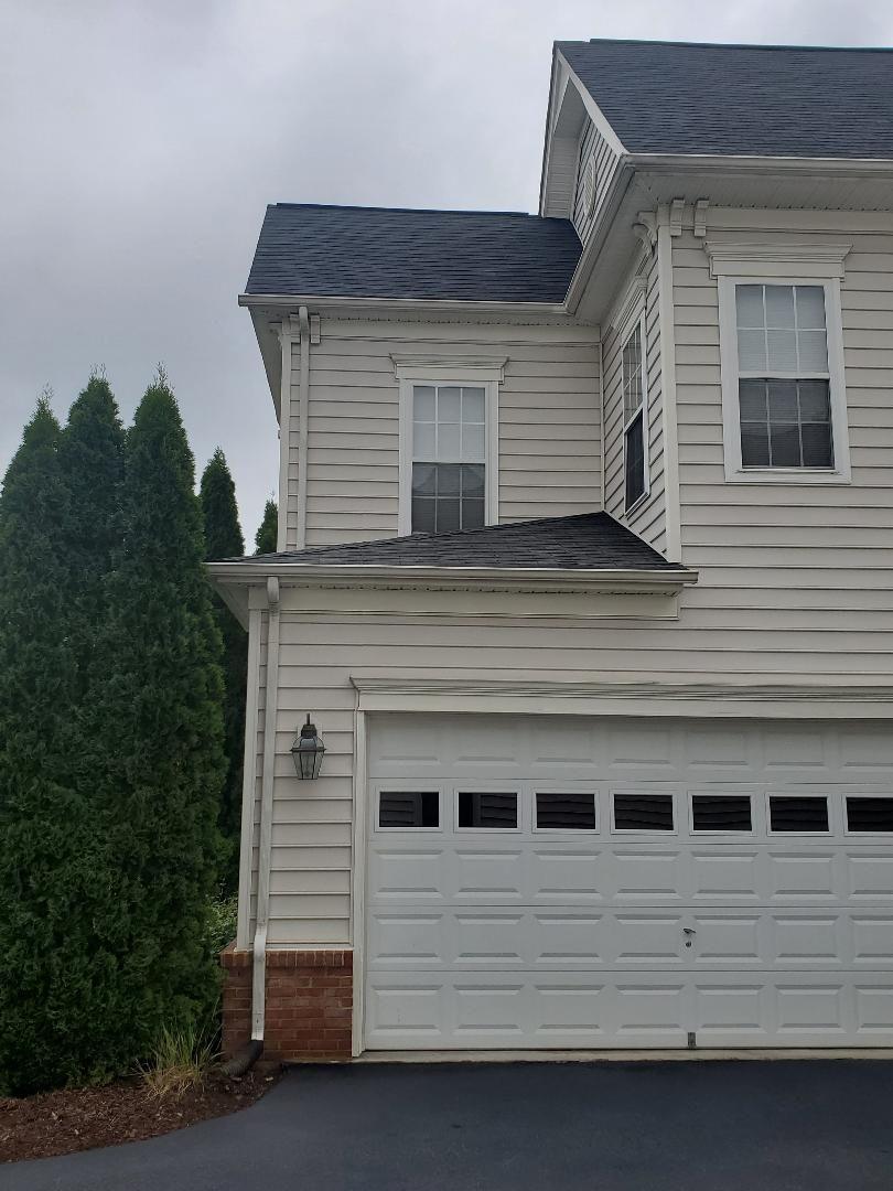

The problem is no doubt related to the downspout or drain pipe and the way it's currently connected. Checking to see if it is clogged should be #1 on the list of things to check.
The grade outside the garage is also problematic. Not much of a dropoff from the garage to the blacktop, and the grade of the landscaping and mulch is higher on the corner (and around the corner of the garage that is not pictured) than the level of the pad that the bricks sit on, and where the stain is the worst... right behind the downspout elbow. Brick is not waterproof. This is a typical problem that most homeowners dont think about, and eventually the grade outside becomes higher than the grade inside due to dumping on more and more mulch.
Finally, the way the downspout is connected to the drain pipe is substandard. Typically you want to have the drain pipe oriented vertically, (not at an angle) with the adapter on top. That way the downspout can go right into the adapter without the need for an elbow. Water is then not prone to backwash out of the adapter. Often, the top of that vertical drain pipe and adapter should be at least 12" above grade if you do not want it to overflow during heavy rains. (Or at least it should be buried deep enough that it can have a vertical run before it elbows and turns horizontal). Gravity then assists that vertical column of water to drain down the pipe.

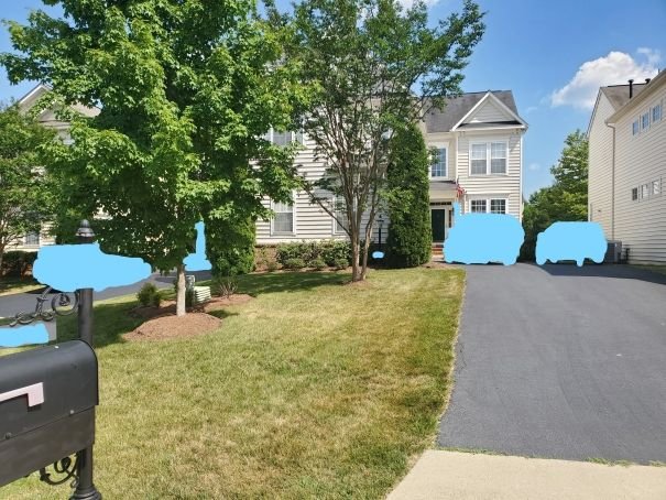

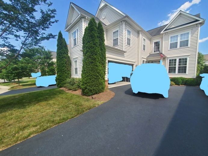

Kind of looks like a shadow of the house on the driveway to me.
The rest is dull gray and looks like it's several years old.
My guess is that there's a water supply pipe nearby, either it cracked and caused the damage that required the repaving, OR the repaving cracked a water line when somebody ran a steam roller over a buried water line.
As to leaks only in the morning, I'll wager that the municipality waits until early morning to get the off-peak discount for electricity, then pumps water up to re-fill storage tanks up on the hill that maintain pressure through the day.
If the house is along a main that connects a big pump and a water storage tank, a water hammer or pressure spike might cause an intermittent leak. I can imagine a municipal water authority increasing service pressure at night to fill the water tanks before the cheap off-peak power goes back to full price.

We recently sealed our driveway, which is why it is very dark in color compared to the concrete on the garage entrance. The gap between the 2 has always been there, I'm not really sure why it was never all 1 piece or maybe it has separated over time. We are the original owners (built in 04') and there was never a re-do on any of the driveway.

I did dig a nice deep hole all along the much side of the brick and there is no water over there. The water seems to be coming from underneath. The only area I saw that was damp was the darker asphalt touches the mulch, the hole I dug there it was damp along the asphalt side. It wasn't enough though to do anymore than make the mulch damp, but it does appear to be coming from the asphalt direction towards the mulch and corner of garage and from underground.
I also checked the gutters, downspout and black drainage hose for leaks, blocks etc.. and it's fine. I dug up the black drain pipe and inspected the area and it's dry. No holes or anything on the black drainage pipe. I also did a test and ran my garden hose from the gutter above all the way through and there's no leakage etc.. The water source is definitely from underneath, and seeping upward or through the area. I'll post some more photos soon to depict how the land sits.

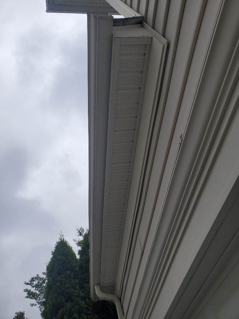

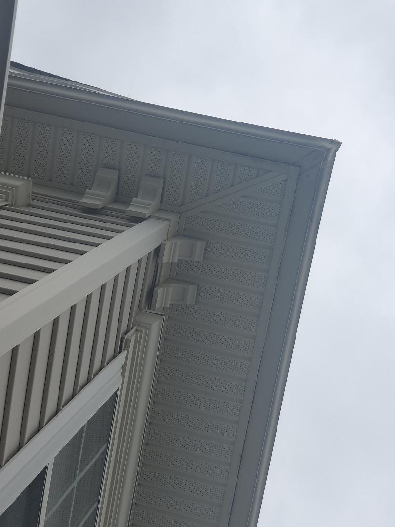

It look like it COULD be condensation from the 2nd floor front roof coming through the downspout (just to the left at the top of the corner clump of arbor vitae) and then getting under the garage shingles.
ALSO, I see what looks like a circular attic vent in the gable face of the main 2nd floor roof above the front roof. If you have warm attic air venting out at night over the front roof, that warm moist air s going to hit dew point and dump the house moisture out onto the roof as condensation.
ALSO, I noticed that the garage has a low pitch "bump out" that appears to be below the one-story roofline?
If that's not flashed and sealed, I could see heavy dew easily getting under the roof there.
