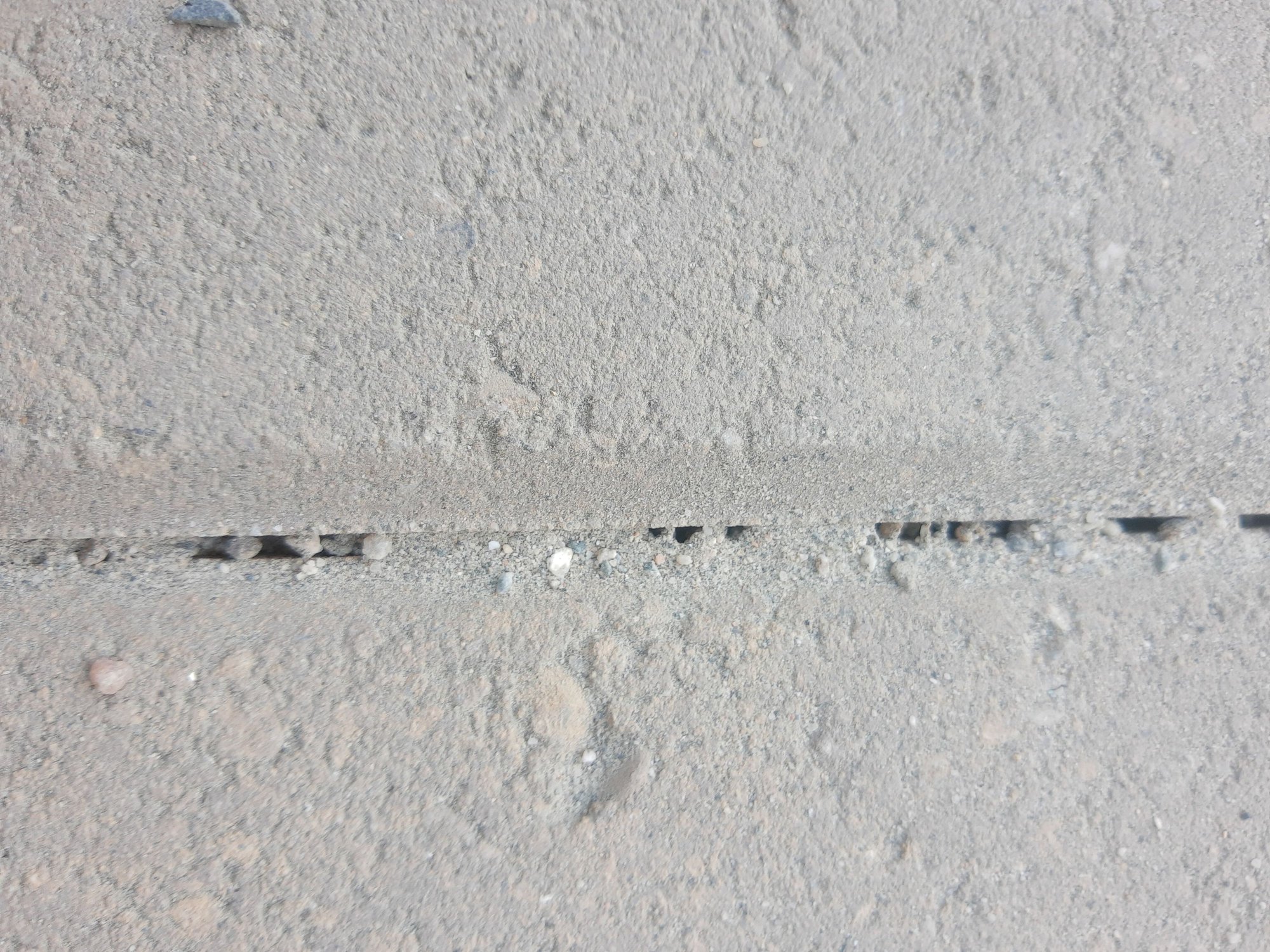

Hello, I had a professional put in 3000 sf of pavers. The sand he put in today does not fill in between all the cracks. See pictures. Is that a problem? Is this normal or should I object? All of it is like that, so it's not something I can quickly repair myself. I am worried about weeds getting through.
cracks between pavers.

It's not a problem but he shorted you sand. All the gaps should be filled.
Most pro's jobs would not look like that first day. I'd be embarrassed.
Call him back and ask him where the sand is.

No, the sand should not look like that. Installing polymeric is a part of the job that is easily done wrong. There is definetely a right and wrong way to do it.
Did they use vibratory plate compactor after they applied the polymeric?
Did they wet the polymeric after installation?

I think I was too quick to judge him. He did add more sand and used a compactor and wet the sand afterwards.
Almost all the gaps were filled.
Still some left and he says he will fill those too.
Thank you very much for your feedback.
