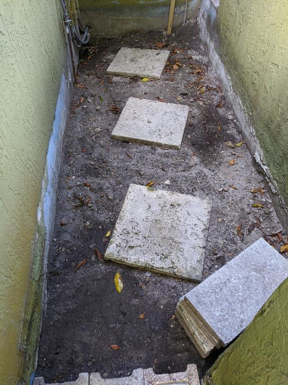

I have a landing area that is about 50SF, it will have occasional foot traffic but never vehicular traffic.
It is surrounded on all four sides with solid concrete borders. I have excavated it down to about 12" below where all I have is bare soil. It was covered with loose 20X20 step stones before, which I have removed with the intention to reset them better, level with a solid base, but to my surprise, what's underneath the step stones were broken chunks of concrete blocks, old tiles, broken pottery, soda cans, with a bunch of tree roots. I have since cleared all the junk away.
My intention is to fill the 12" depressed area back up to about 10" with sand. Then the remaining 2 inches will be filled with old reclaimed chicago bricks.

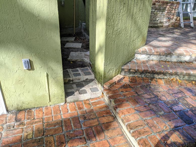

The reason I want to grout the joints is because the landing area is next to a driveway (500SF) and an existing deck (650SF) both have existing chicago bricks. Those bricks have been there for 30 years and they were set on a 2" mortar bed 1/2" mortar joints. This landing area is in between the two areas and it would look very odd if this area has no joint.
The other reason is because this area is currently bounded by concrete borders on all sides, the distance is fixed. To do this like pavers, not only will it look different from the existing areas, I will definitely end up with lots of odd pieces to cut along the edges. If I put in joints it will allow me to space them in such a way to avoid cutting the edge pieces.

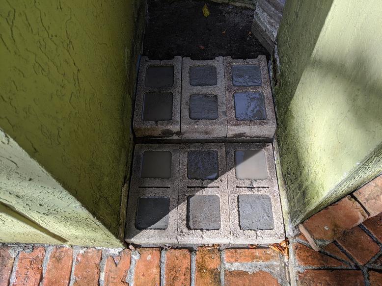

Here are some pictures of my project. As you can see, the existing areas have all old chicago bricks with mortar joints, so if I do it like pavers without joints it will look odd. The middle area stepping up is the small area about 12'x3.5' I am trying to do with bricks.
The steps you see are set with 4X16 blocks as the first step, then 8X16 blocks as the second step. I filled the voids with construction grout. My intention is the set bricks over these steps too.
I know it is better to do a mortar bed a few inches thick. However, I have copper water pipes and electrical conduits under this, and I don't want to permanently cover it. I would like to be able to break a few bricks to expose these pipes and conduits in the future, instead of having to take out a jackhammer. I know laying it like pavers, with almost no joints with polymeric sand filling in the gaps is the easiest but then it doesn't match what I have existing.
This is why I came up with grading the bed with dirt. gravel, sand, then lay down the bricks with joints, filling in the joints with mortar. But no idea if this will last.

another reason I just realized the standard jointless paver install will not work is these bricks are reclaimed and sometimes the size is slightly different. I have some pieces that are 8.5" long and some 8,25" and some in between. So it's necessary to be able to "cheat" with slight variation with mortar joints.
