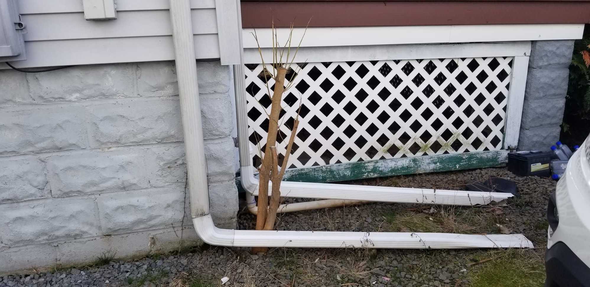

Thank you, I have glued the pipe but now I come to think of it.. I think the whole thing needs some re-routing,
I want to merge these 3 lines ( 2 from roof and 1 from sump pump and the merged line should go all the way to street.
What do you think? how do I merge that 90 degree roof leaders? Also, I tried to find some connectors but nothing for 3 lines. and what size the merge line be ? 3" or 4"?

There are no fittings to combine plumbing PVC and aluminum downspouts. There are fittings to convert the downspout to a 4" PVC. Then you could join them.
At my house I have a similar situation. I used adapters to go from the downspouts to 4" PVC for a trip underground. About 20 feet from the house I installed a in ground enclosure with a lid. These are used over irrigation valves, water meters... I just ran all the pipes in on one end of the box. Then on the outlet side I have one pipe making the run all the way to the forest where it exits to daylight. The box is a easy way to combine all the piping and the removeable lid makes it easy to clean the lines if they ever become clogged.

I will give it a shot.
This seems to be a common requirement.. I wonder why they dont have any 3/multiway connectors for this..
